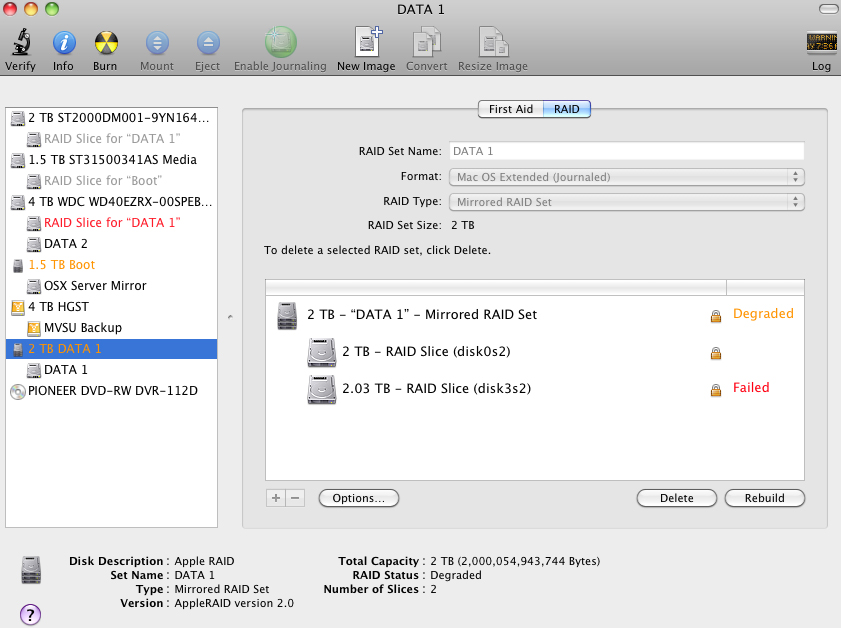

Issue 1:

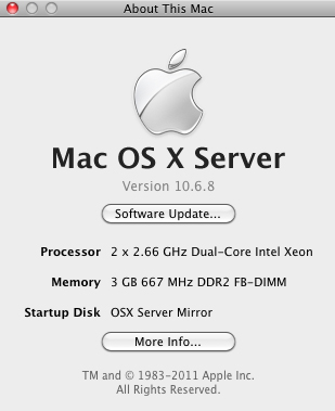

At my work we are running an OS X Server 10.6.8 which started making a constant noise yesterday (sounds like the fan) and is still going today. The whole office runs off the data stored on the server so I don't want to stuff anything up or lose any information. I am not sure why it is making the noise… does anyone know?? It hasn't done it before and nothing provoked it that we know of.
Issue 2:
The main problem…

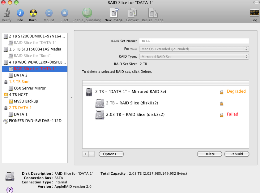

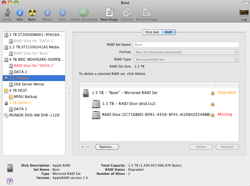

We have a RAID system set up, but it looks as though some of the drives have failed or are failing? In disk utility is shows one RAID slice as failed and others as missing…
Any light on this situation would be much appreciated!
A new OS X Server has been purchased, so we are looking at swapping over the system but have to figure out how to do so properly and not lose any data or stuff it all up!
It appears that you have a couple failed disks and a fan with some dust bunnies in it. That should be pretty easy to fix.
Back up all your data. If you can't shut down to replace the failed disks and clean it all out, then bring your replacement up that you purchased, and copy the data over to the new one while you clean and rebuild the original one. If you CAN shut down over a weekend or something, you could save a ton of money and hassle.
If you find a noisy fan, clean it or replace it. If you find a noisy disk, replace it. An old trick to pinpoint noise is to put a screwdriver to your ear and hold it against the part until you hear which one is making the noise... a poor man's stethoscope of sorts. Fans make noise when junk gets in them, or they get worn out. Disks make noise when they are failing, too... though usually it sounds more like clicking.
