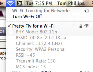

I have a suggestion... Hold down the option key and click on the wifi icon at the top right of your screen. Do that for each laptop and compare the two.

As xlii says, holding alt whilst you click on the WiFi symbol in the menu bar shows far more detailed information about the connection. Take a screenshot of each - the transmit rate is of particular interest.

Heres a screenshot of my settings...
