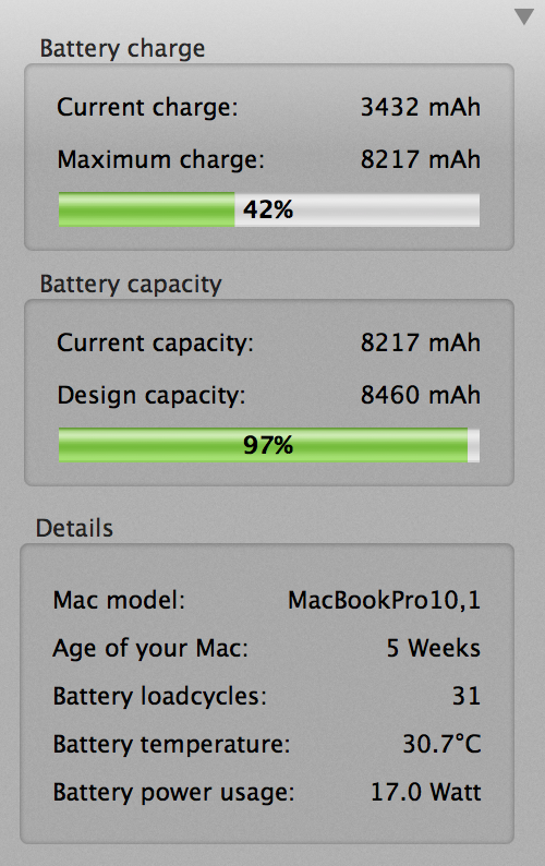

my rmbp is only 2 months old and coconut battery is already showing the health at 96% with 31 cycle
is this normal? i don't always keep it plug to the power source, i use the battery regularly. I caliberate it a few tims (running it down and charging it back up) and the health is still at 96%
i want to preserve the life of the battery for as long as possible as replacement is expensive but at the same time if my battery is faulty i should get it taken care of before the warranty expires
is this normal?
Yes. It is perfectly normal if your battery health (maximum capacity) is more or less than 100%, even when brand new, or if it fluctuates up or down over time. For further details, read the CHECKING STATUS AND HEALTH section of the following link.
Simply draining and recharging isn't calibration, but the built-in batteries in the newer Mac unibody notebooks come pre-calibrated and do not require regular calibration like the removable batteries in older Apple notebooks.

For what it's worth, I've noticed the health of mine goes down a bit if i drain it fast, by say, running a game while on battery.
mines gone from 96 to 93% after owning it 4 weeks. coconut says its 10 weeks old though and had 34 cycles 🙁

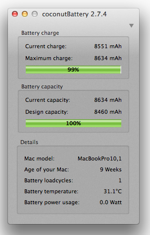

I don't understand all this battery business. A week ago my rMBP was on 6 cycles. This week it's on 7, yet I have had it plugged in when using it the whole week; if the MagSafe has popped out it's only been for a minute here or there.
It's possible that if you've been running intense activities such as gaming, your MBP has been draining the battery, even though it's plugged in. That could account for some cycles. Also, your MagSafe may not be securely connected.
