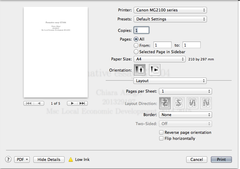

Yes, in the "Layout" section there is a separate selection box for "two sided printing". But as the OP pointed out, the selection is grayed out and cannot be used.

And as has been said, the two-sided box is grayed out...
