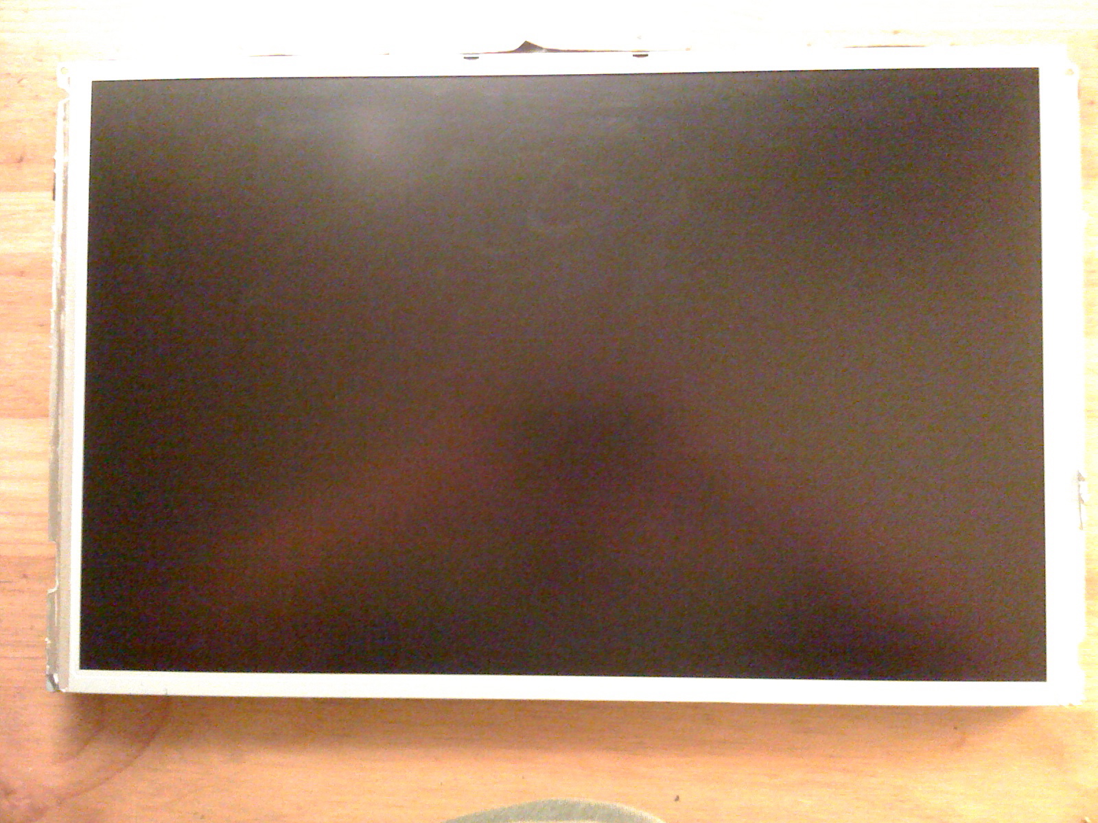

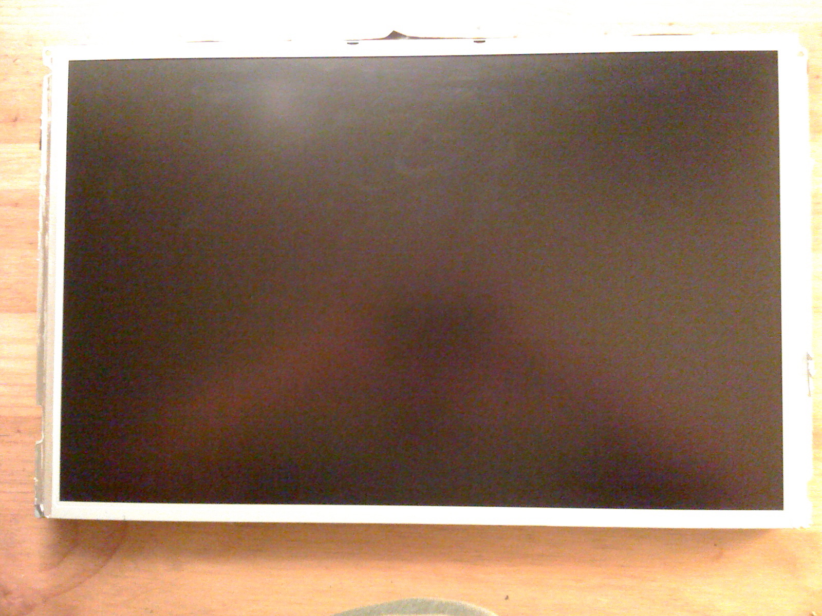

Right,

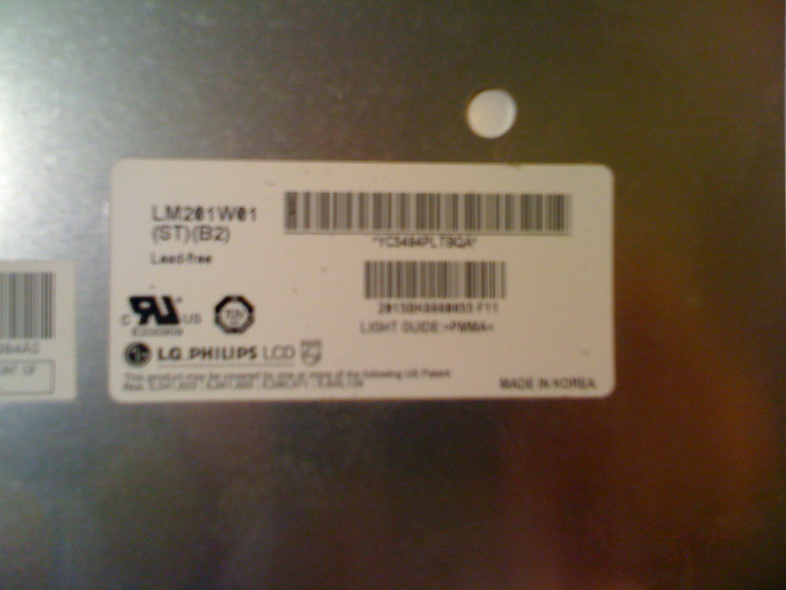

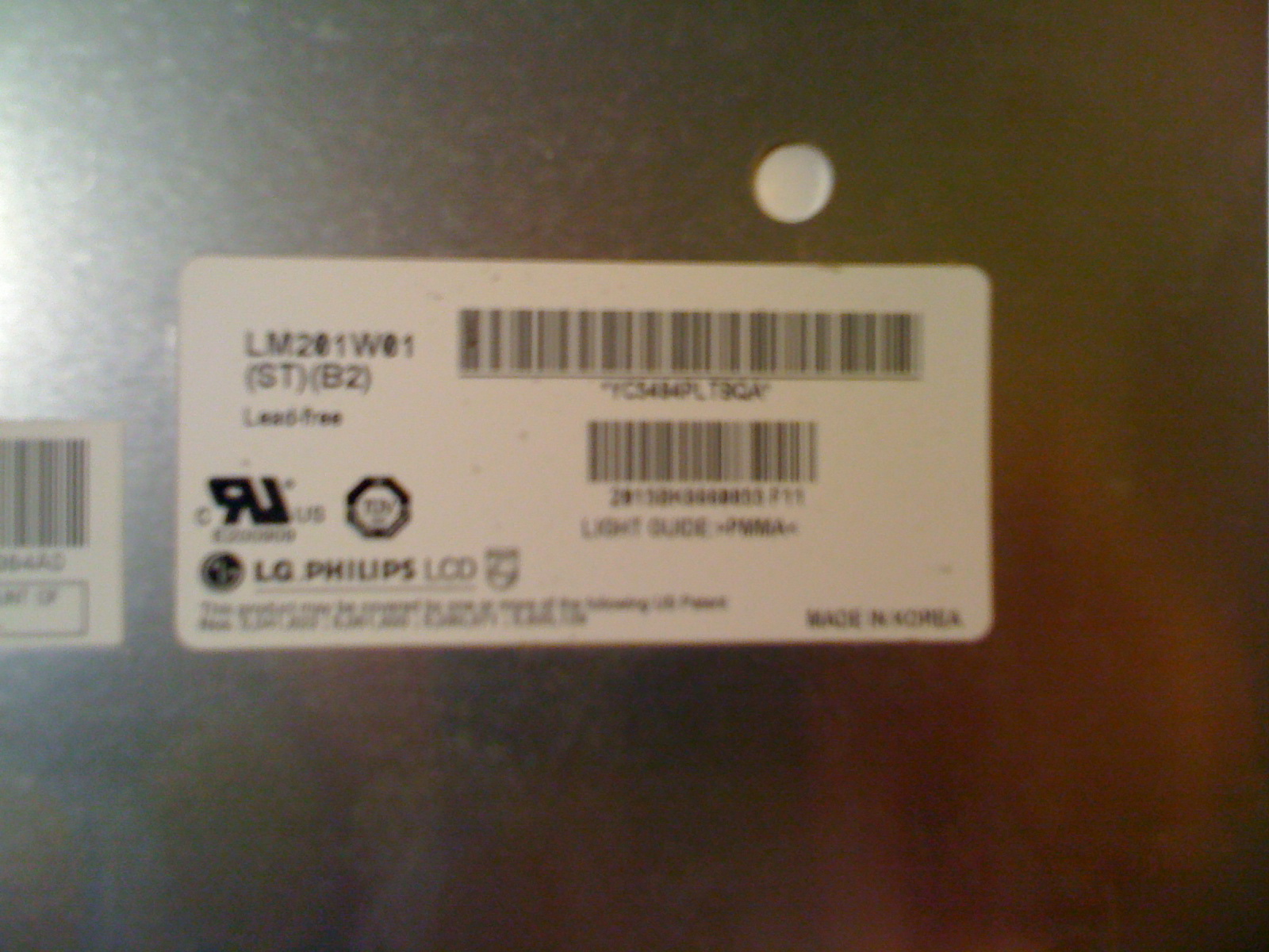

Cinema Screen Dismantled and now have the Part No.
Its LM201W01 ST B2
LG Philips Screen.
Looks like all i need now is to find one!!!
possibly use a donor monitor that uses the same screen. will be hunting if anyone has any ideas?
I found one of that part number listed on eBay as an iMac G5 20" replacement LCD. This seems to be the best bet to find a replacement for a decent price.
http://cgi.ebay.com/LM201W01-ST-B2-...emQQptZLH_DefaultDomain_0?hash=item3efbeb8884
After some further searching this seems to be the screen used in the iMac G5 2.1Ghz. The Apple part number is [FONT=arial, helvetica]661-3779.

LG Philips part # LM201W01 (ST)(B2), Apple part # 661-3779
So this does seem to be the correct part number. There are likely a number of other panels that fit saving you more money like on Macbooks if all you care about is the housing and not the color accuracy.

Wait a second... when you finally get to just the LCD, it should have only a small pink and white connector that goes into the inverter, and a slot on the back for providing the LCD with power. Do you still have parts to remove? The LCD should be quite generic and not ACD specific.
certainly, there is only one connector that connects the main board to the LCD Panel. i have now removed all components and am just left with the LCD panel.
