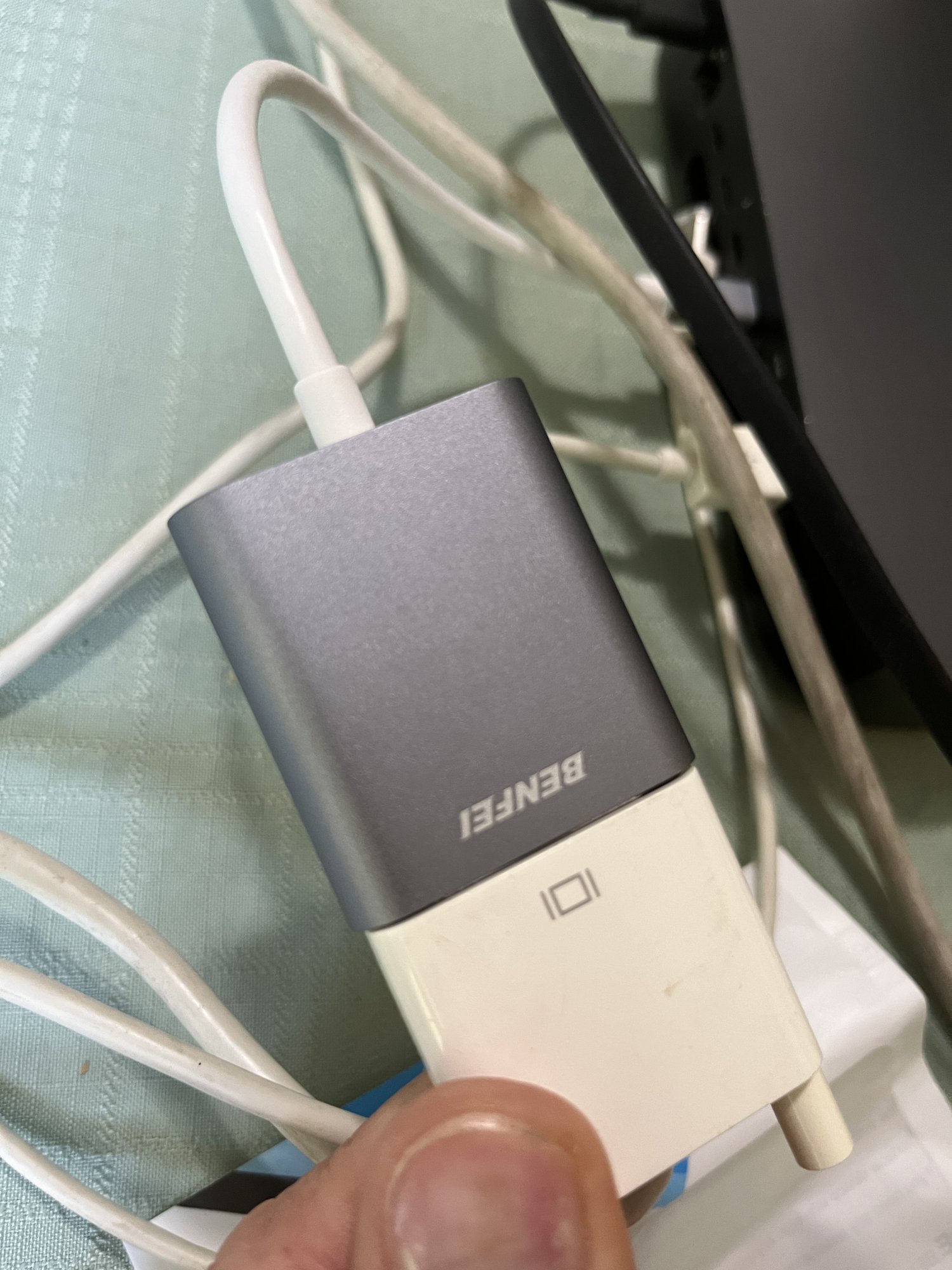

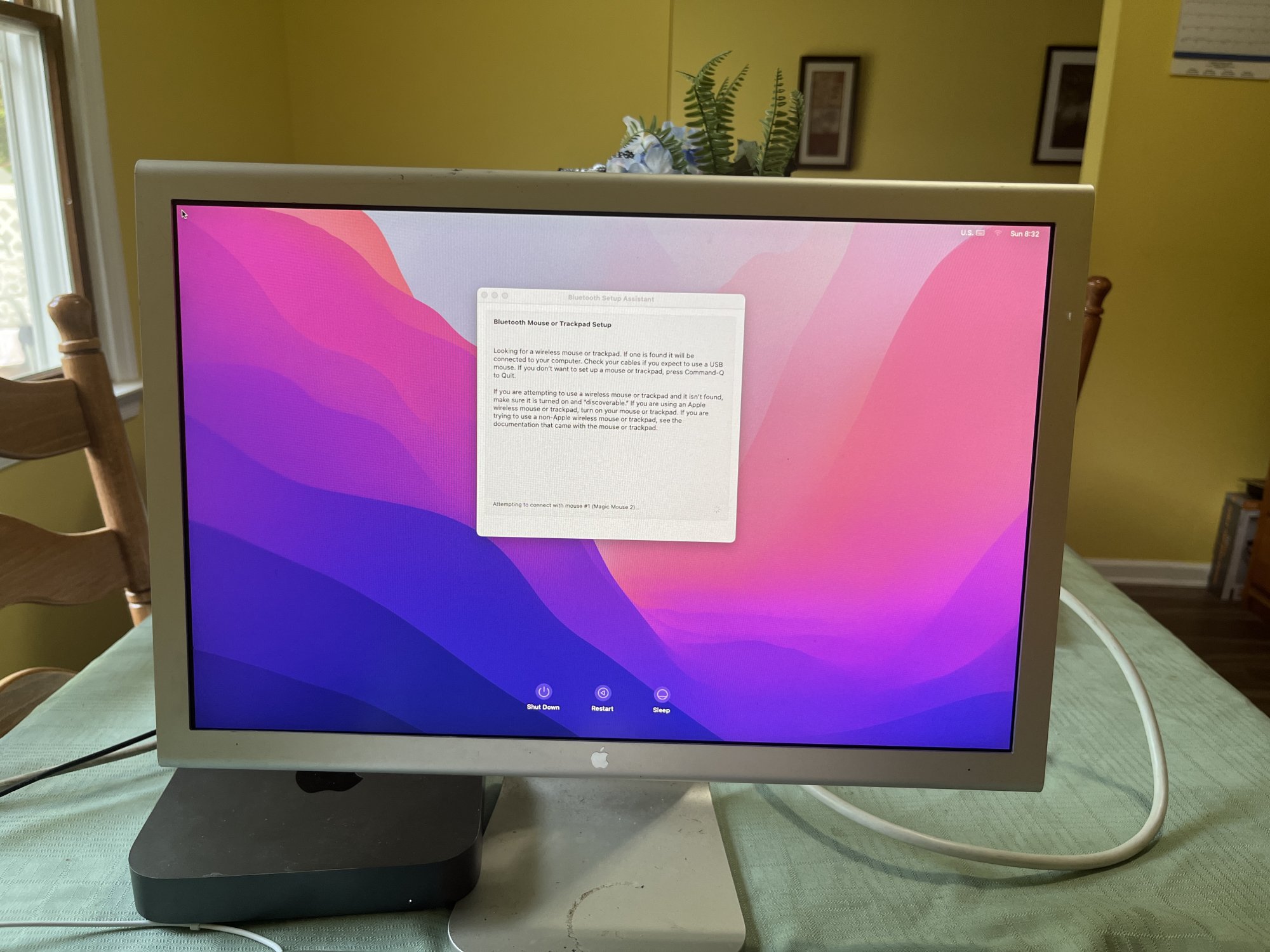

Update: Solution found
Ended up trying a allegedly Mac compatible USB C to DVI Single Link Adapter from Amazon that cost me $10.99 w Prime shipping
Adapter is the Benfei B_164grey (B0768RFQ83)
