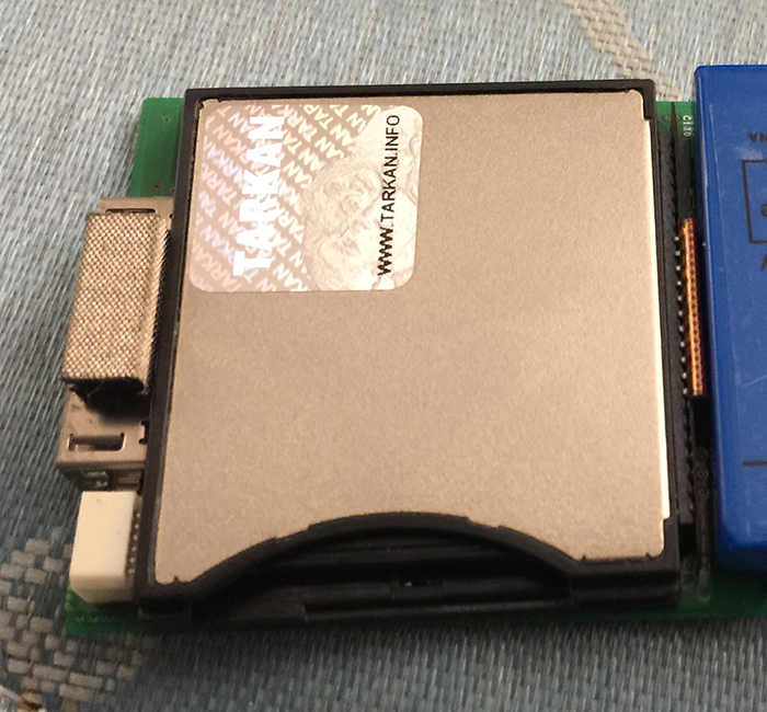

Well some people have reported that the 2000 battery with the iFlash CF + CF-to-SD board don't fit. I have the 2000 battery with the mSATA board and it barely fits.
If I were you and really wanted the big battery I would purchase an extra CF-to-SD adapter and then remove the top cover and try to shave off some thickness from it. You would probably need to tape up the SD card to secure it somehow.

Ok, we understand that you are using a 5.5g 80gb, thick back plate model.
There is a 1900mah battery that sells on ebay, I will get the link for it in a
moment here, but as the other poster had mentioned, that it might not fit
with the adapter you are using. Do you have a pic that you can post of
the adapter with sd card mounted to it. When you say iFlash, are you
referring to a tarken adapter board ? If so, I have one of those adapters
with a thick back plate and also the battery, I will check to see if it will
possibly fit this 1900mah battery, which I have one of:

Yeah man, like I told the op only way to fit a big battery is to slim down (modify) the SD adapter or find a slimmer one that would work.
