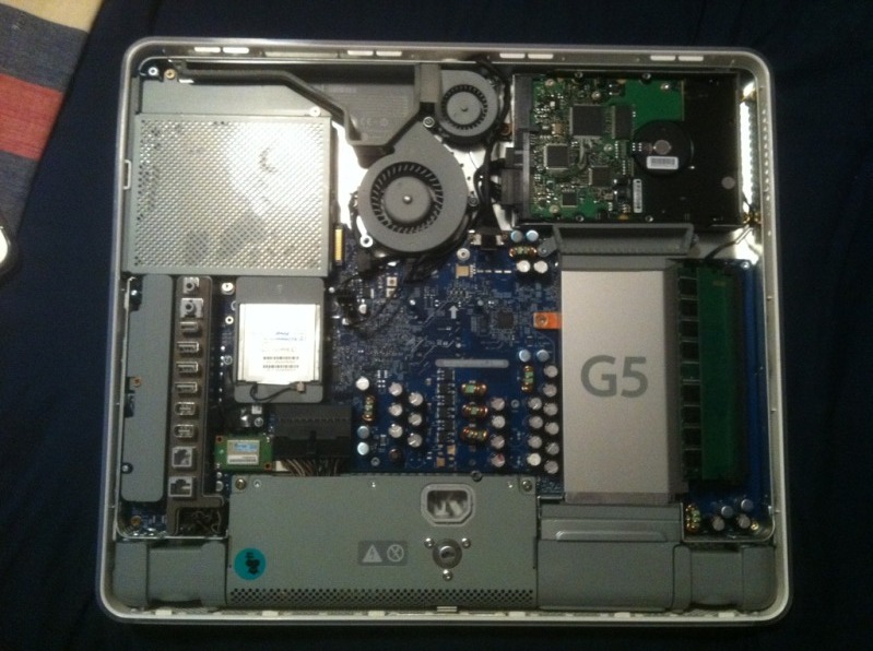

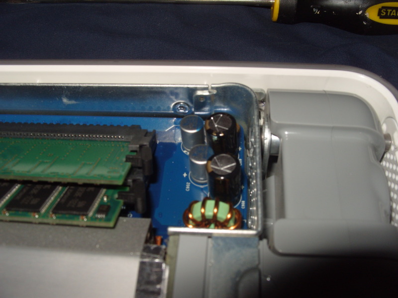

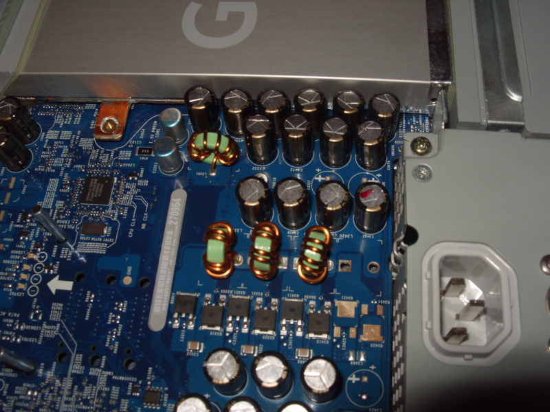

It seems like I purchased an iMac with faulty capacitors. Yet, upon looking at the inside of the G5 after I unboxed it, the capacitors look to be in fantastic shape, and it doesn't even seem like they're faulty. I've searched this forum for solutions to the issue, and I reset the SMU button and even tried the unplug power cord/wait 10 seconds/plug in power cord while pressing power button, but to no avail, the problem didn't go away.

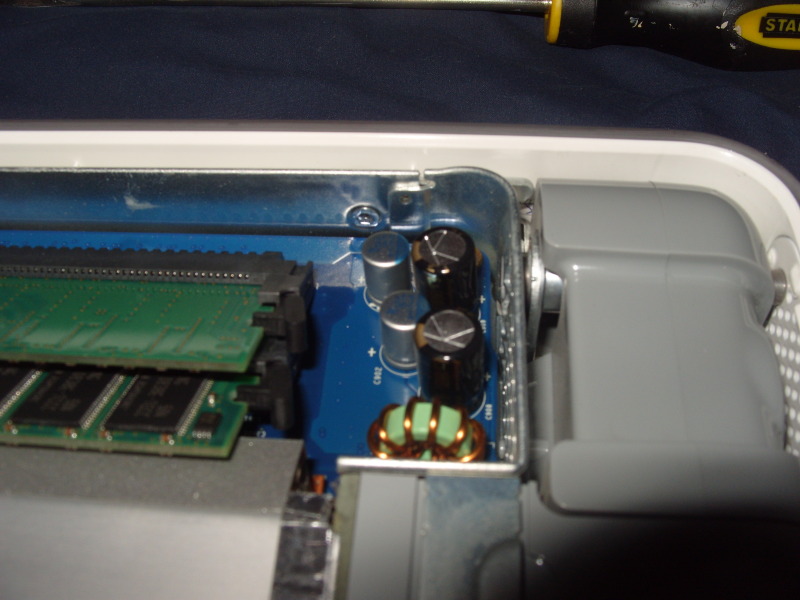

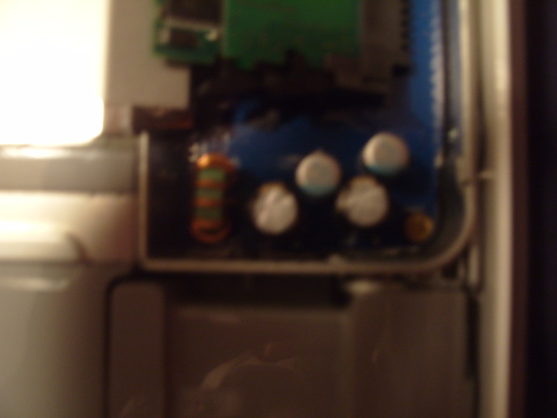

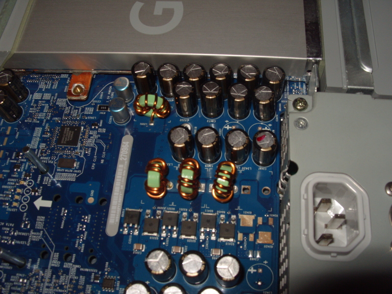

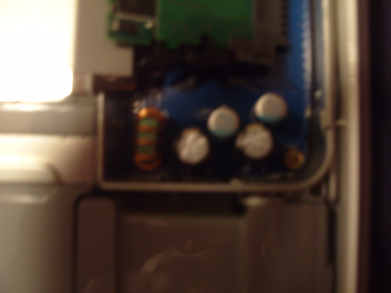

Here are pictures of the capacitors. Do they look like they're bad or going bad? Maybe the problem with them is as obvious as the others.

I've serviced dozens of iMac G5 computers at work, and they are almost always failing these days due to bad PSU's and caps. Even caps that look good can still be failing. First off I would consider replacing the PSU. Its pretty cheap, and I would bet if its never been replaced, its about due.

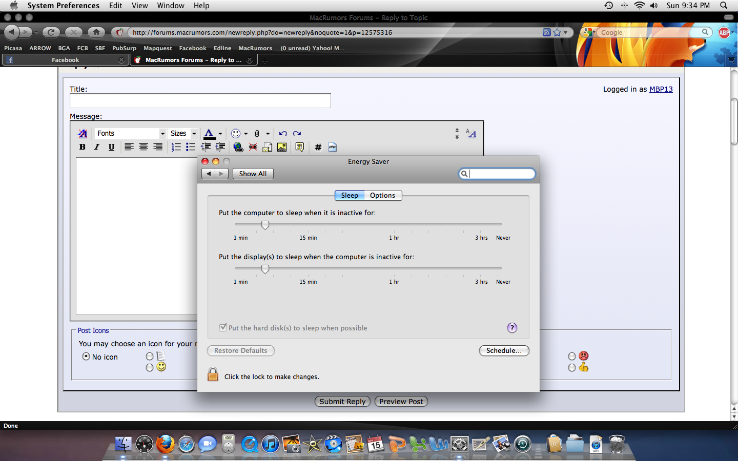

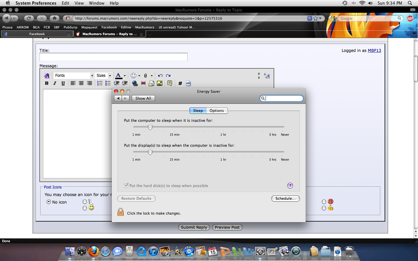

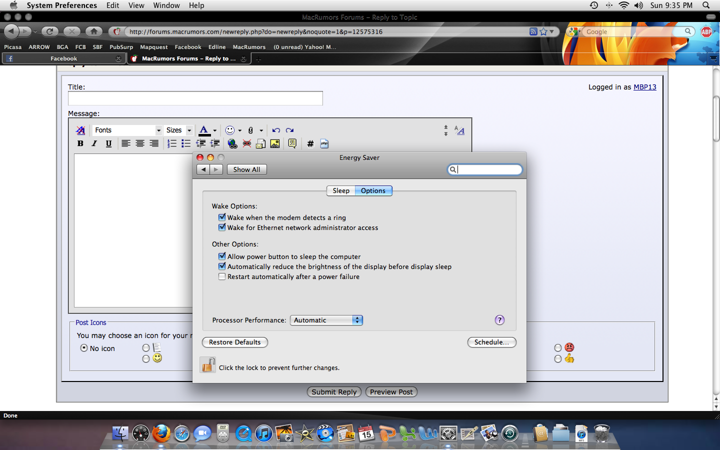

This only happens when I put the iMac to sleep, not by itself. However, I don't know how to set the iMac to go to sleep by itself, but I can only figure out how to let the LCD sleep, but not the internal components. How do I set the whole iMac to sleep by itself?
Go to system preferences -> Energy Saver, and there is the sleep setting, "Put the computer to sleep when it is inactive for:". There is a slider bar that you can adjust. And you can also schedule the times that you want your iMac to sleep, shutdown, restart, wake or startup thru clicking schedule.

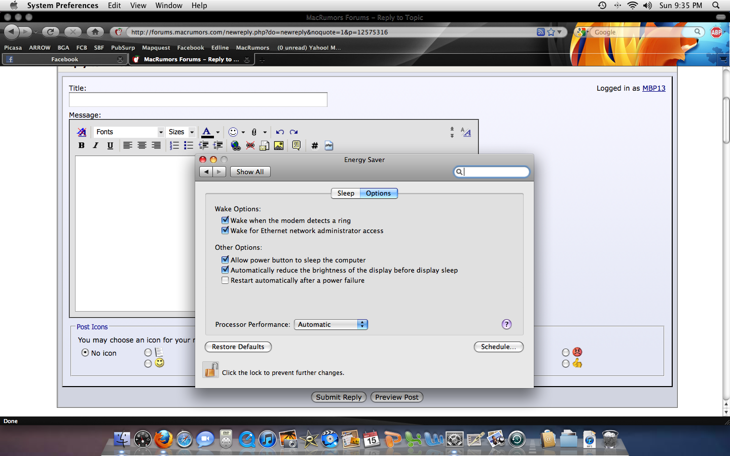

^I tried that, and even when the iMac goes to sleep, it's not "sleeping". The little white light front of the iMac isn't blinking, and isn't supposed to be blinking when it's asleep?
