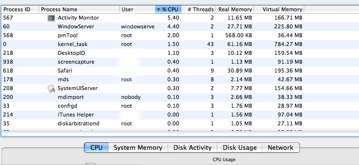

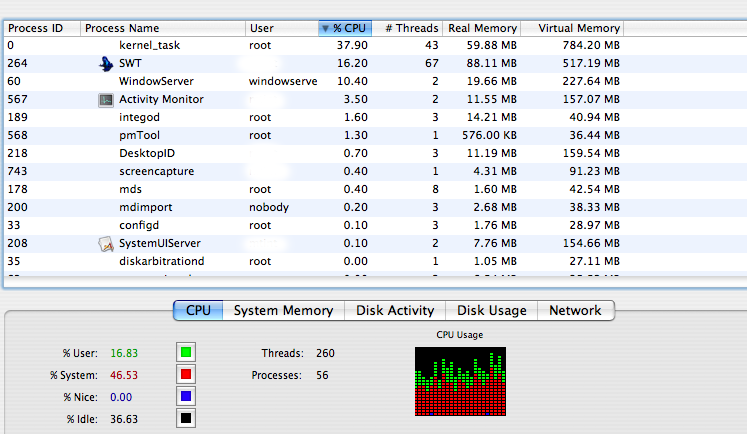

I was getting the same with my PB only when running Azureus, See Picture 1 and when not running kernel_task CUP usage is low.
I have had my PB crashing from this and had to press shutdown button to getout.
Azureus 2.3.x.x.
Rgds,
SC
Azureus 2.3.x.x.
Rgds,
SC
have you got java 1.5 for the new azureus?
i eventually dropped azureus 2.3 for bits of wheels (again) since that is now tiger compliant. works fine now :)
however i'm still having problems with my G4 1.5 PowerBook after 3 iinstalls (last was upgrade from a clean 10.3), though mine isn't a kernel_task, it's still very laggy....takes forever to start up and and show all the menu bar items, and hard drive sounds like it's always trying to access something (i've let spotlight re-index), so i may just turn off spotlight and see how that goes.
not happy jan...! :(
yes, I have Java 1.5 installed and set this is my current release:
[/Users/sc] -> java -version
java version "1.5.0_02"
Java(TM) 2 Runtime Environment, Standard Edition (build 1.5.0_02-56)
Java HotSpot(TM) Client VM (build 1.5.0_02-36, mixed mode, sharing)
[/Users/sc] ->
note: I am experiencing this whendownloading and bandwidth is high, same is now happening with limewire. I only have 1 Mb line.
sc
