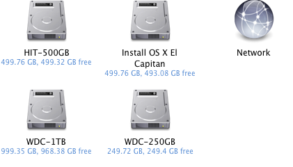

Aloha to All; I hope all is well for everyone. i'm seeking expertise in upgrading my Mac Pro 2.1 to run El Cap. I followed the pikify3.1 instructions and managed to get the os installer in a second drive in my mac but when I try to reboot to it, by pressing the options key after restart, the screen stays black. My lion 10.7 boot disk doesn't even show. These are my specs:
Hardware Overview: Model Name:Mac Pro, Model Identifier:MacPro2,1, Processor Name:Quad-Core Intel Xeon, Processor Speed:2.66 GHz, Number of Processors:2, Total Number of Cores:8, L2 Cache (per Processor):8MB, Memory:16GB, Bus Speed:1.33 GHz, Boot ROM Version:MP21.007F.B06, Chipset Model:ATI Radeon HD 6xxx,
VRAM (Total):2048 MB. I go to the HD were I installed the pikify 3.1 folder and can see the OS installer, but my computer does nothing when I reboot. It does not even boot to the main drive where the Lion os is. I have attached a screen shot of my drives. Thank You Very Much in Advance for any expert help and suggestion you can provide me that will help me finish the install.
Is your graphics card a generic PC Card?
If so have you tried to flash it with the EFI addition?
Has it ever shown the boot screens?
Have you tried a DVI-to-VGA adaptor, cable to the VGA port on your monitor (or find an old monitor)
