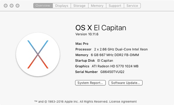

I removed all of my memory from my Mac Pro 1,1 (El Capitan 10.11.6), except 2 x 2 GB DIMMS located in the upper riser card. After a restart, I loaded a few Safari web pages and waited for the inevitable... The Mac Pro crashed then restarted, similarly as you reported earlier. I then shut down the Mac Pro and installed 2 x 1 GB DIMMS into the lower riser card (6 GB total memory, see attached jpg) and restarted... The Mac Pro is stable for now after a few minutes of operation. I would speculate that you need additional memory in your Mac Pro. I would suggest as a minimum that you add another 4 GB and you should be fine.
As for a downgrade to Yosemite... My understanding is that the boot.efi v3.1 will work fine with Yosemite.
Thanks for the tip I will order some more memory and see what happens.
