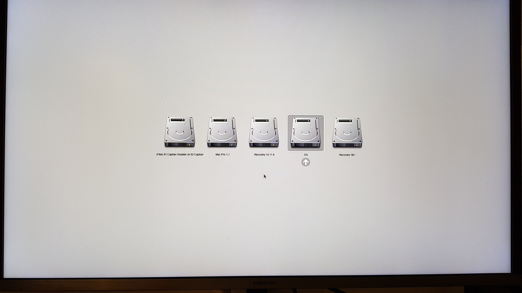

Hi all, nearly driving my self insane with this. I can get as far as this. I have tried various methods.
I have flashed a 2006 to 2,1 all good. I have set time to 1/1/2018. I have tried the Pikefy App and also the terminal method to create a boot disk install as in the picuture. However that is as far as I can get.
It will list the boot drives but when I select them or the recovery nothing happens. I have 12GB of Ram a bit mixed Slot a 1,1,2,2gb slot b 1,1,2,2 they look ok and I am not getting any errors.
When I tried I did not get a boot screen I have to hold down the Alt key to select.
i have a Nvidia geforce 7300 gt and no need to up date the driver
I have looked for a solution to no luck. Any ideas or suggestions gratefully accepted.
Happy to read suggestions if I have missed something on a thread that I may have missed.

I was only able to get it to work when I set the date back to 2016. I'm not sure that video card will work. If that's the original video card, it won't work. There are people here that know much more about the video requirements than me.

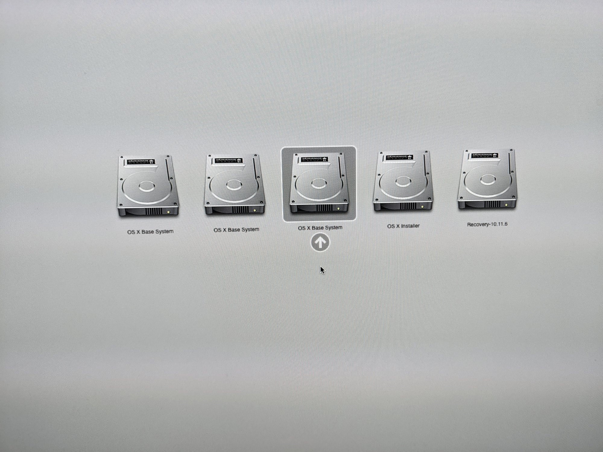

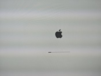

Hi all!
Before yeasterday I had a MP 2,1 with El Capitan. This one was flashed by Pikify a couple years ago and all was great.
However I decided to reinstall the System from the start and reflashed by Pikify v14.
Now my MP stucks on booting.
I'm able to go to the Recovery but when I'm restoring the OS, there is no chance to go to the end.
I need help!

It looks like the installer has not fully completed. From your second image, you can see a partition named “OS X Installer”. Move the boot selector to the right, boot using that “OS X Installer” partition...
