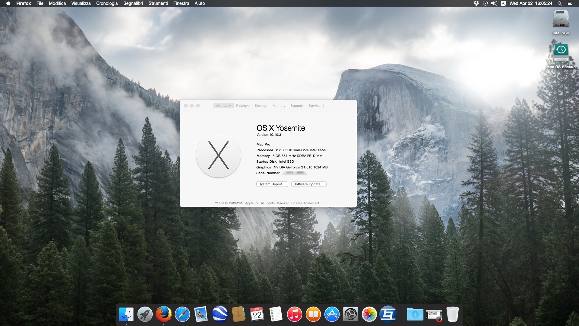

Hello to the community, i just want to thank all the people that made this upgrade on my old but still usable Mac Pro 2.1 possible. I've strictly followed mikehennessie's (which i immensely thank) pdf and it worked at first attempt, the installer was a 10.10.2. My machine has an Intel SSD and Yosemite runs pretty fast on it...
Well, that's all for now, all the best to everybody.
