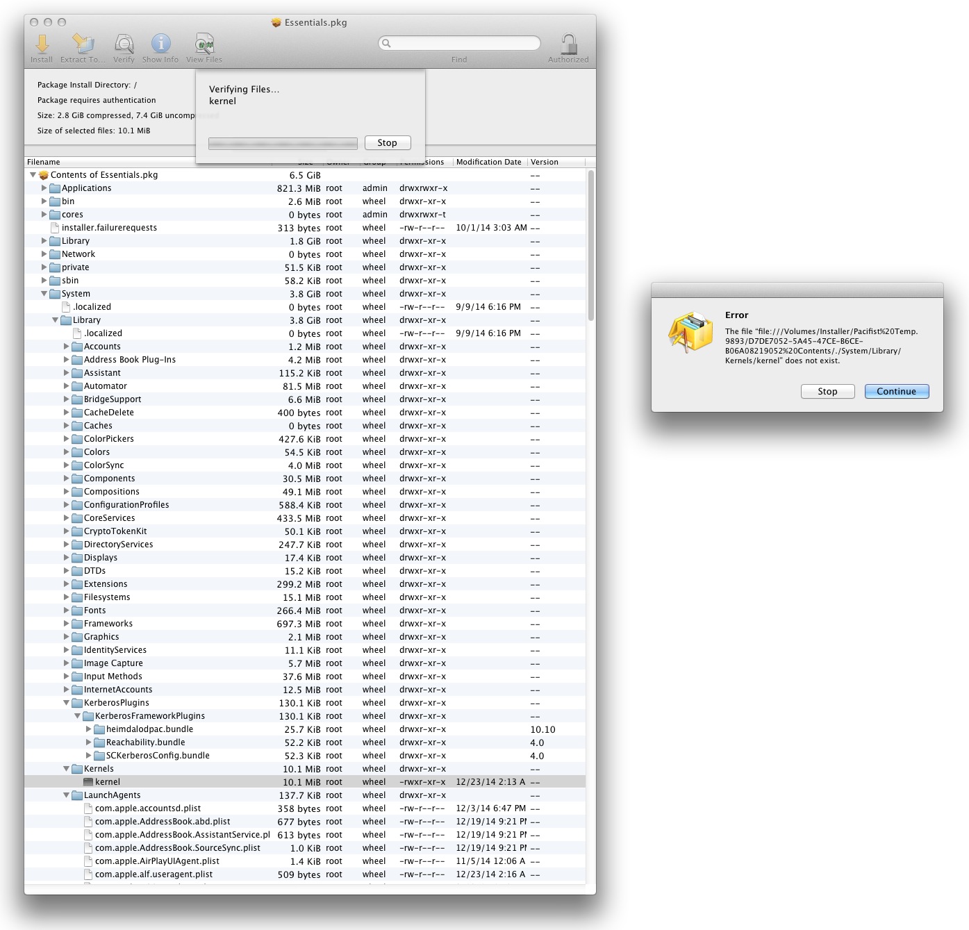

Kernel Extraction Error
I'm trying to create a bootable installation USB drive using MacRumors member Hennessie2000's Yosemite Install Guide - boot.efi method, but I keep getting the following error message when trying to extract the kernel from the Essential.pkg file, using Pacifist.
The file “file:///Volumes/Installer/Pacifist%20Temp.9893/D7DE7052-5A45-47CE-B6CE-B06A08219052%20Contents/./System/Library/Kernels/kernel” does not exist.
Any ideas? Thanks.

Try extracting the whole folder. Or, a few pages back or so I posted the kernel file.
Thanks for your help, Hennessie2000. If I extract the entire Essentials.pkg file, where should I extract it to? And once I extract it, can I then just copy the kernel to the required location on the USB drive?
I did see the February post where you said you would later post the kernel file, but I couldn't find that post on this forum. Do you happen to have that post number?

Not all that, just the Kernels folder
https://copy.com/UhlWrUCDGZilVttN
Thanks, Hennessie2000. I saved the revised kernel from the link you provided and was able to copy it to the properly designated folder. Later today, I will try to install Yosemite from the completed USB installation drive.
One other note: Under Step 17 of your Yosemite Install Guide, I made two additional edits to the PlatformSupport.plist (in the System/Library/CoreServices folder). I typed in MacPro1,1 and MacPro2,1 (on separate lines) at the end of the supported machines list, using the given syntax format. Not sure if this is necessary, but it made sense to me to include these machines in the list.

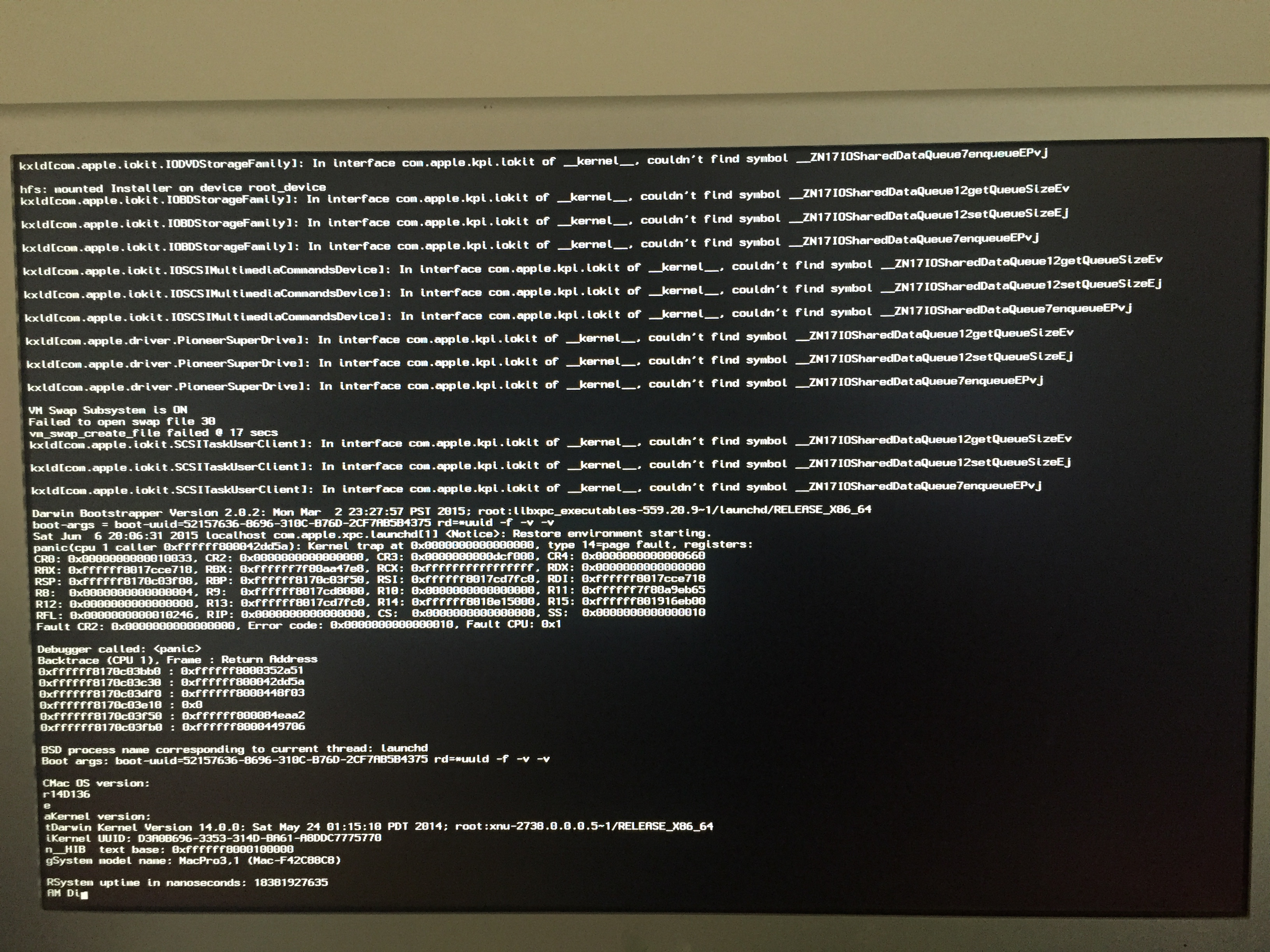

I have a Mac Pro 1,1 (4GB RAM, NVIDIA GeForce GT 120 from MacVidCard) that I am trying to upgrade from Lion 10.7.5 to Yosemite 10.10.3.
I have attempted 3 upgrade methods:
  • Clean Install of a Yosemite to an external drive from a MacMini and swapped in Pike's boot.efi. This initially crashed on the white Apple on black background screen. Reboots resulted in a flashing question mark folder.
  • The SFOTT method run from the MacPro. This gave me a white Apple on black with a verbose mode startup ending in a kernel panic. I saw that the last loaded kext was related to RAID. I pulled the two mirrored RAID drives leaving a SSD for the system. Repeated restarts resulted in a kernel panic with com.apple.driver.AppleUSBHIDMouse being the last loaded kext.
  • Finally I tried the pre-built Yosemite installer from Hennesie2000, and ended up with the same repeated crash on loading the AppleUSBHIDMouse.
Any suggestions? I know that kernel crashes can be very difficult to diagnose

Hi,
I'm getting the system uptime in nanoseconds error. Can someone please help me fix this issue?
I've attached a screenshot of the error I'm getting. I've tried using the Chamelon method and the sfott method and get the same issue.
Use the PikeYoseFix script for Yosemite.
Is the PikeYose script the same as the Tiamo script but with the new boot.efi file? if not, what are the differences? I am clonning my Maverick disk, which has the tiamo script before attempting the upgrade to Yosemite. Thank you.
