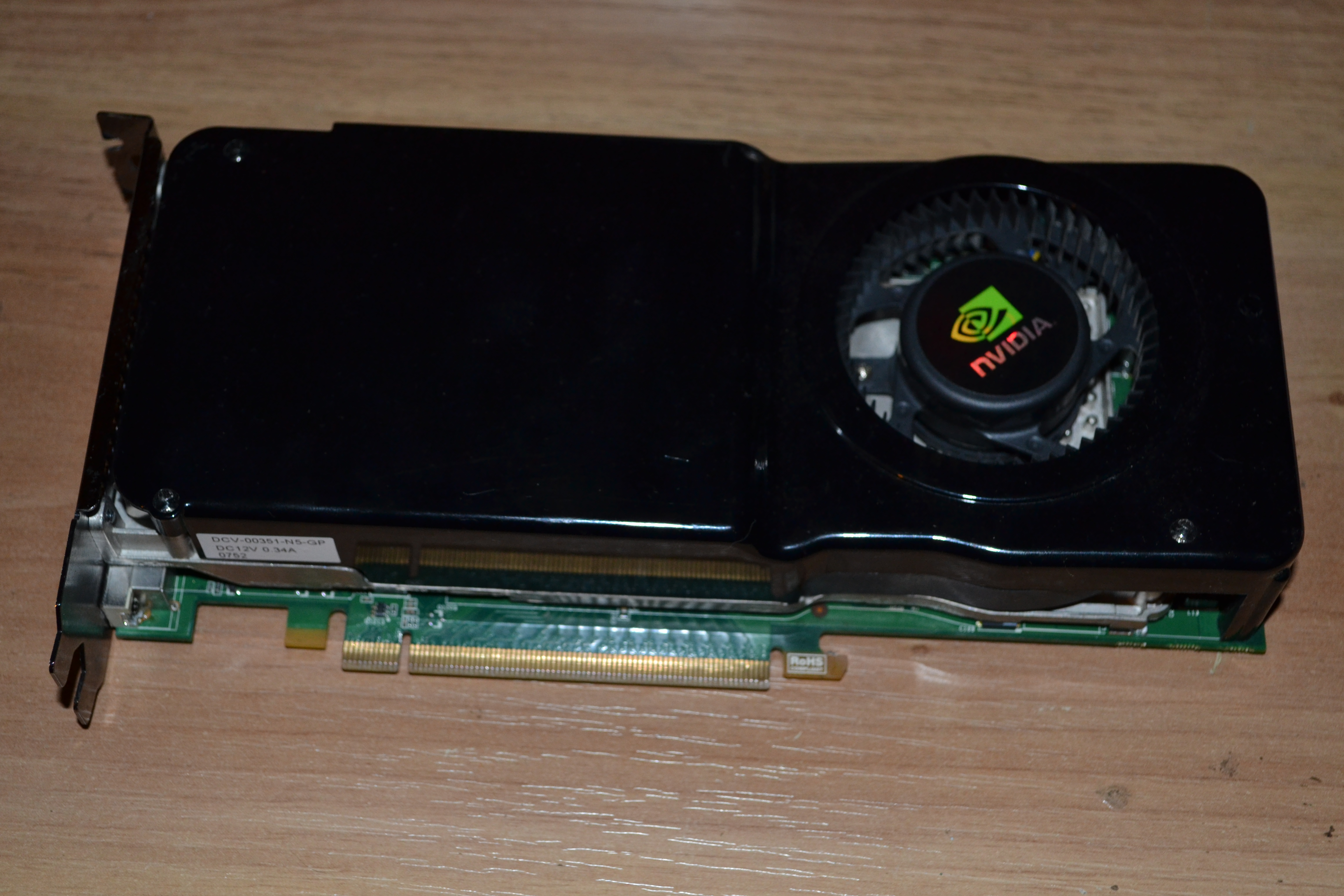

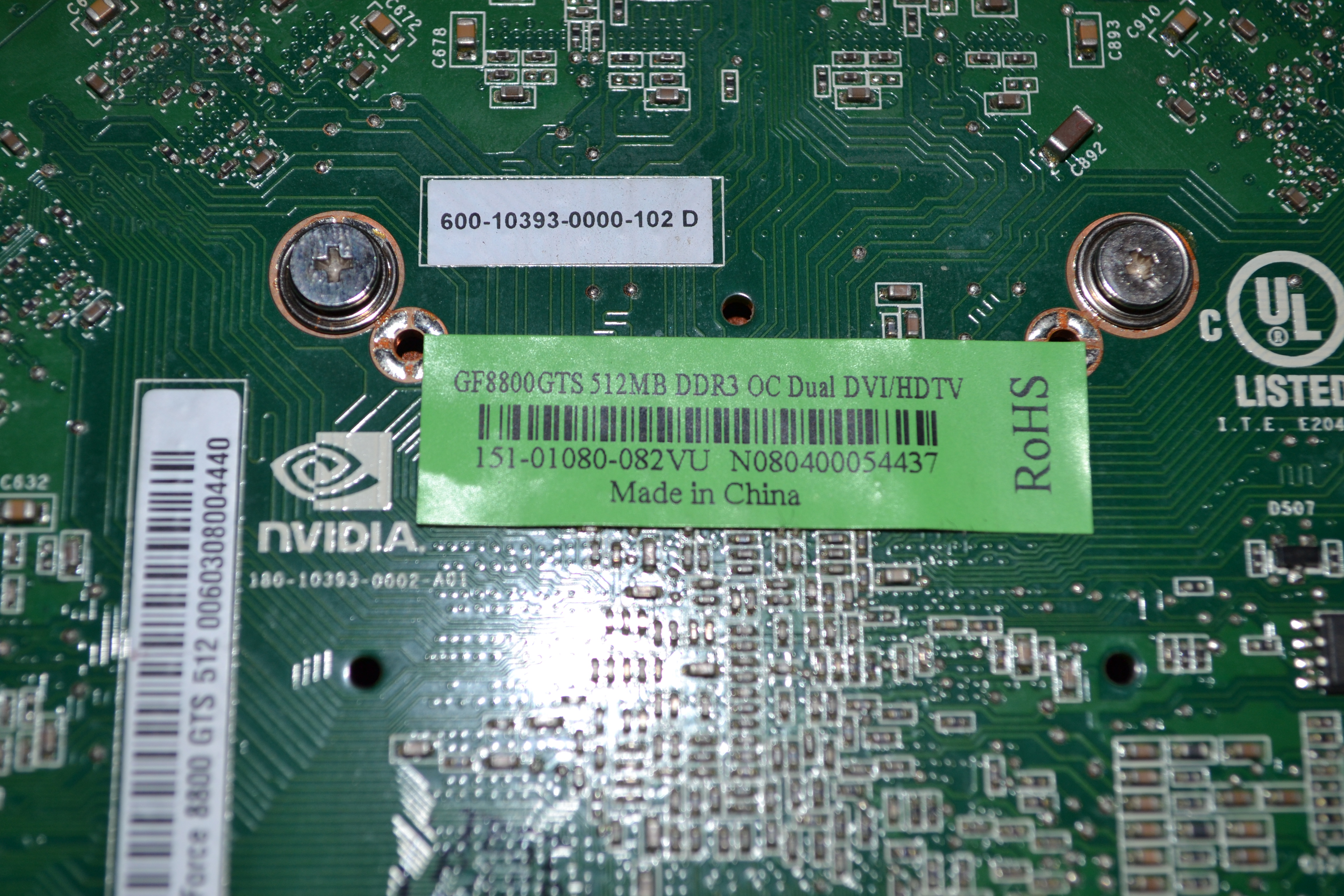

That doesn't look good - Is this happening under all versions of the OS?
Have you tried reseating the graphic card or removing and blasting it with compressed air? My guess would be that is graphic card related but I am sure others here will be able to advise. Have you checked monitor and leads are OK?
I dont know how is the procedure reseting a videocard, it was taking off, but it's clean, it not nesessery to clean up, not
dirty :)
I don't know which card it is exactly but if it is a genuine Apple 8800GT it could be faulty. They were not well made.
Can you connect the monitor to another computer with a different cable to check it isn't the monitor or cable. Or connect the Mac to another monitor to try to eliminate causes.
Have you reinstalled the pre-patched Yosemite yet? You said it was working before upgrading to 10.10.5 so worth trying. The screen flash and failure to install may not be the same problem.
