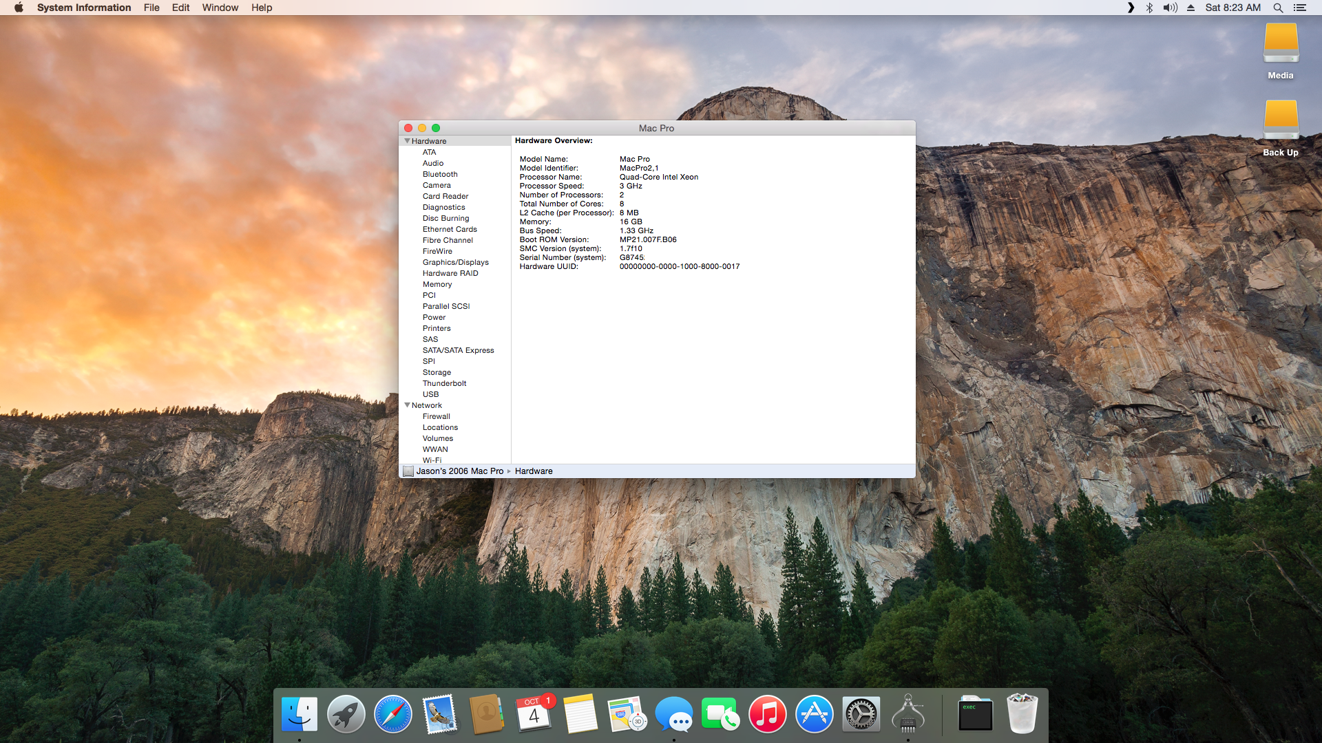

Success!!
I have it up and running as well.
I just booted into my Mavericks partition
Then I ran "chflags -R nouchg boot.efi" while being in the CoreServices Directory to unlock it.
After that, I replaced the boot.efi that was made in the CoreServices and the i386 folder and it booted.
This was on a Fresh GM Candidate install.
I actually used Clover to install it on the Mac Pro.
iMessage also works since I had already called for the Customer Code awhile back for my Mavericks install. Since this is the same computer now, not an injected form of it with Clover, it logged right in.
Screenshot posted. I edited my Serial and the UUID to protect the innocent :)

I only used Clover to install Yosemite via the method that is listed earlier in this thread.
After install I reset the PRAM (Command + Option + P + R) to boot directly into my Mavericks partition which overrides Clover.
After install is when I changed the boot.efi from my Mavericks partition and then I selected the 10.10 Start Up disk in System Preferences.
It booted up like normal without the use of Clover, just with the modified boot.efi.
