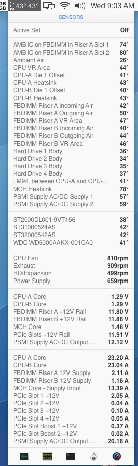

iStat Menu report
hey guys,
I didn't quite know where to put this so as I'm running Yosemite on my 1,1 this thread felt like an ideal place ;)
Here's a report from iStat Menu (I'm not doing anything intensive right now, just reading mail and safari). As I read in another thread about amps and voltage stats, looking at mine got me wondering. I know all our machines run differently and that a 1,1 will mostly consume more power than a more recent model etc. Having said that, what do you guys make of these numbers? Should I be worried? (I should mention that my mac runs flawlessly and perfectly, I'm just a little obsessed with iStat in general ;))
