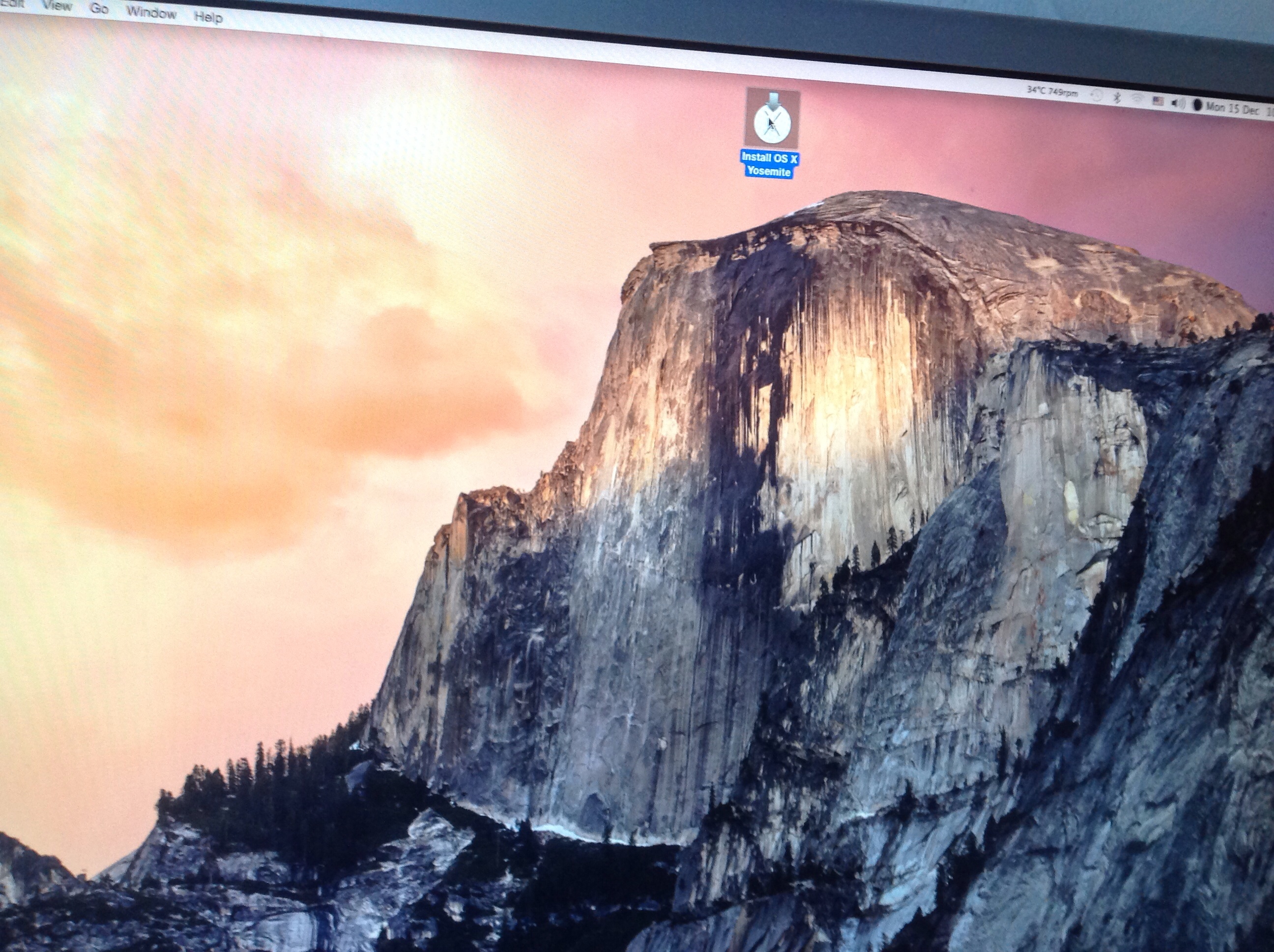

OK. So I followed your advice, created a seagate external bootable drive with latest Yosemite (downloaded just yesterday from app store) and latest SFOTT utility, and firewire connection. Everything worked fine and I have now Yosemite installed over Lion. Everything works, but I lost parallel, lil snitch and flipformac, perhaps I lost other things, I will check later.
Thanks to everyone who made this happen, and long life to our beloved Mac Pro 1,1, the best computer in the history of puters.
Here is a pic of the lil baby, what a cutie, born with ACS, acute cuteness syndrome :)
