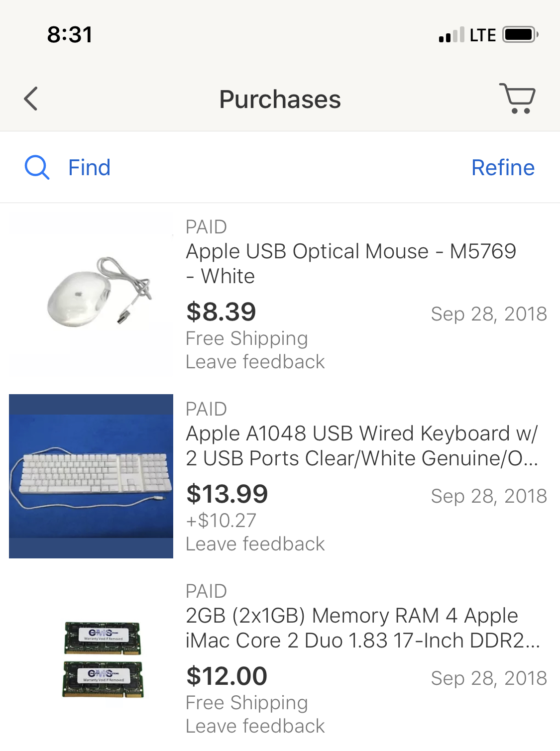

Alright, I just purchased an Apple keyboard and 2GB of RAM for the computer. I also got an old Apple mouse just for the nostalgic factor. Hopefully this works, thanks for the help. I’ll report back if it does

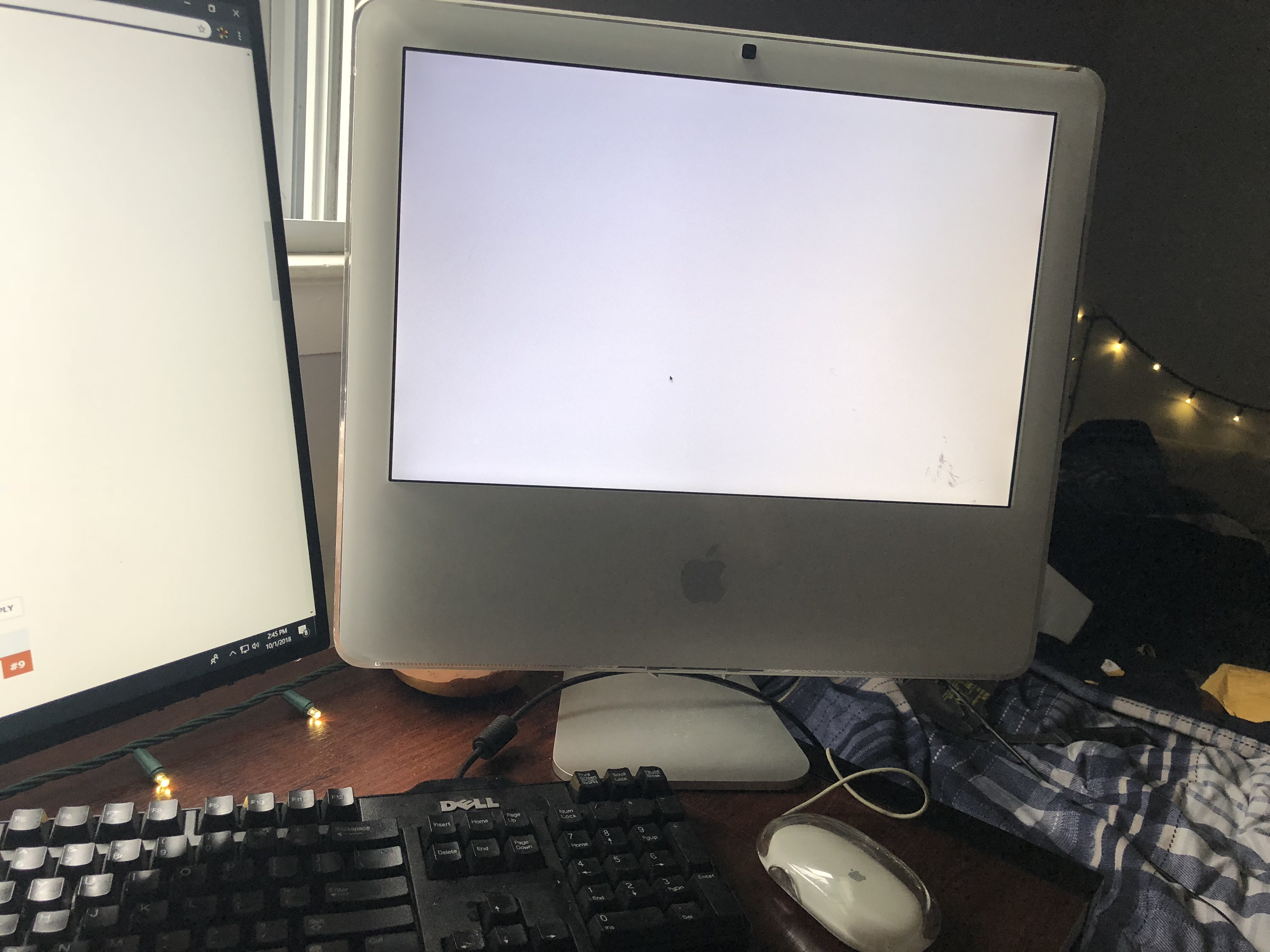

Hm, so very odd thing happening. So, the mouse and RAM came today but not the keyboard. I put both sticks of RAM into the computer and plugged in a new keyboard (still a Windows keyboard though) and turned it on while holding down what would be "option" (windows key equivalent, of course). I didn't even do a PRAM reset yet, and oddly enough the firmware password seems to be gone...? Instead of showing the firmware password screen, I get nothing but a mouse.
I think this is good? The HDD is empty, anyway, so I'm assuming the password is gone? I don't know, but I'm going to make an attempt to install Snow Leopard and get back to you guys with a result.

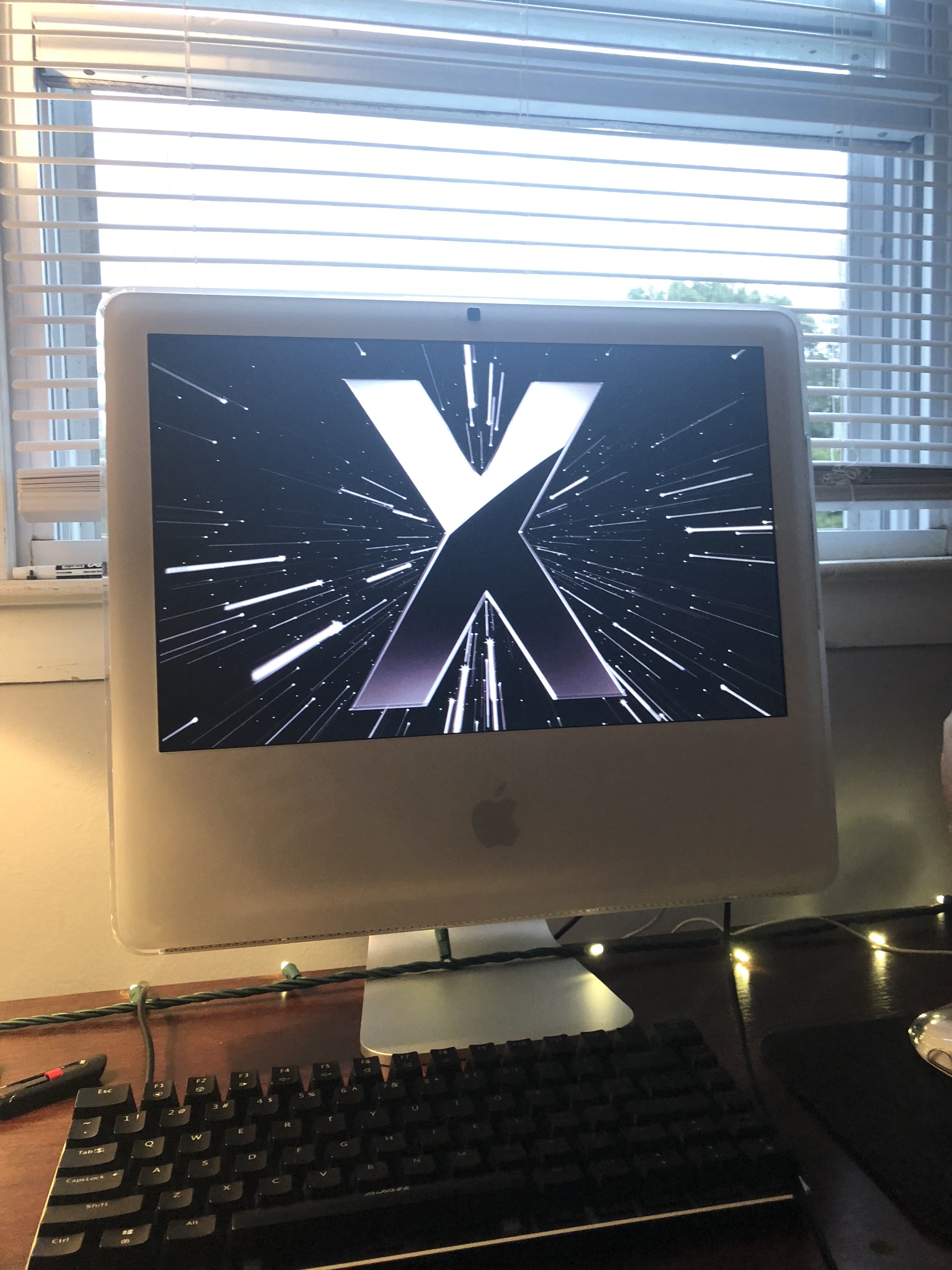

Update: I was able to install Snow Leopard 10.6 without even doing a PRAM reset! The firmware password went away on its own, which is kinda odd. Thanks everyone!
