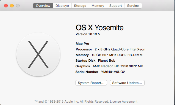

Just upgraded mine this morning, been running great all day.

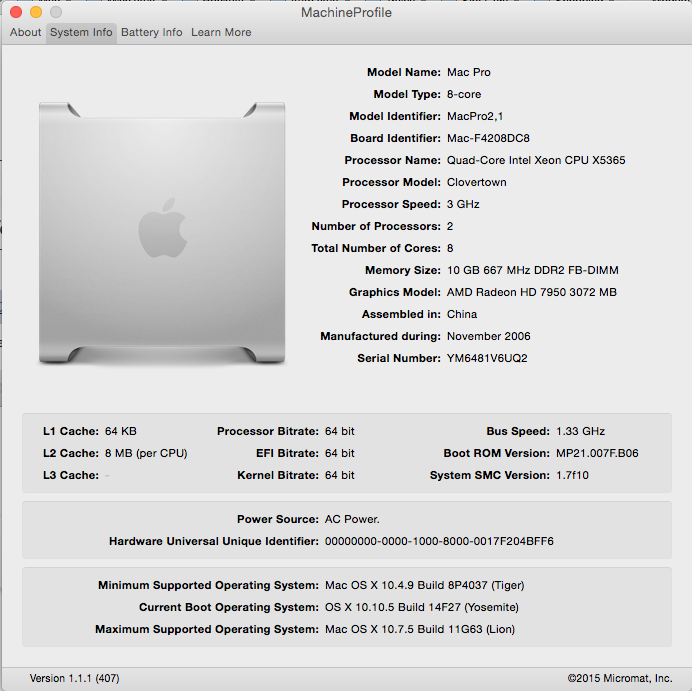

I had already flashed my firmware to 2,1.
The flashing utility didn't work when I tried using in on El Capitan. Worked fine on Snow Leopard though. I think the easy flashing app is incompatible with the newer OSes.
