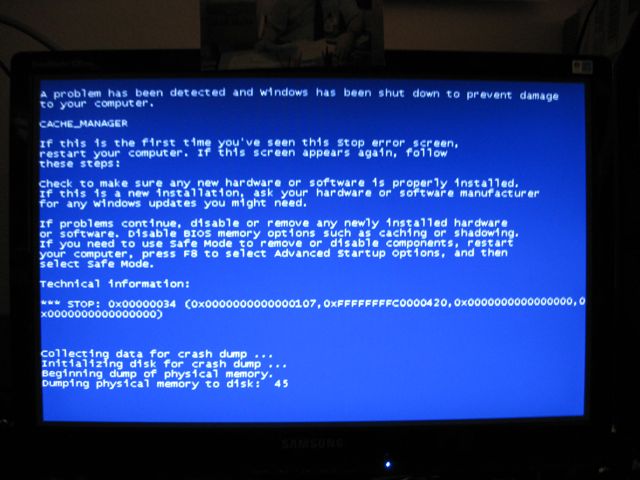

On Bootcamp 3.1 windows 7 drivers:
30 seconds after it booted into windows 7, I get this error. Even in safe mode
it's so fast I can't even get into add/remove programs fast enough to remove the drivers
I consequently had to reinstall windows 7
It was on my list of things to do anyway, this just made me sacrifice sunday morning to do it.
to install 64bit W7, you must re-burn(or restore to storage media) a non-versioned ISO, there are a few How-To's out there.
I personally wouldn't play around with bootcamp 3.1 when not needed, when there is the above mentioned way to do it.

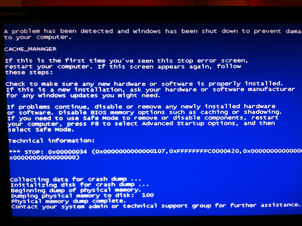

I get the exactly same error with my 2009 Mac Pro in Windows 7 64bit Professional when I install Bootcamp 3.0 and Bootcamp 3.1 .I am not sure if it has something to do with the AHCI drivers I selected at installation (provided by gugucom once). Bootcamp 2.0 and Bootcamp 2.1 works fine.
