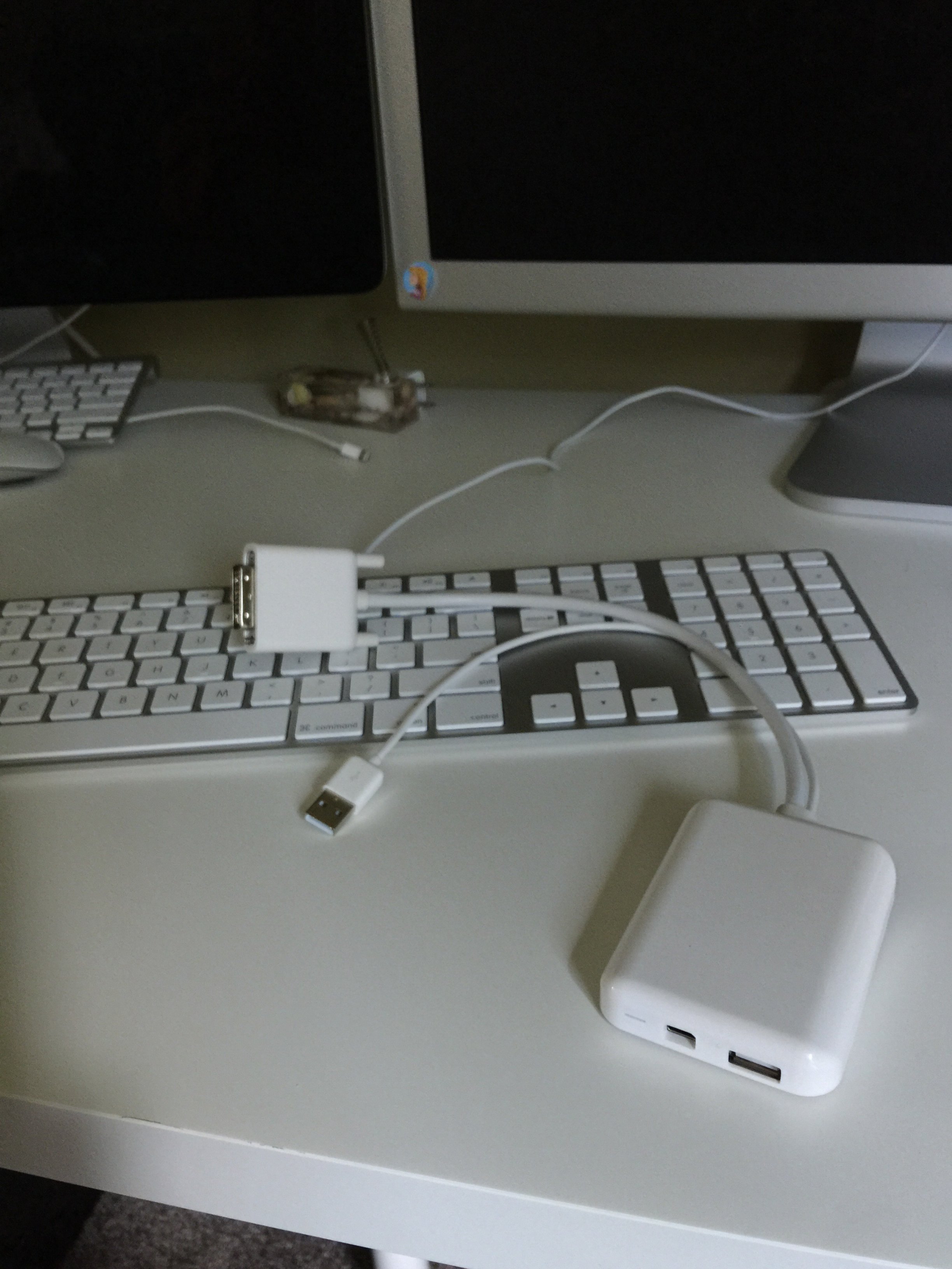

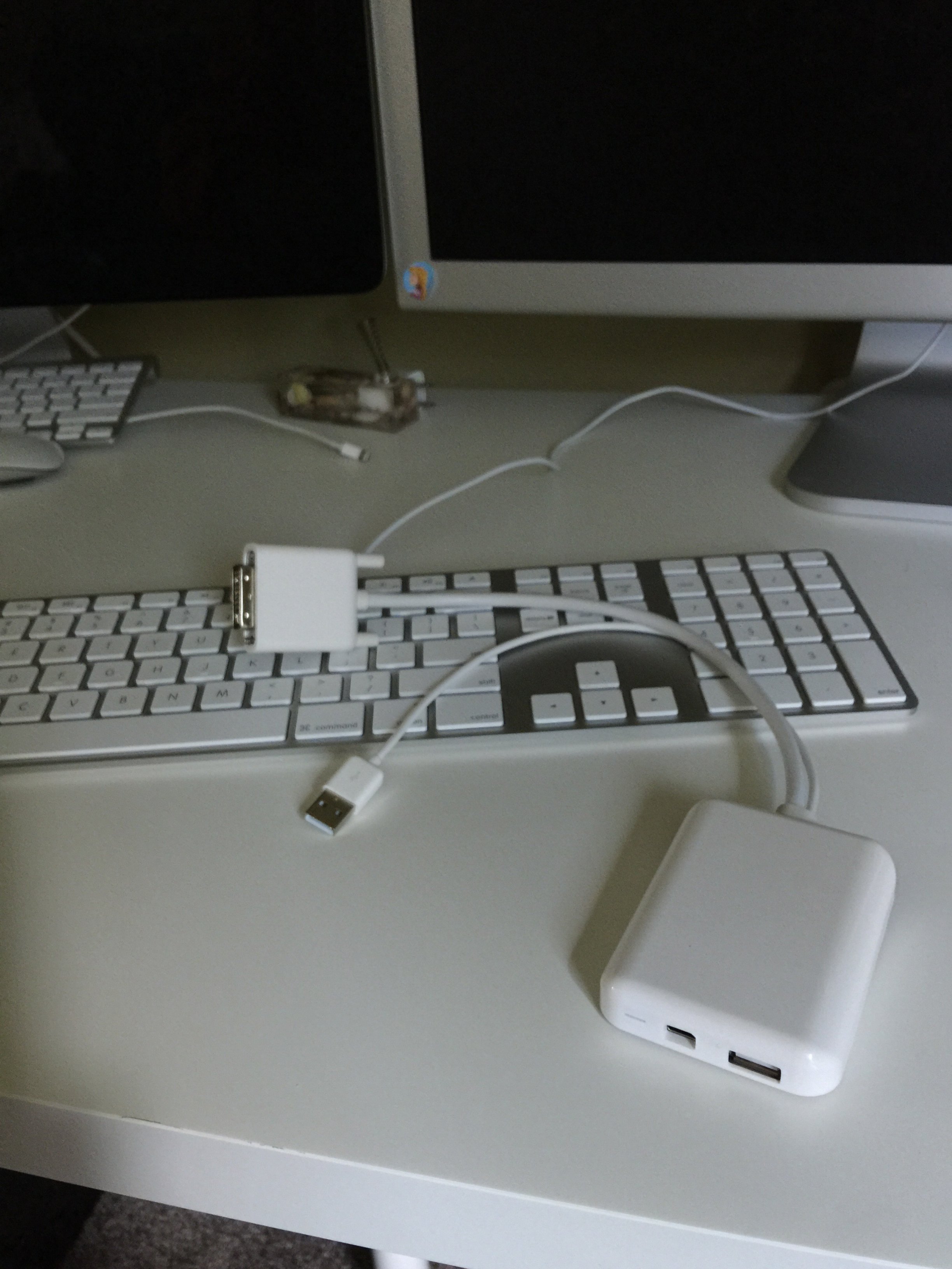

Although your old card might be a bit long in the tooth, I've got my ACD connected via a mdp to dual link dvi adapter. Works like a champ. No need for a new video card if you don't want. Been running great for over a year.

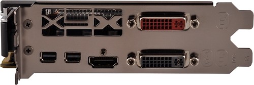

Earlier today, I want to BestBuy and bought the Radeon R9 270X 2GB ($159.99), installed it on my Mac Pro 1.1, and it works just fine. Since I have removed OSX entirely from my HD, I had little control over the screen-brightness... but I came a cross a tool called Brightness Control, and that solved my issue. So far so good. Thanks to each of you for your advice. Enjoying my ACD with (to me new) Mac Pro with no bootscreen 🙂
Maybe you can give us a link to where we can buy that? just curious if it over $100? please tell us the model number and manufacture. And thanks!
Reactions: Fl0r!an
This is a Dual Link DVI to MDP adapter, mdp to dual link dvi is the other way.

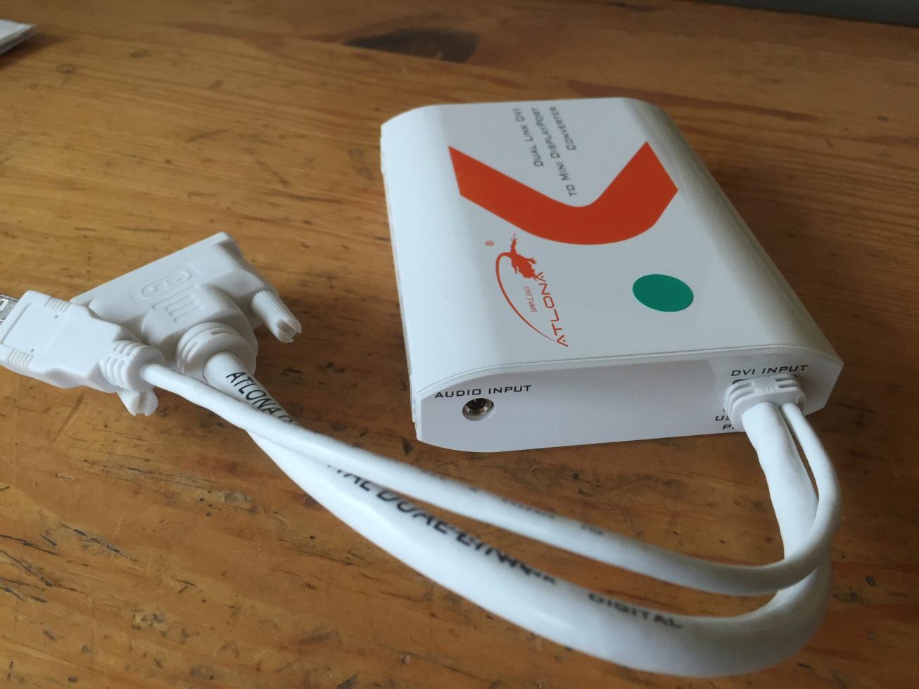

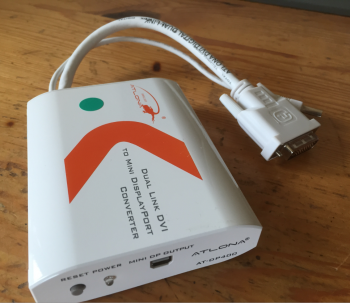

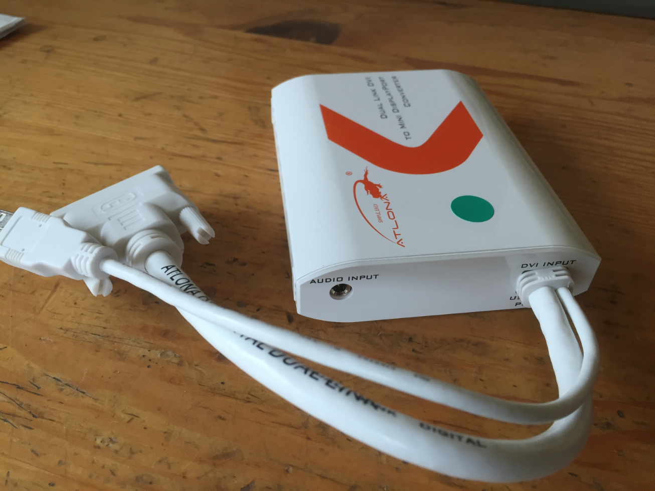

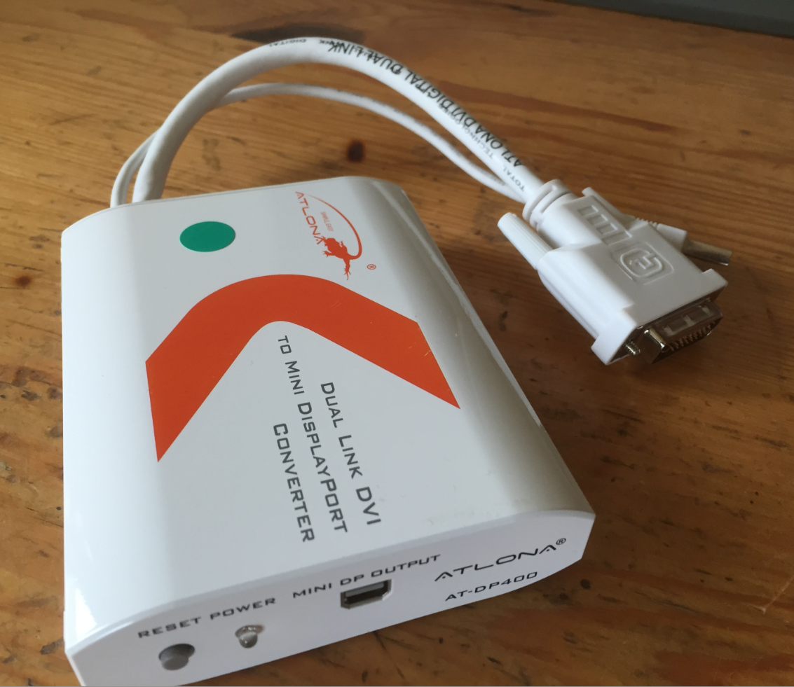

I myself I'm happy with the Atlona AT-DP400. Supports resolutions up to 2560×1600:

He doesn't need any adapters, the R9 270X always comes with DisplayPort 🙂
As I said there's little reason to go for an active adapter solution as they'll easily be more expensive than a new (= also more powerful) GPU.

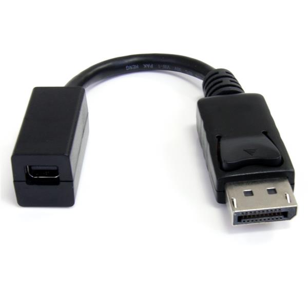

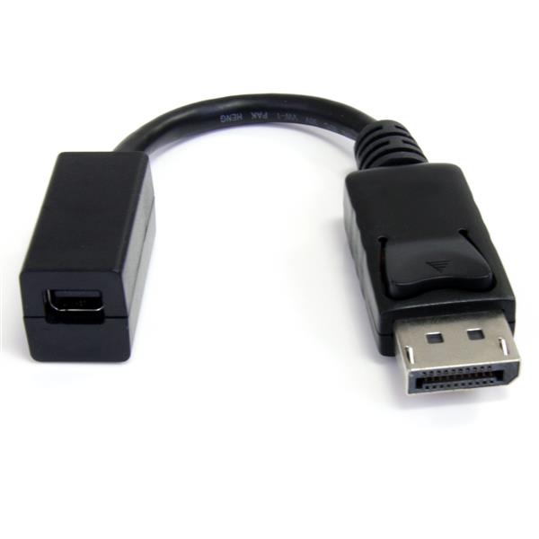

Yes, I realize now the Radeon R9 270X has already DP, only a little adapter for mDP of the Apple DP2MDPMF6IN.main.jpg Cinema Display is needed.
Thanks for heads up. Probably the adapter Synchro3 mentioned is the one the OP needs. 🙂 I have that adapter too.
