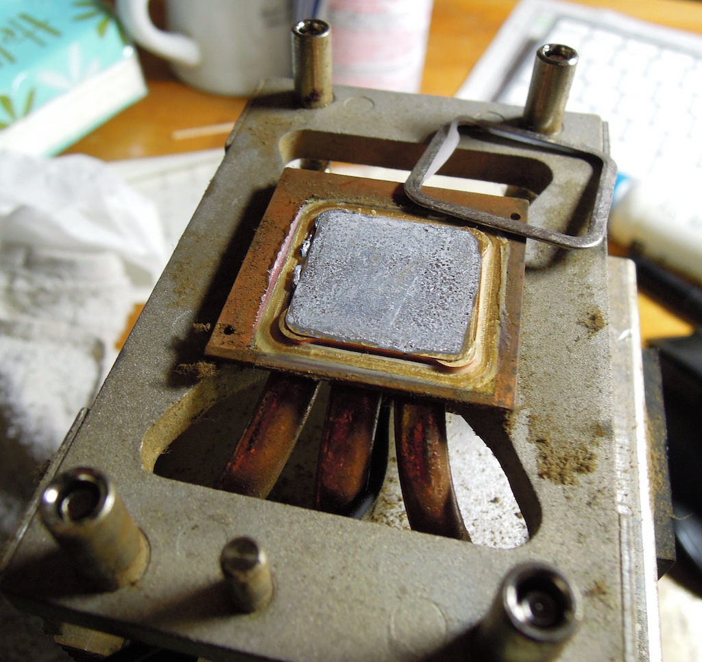

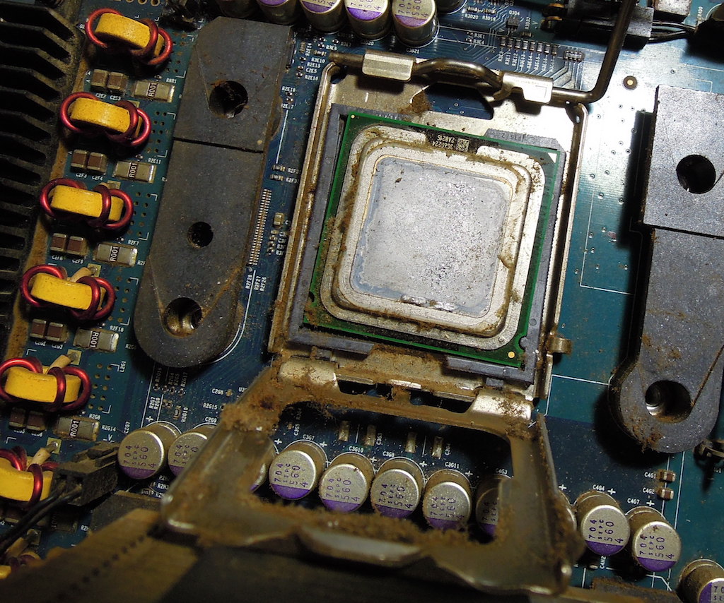

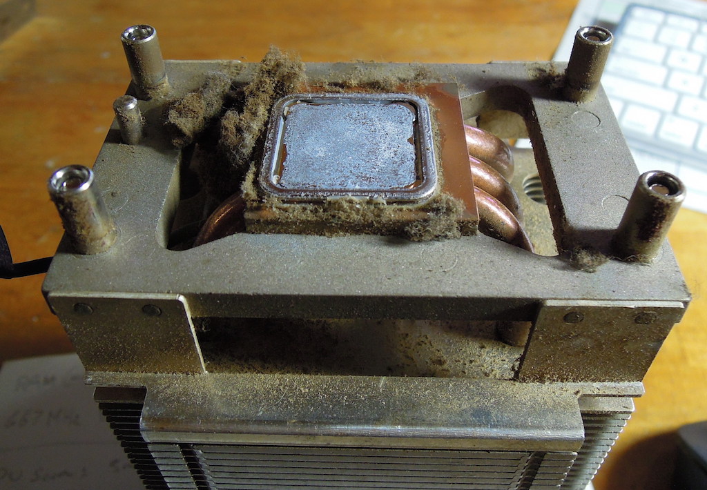

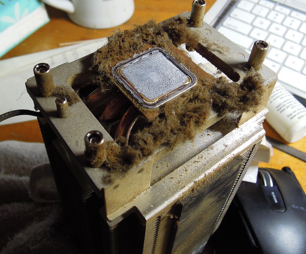

This is what I found under the CPUs.
Both motherboard sockets were like this.
CPU A ( top if cMP is vertical ))
CPU B ( lower ) It could well be that CPU B got "cooked" !
Very hard, deteriorated thermal paste - took ages to remove, almost like solder.
This photo was taken before final cleaning to mint condition.
