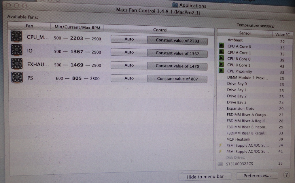

Checked and my CPU fans are working.
Copied Mac Fans Control over to the Mavericks install.
Mavericks 10.9.5 booted up in SAFE BOOT but before I could get Macs Fan Control up & running . . . the 2,1 FROZE.

EDIT : Just managed to get Mac Fans Control running in Mavericks 10.9.5 with the Apple HD 4870 and set some arbitrary HIGH fan speeds to prove a point. This time it took about 5 minutes until the FREEZE happened again.
