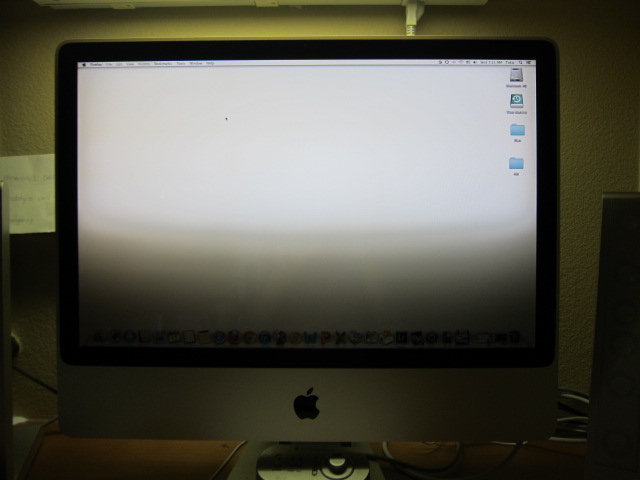

This is what it looks like.
I used a white desktop background so that you can see where the darkness starts.
I think it may be a different issue but the solution may be the same.
I'll probably need to replace the whole LCD.
Yes, that looks like a different issue. That sucks, but hope you get it sorted out.
