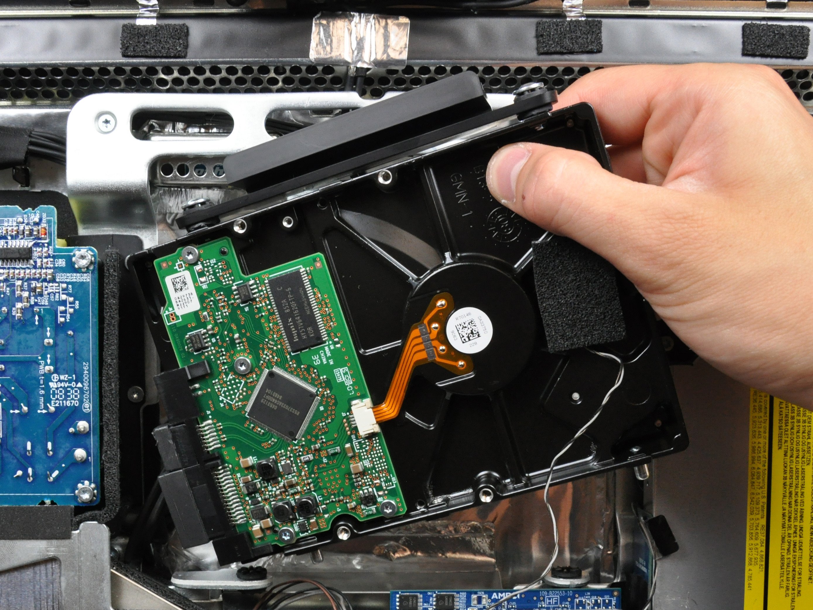

Here's some steps on how to replace the hard drive. You can choose to replace that mechanical hard drive with a solid-state drive (SSD), which has no moving parts. And, will make your old iMac much more responsive, even more than when it was new.
That quide shows you what tools you will need, and offers to sell you a hard drive or an SSD, and the tools if you need those. The Crucial SSD that iFixit sells would be a good one.
