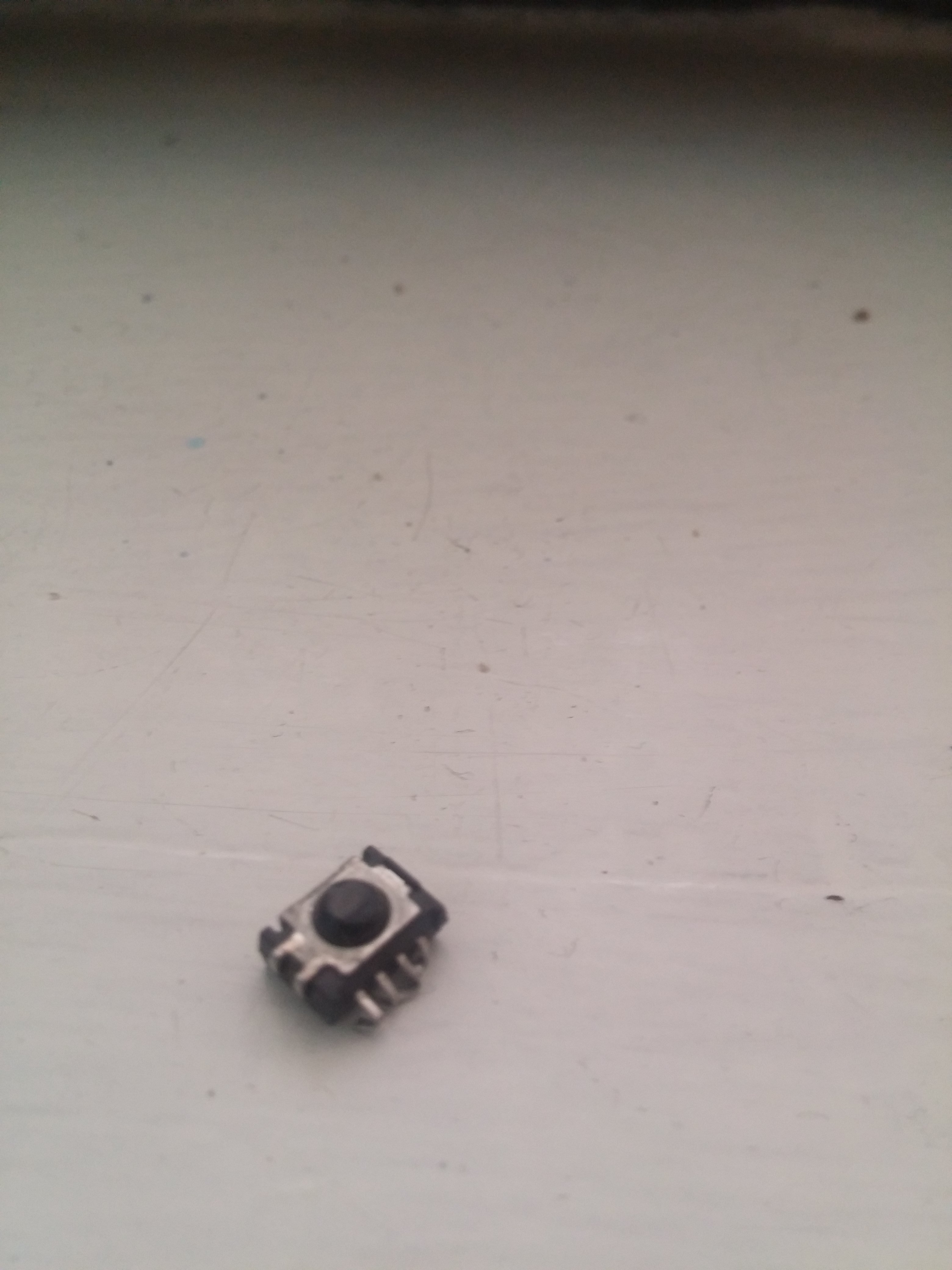

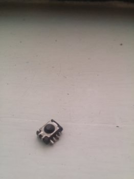

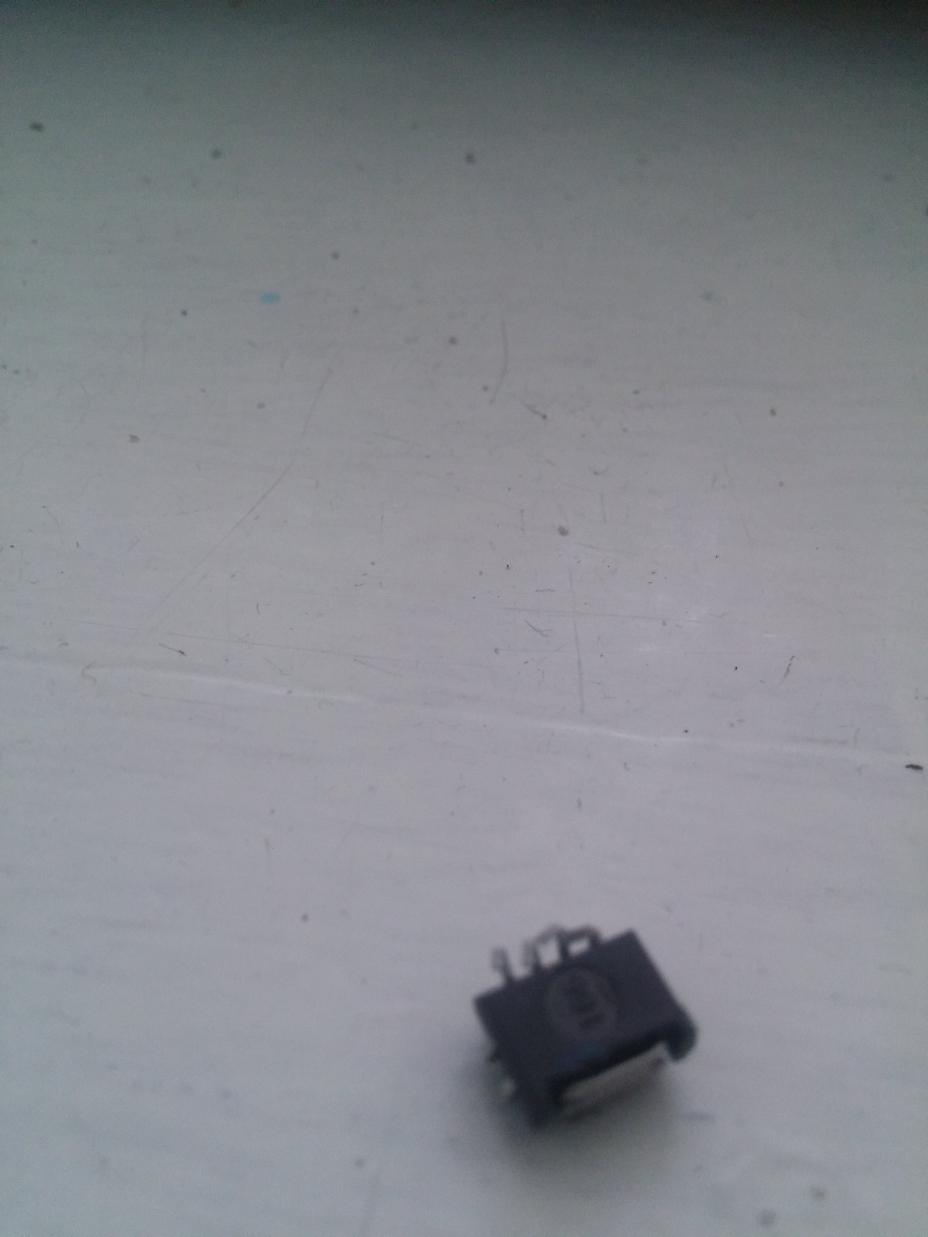

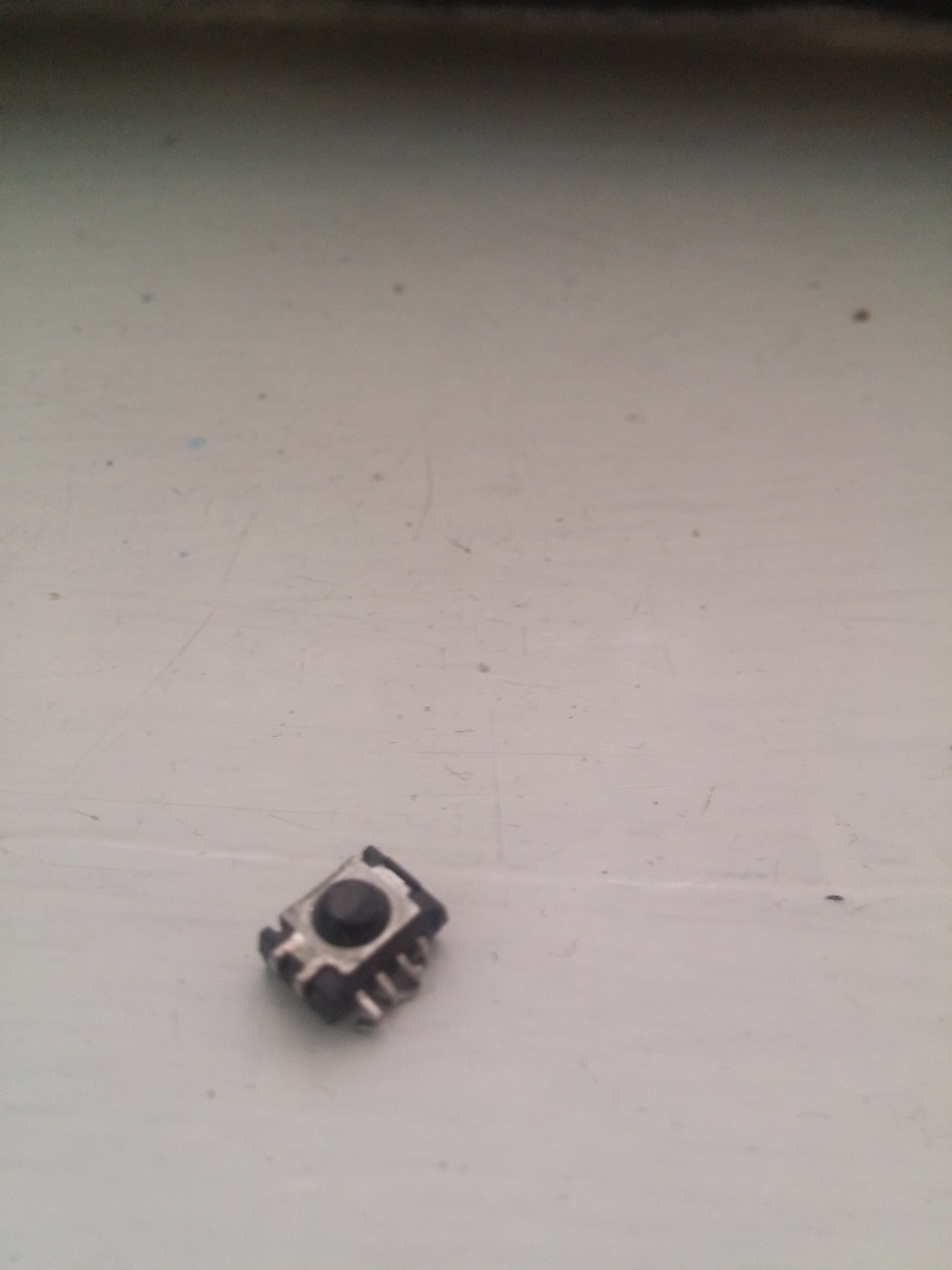

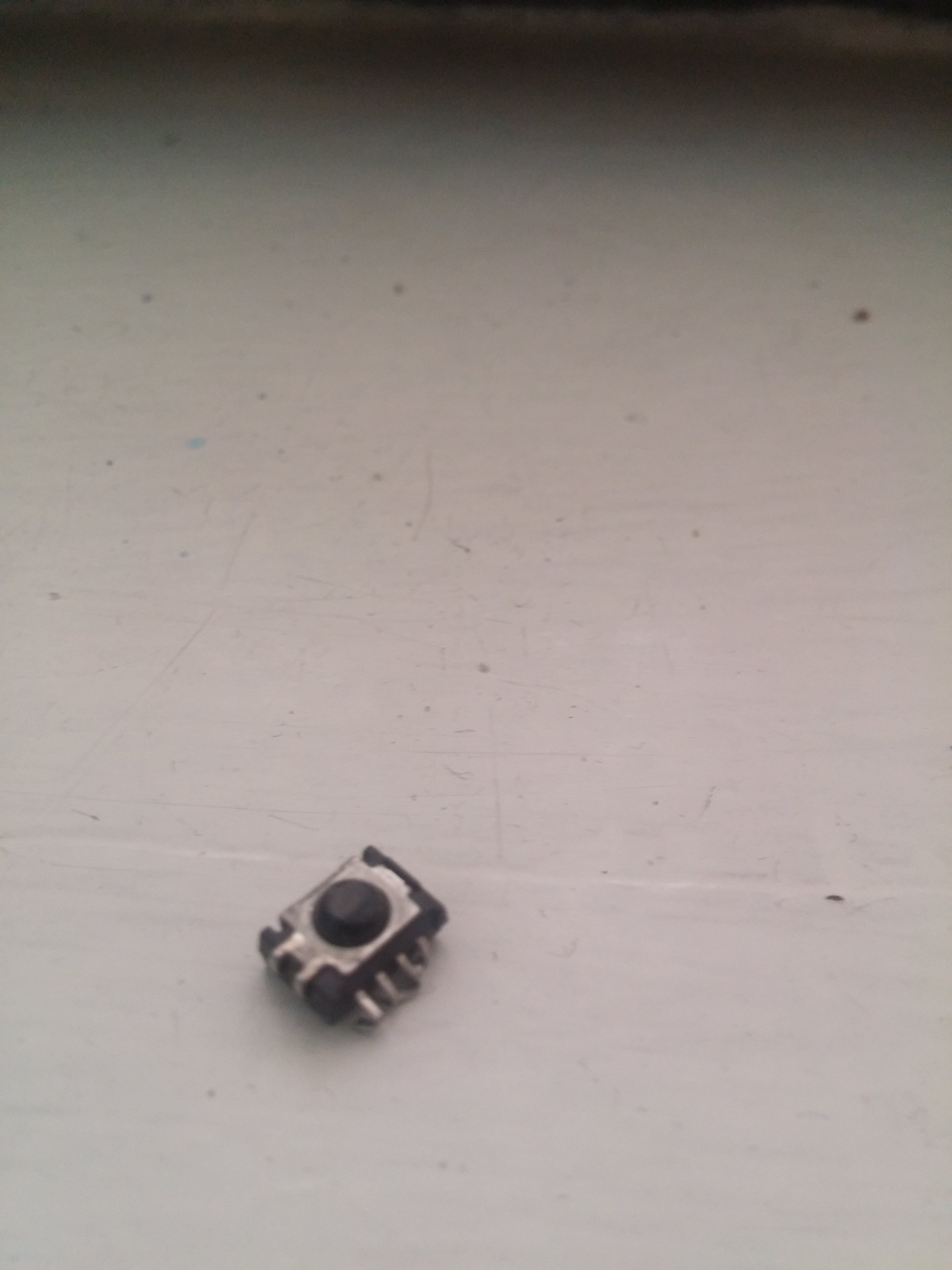

I don't know if the 3mm chip belongs to the machine. It's slightly damaged (pins bent); I can't tell where it might have been attached if it's from the machine.

http://www.filedropper.com/img20180729143605

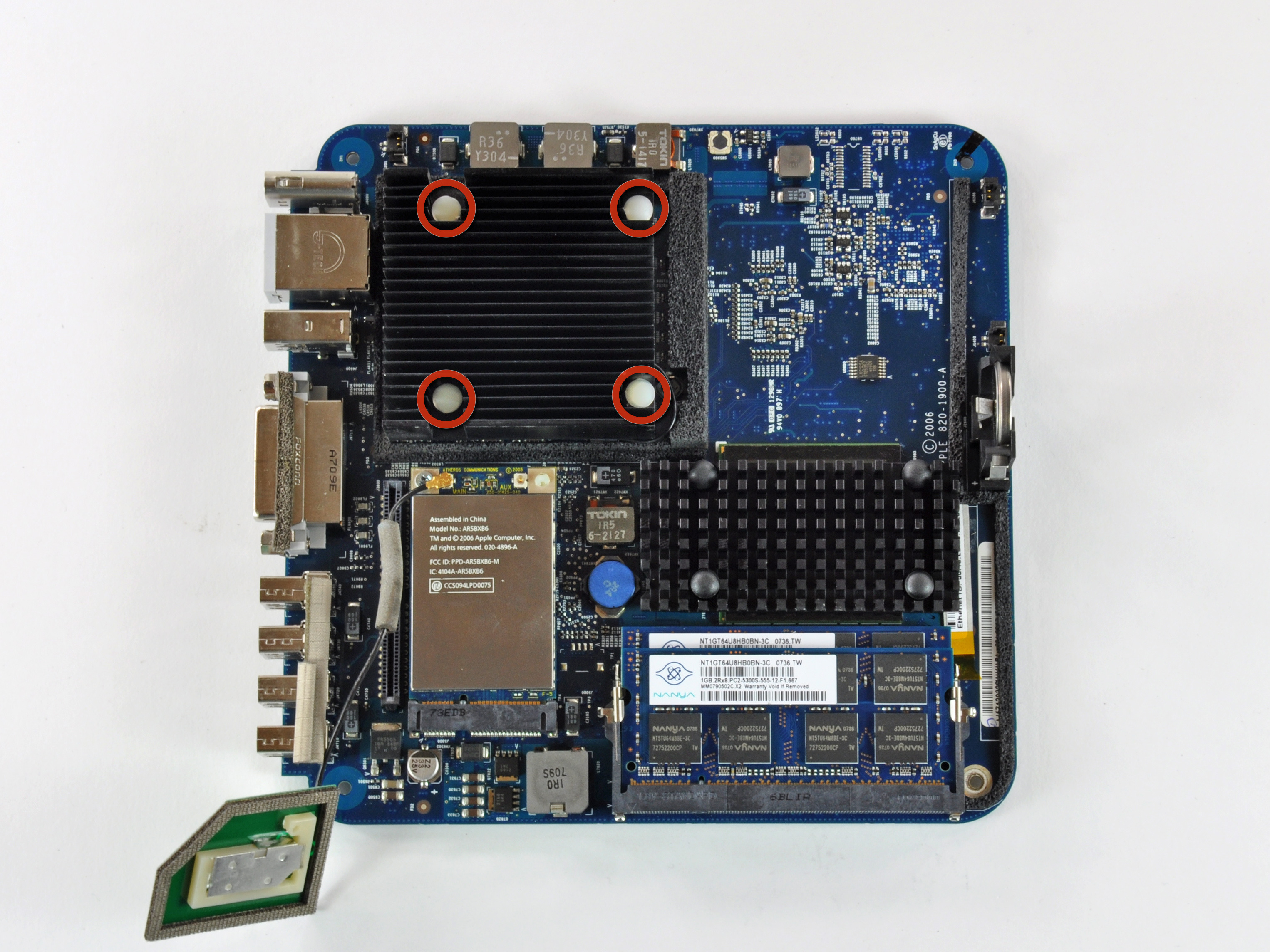

Look at a logic/mother board of your macmini on Ifixit or online.
Then compare that to your board.
If you can locate the missing area, Place the part in.
Start mac mini
Any computer reapir place should fix this.

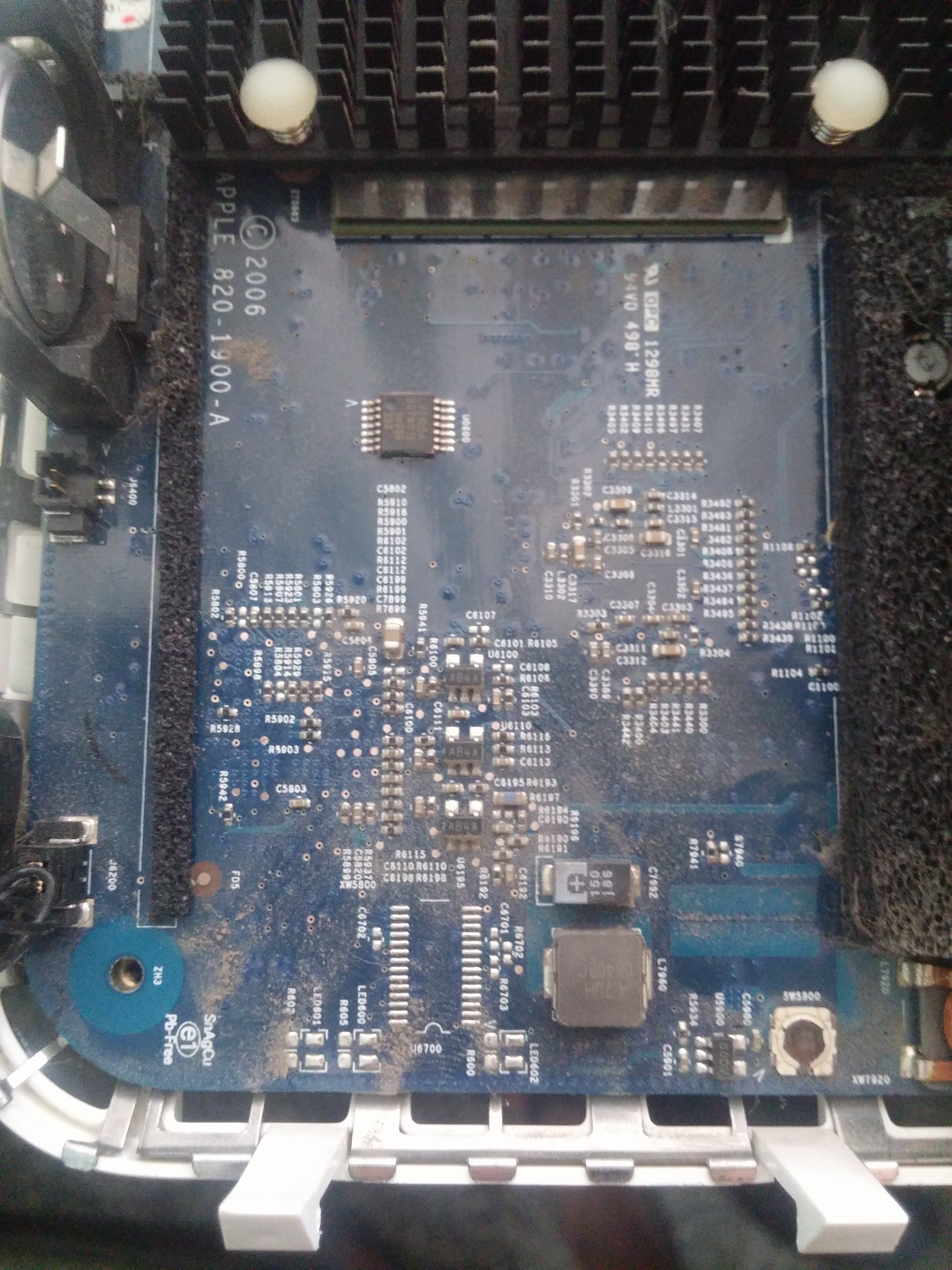

That is a switch for the power button. You are gonna need to solder that to the board or replace the logic board.
I assume that's why machine does not start?
I can't find anything missing or the location of the chip.
How would this chip get loose and damaged as I haven't opened it in a long time.
What's the location of the chip
online image
https://d3nevzfk7ii3be.cloudfront.net/igi/RVgwGtAIZQIJmCn1

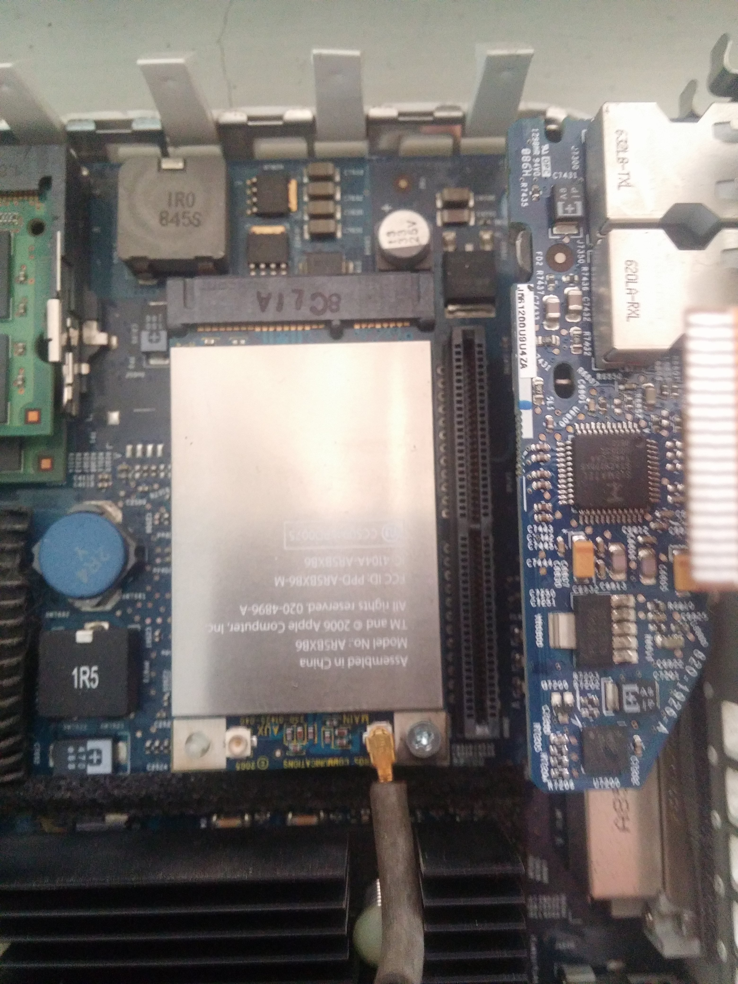

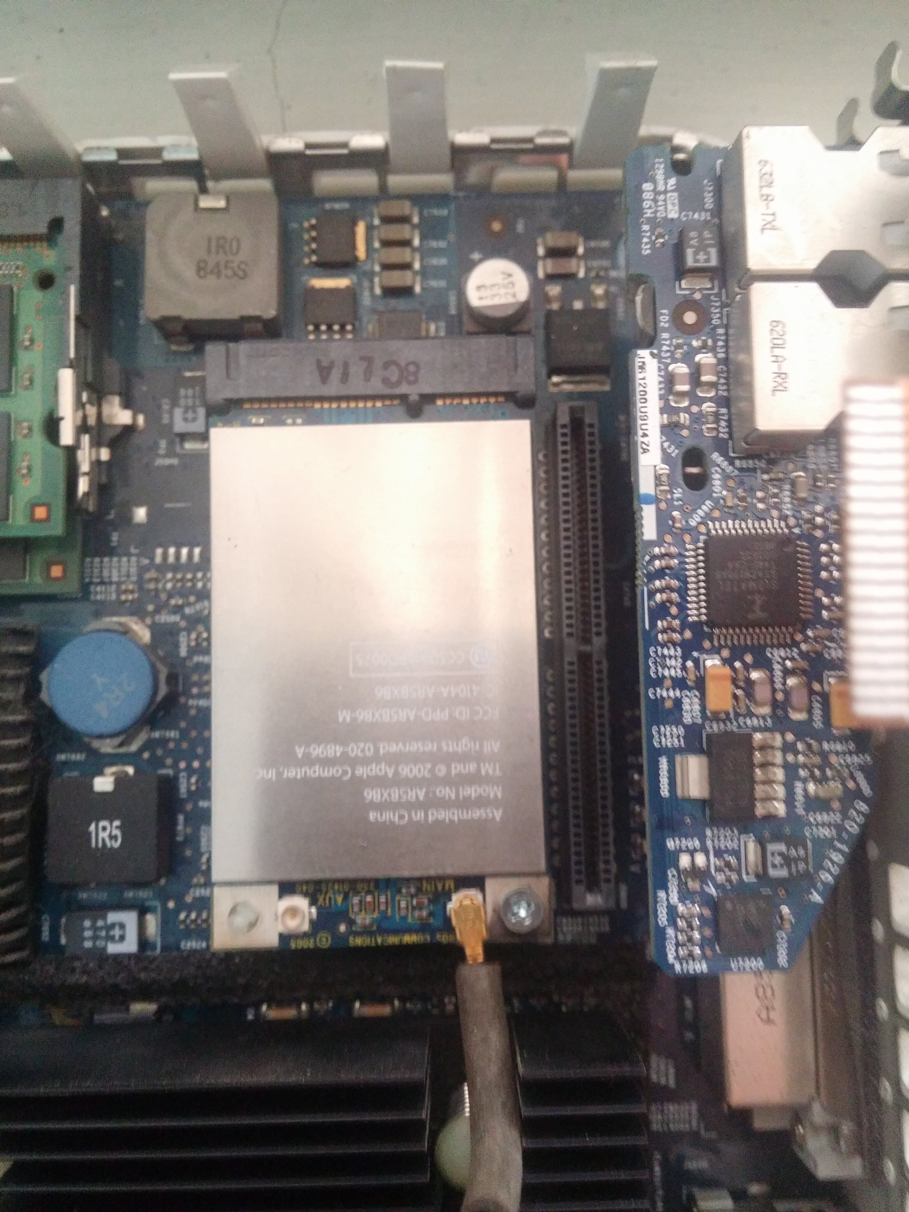

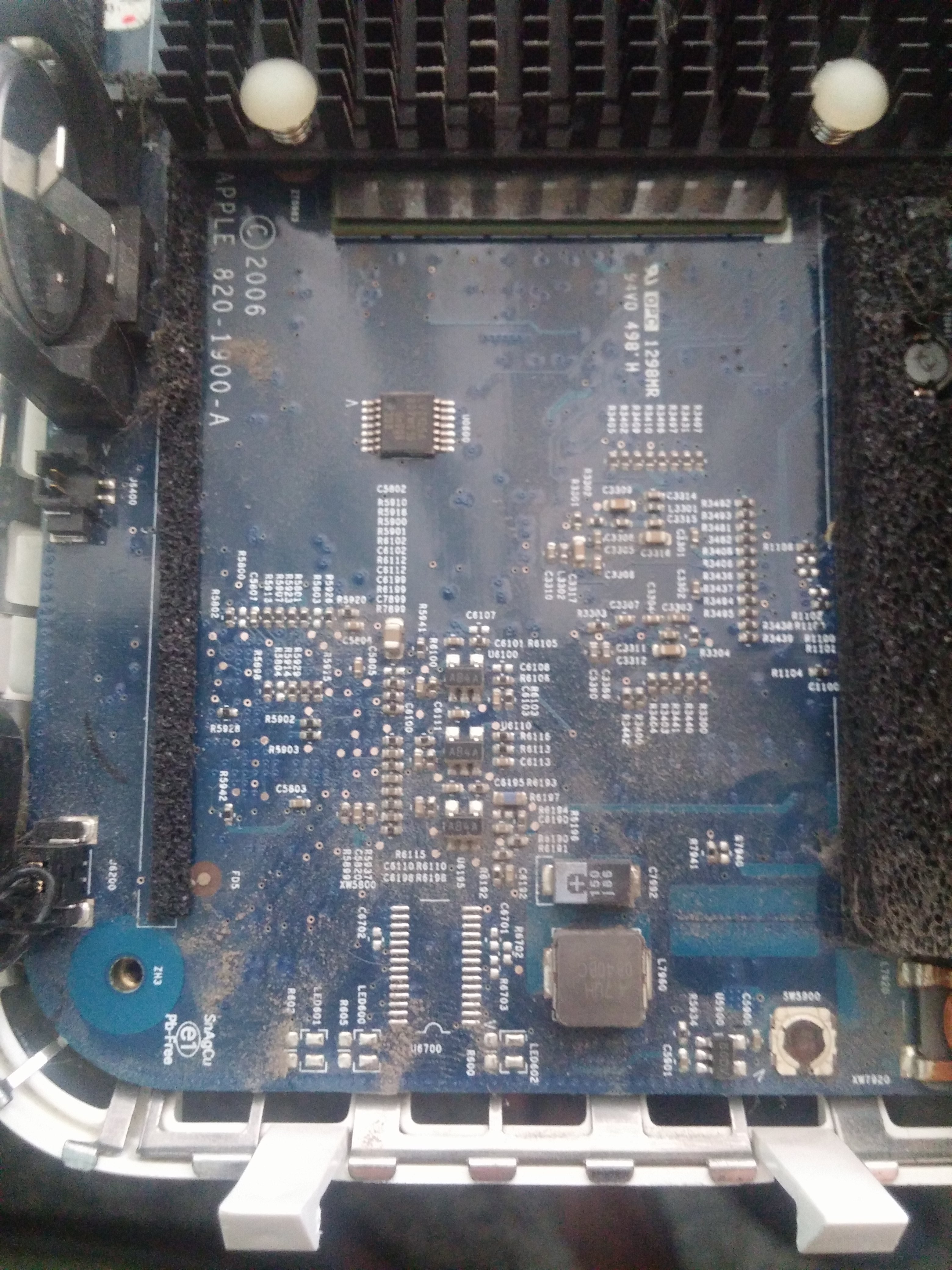

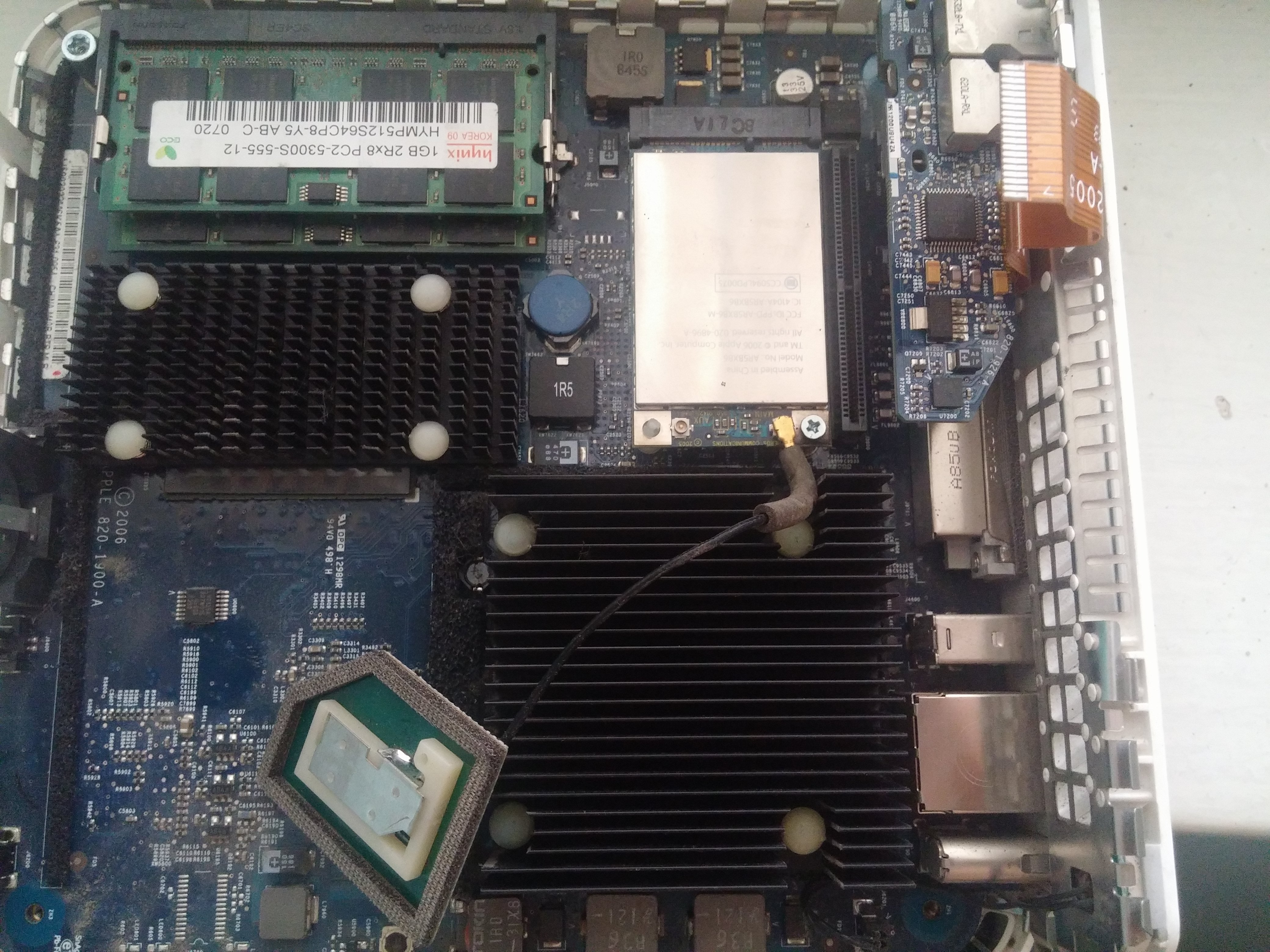

I might have given you slightly bad advice. Check the board that is attached to the power button switch, mainly under the white plasic with the power logo. I bet that is where the problem lies.
I don't see any board under power button. The power button has a small cable that attaches to the main board.
The machine turns on and the fan works but it does not boot.
Can you post a picture of what you are mentioning.
There is a small 1" board slightly above and to the right of the power button (if looked at from the rear ports), however it looks fine and nothing appears missing. It's not part of the main board.
Also I don't know if the chip belongs to the machine or if it's related to booting.

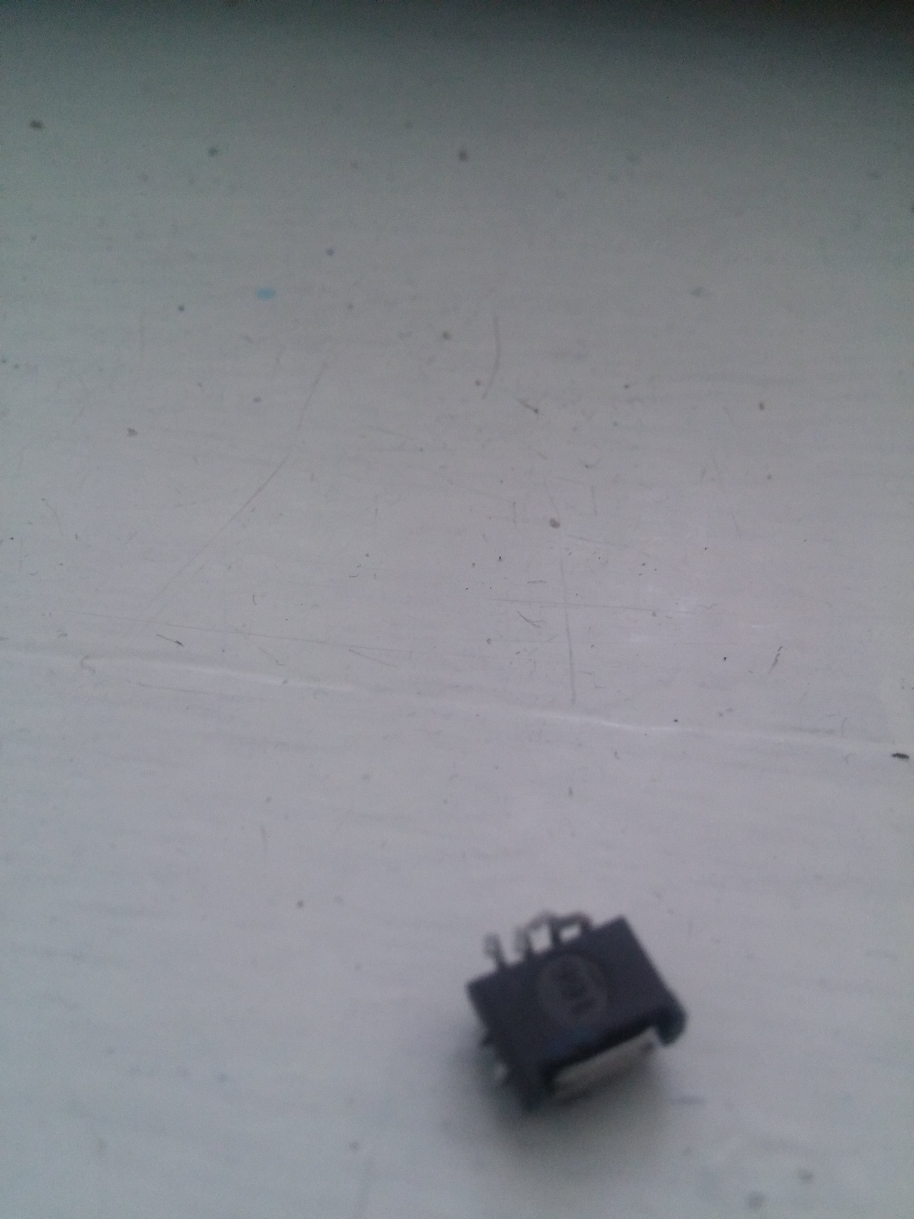

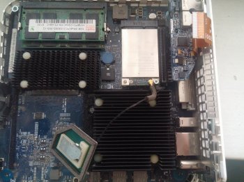

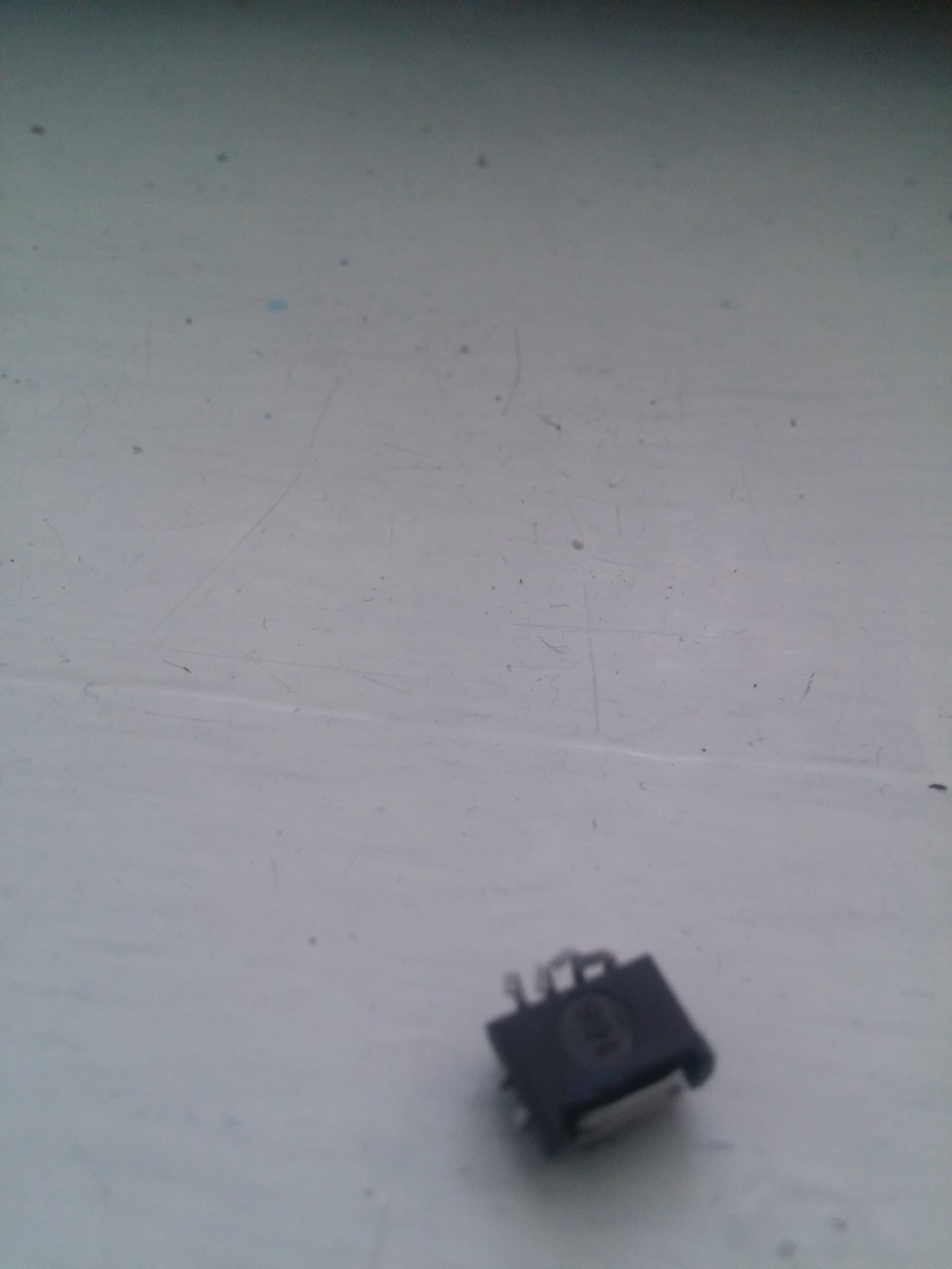

It's not the little board with a cord attached dangling at the top. It is an actual chip that looks damaged. lI'll post them here again. Is it for both wi-fi and bluetooth.where should it be; A little bit strange as I was using it the same day or the day before w wifi.
I use wifi but not bluetooth
Any ideas on why the machine does not boot.
That "chip" dangling in your Mac mini is actually your wi-fi/Bluetooth antenna, nothing to worry about.
[doublepost=1534073927][/doublepost]Do you have any idea where the chip came from. I cannot find it.

Some paranoid person might have poked at the infrared sensor thinking it's a spy cam. Who else have access to where the mini was stored?

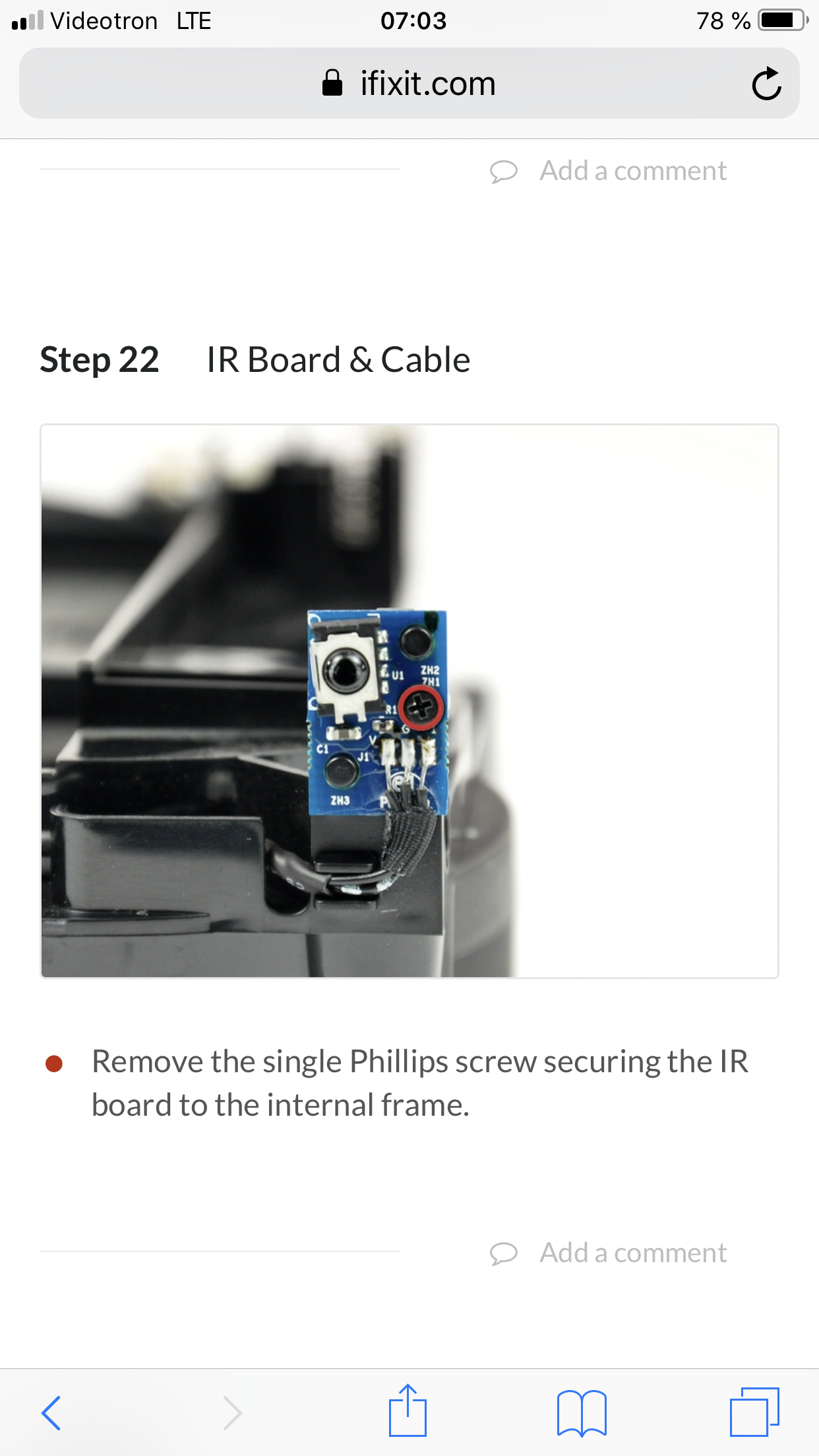

That loose chip in your mini is the infrared sensor/receptor.
Link: https://www.ifixit.com/Guide/Mac+mini+Model+A1176+IR+Board+&+Cable+Replacement/1106
would it have anything to do with the mac not booting? If not, why do you think it's not booting.
It seems like one would have to remove a lot of parts to get to it though.
