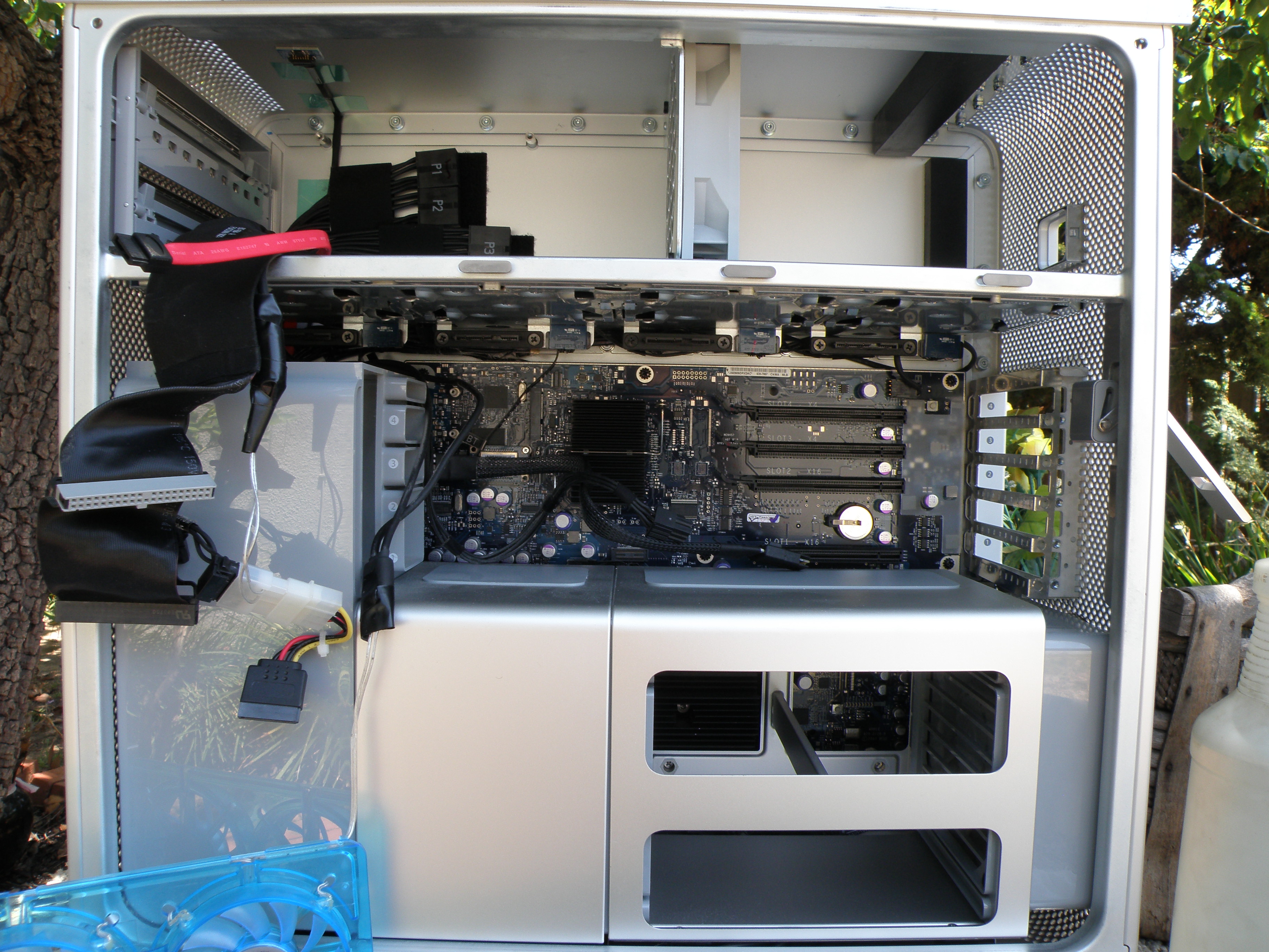

Hopefully when you said "cleaned out the dust", it was not only from the ram slots in the risers. I do this (pictured) 1x a year. Keeps the ole 08 in tune!😀
Wow, that looks very clean. How do you do that?
I also do the same with my 1,1 I just take out the ram risers, Optical Drive tray, hard drives & graphics card and give them all a blow over with compressed air, they are all easy to remove. I've never cleaned my PSU like OS6-OSX does but suppose I should for a 6 year old machine! So yeah just use compressed air.
