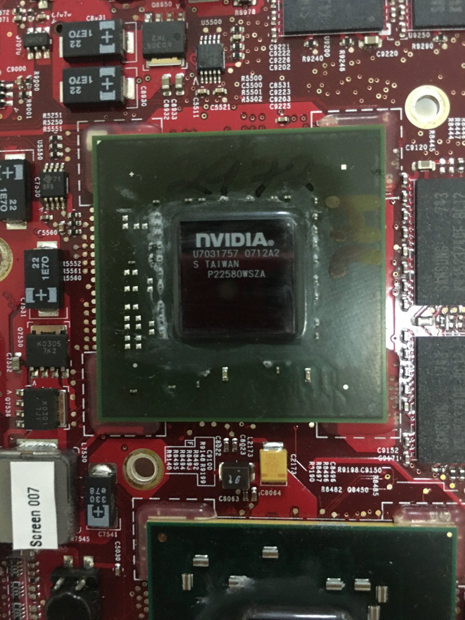

I picked it up from a repair shop a good few years ago; always thought it might be a no-hoper; it had been used for parts before, so is the bottom half, without hard drive, fans, and a few cables. The board doesn't appear physically burnt, although the GPU does appear to have an imperfection on the corner of the die, which doesn't fill me with confidence.
I might swap the left I/O boards in from one to see if it gets any further. I've already stripped the machine down fully, replaced thermal paste and checked all the connectors, which appear good. Apart from the connector for the (not fitted) 3G/GPRS module of course.
Might also try connecting the 17" battery up that I have - the connector appears identical.

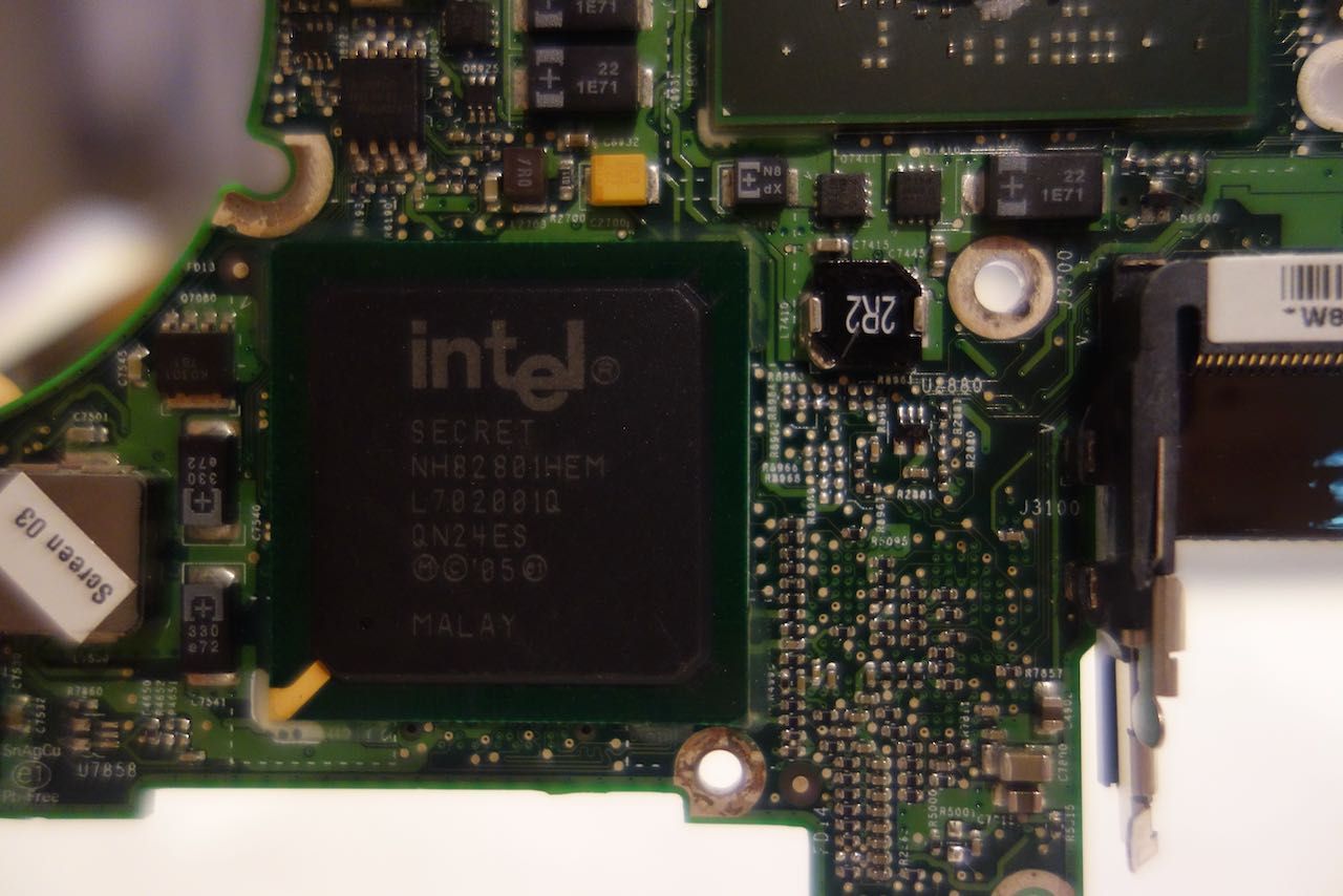

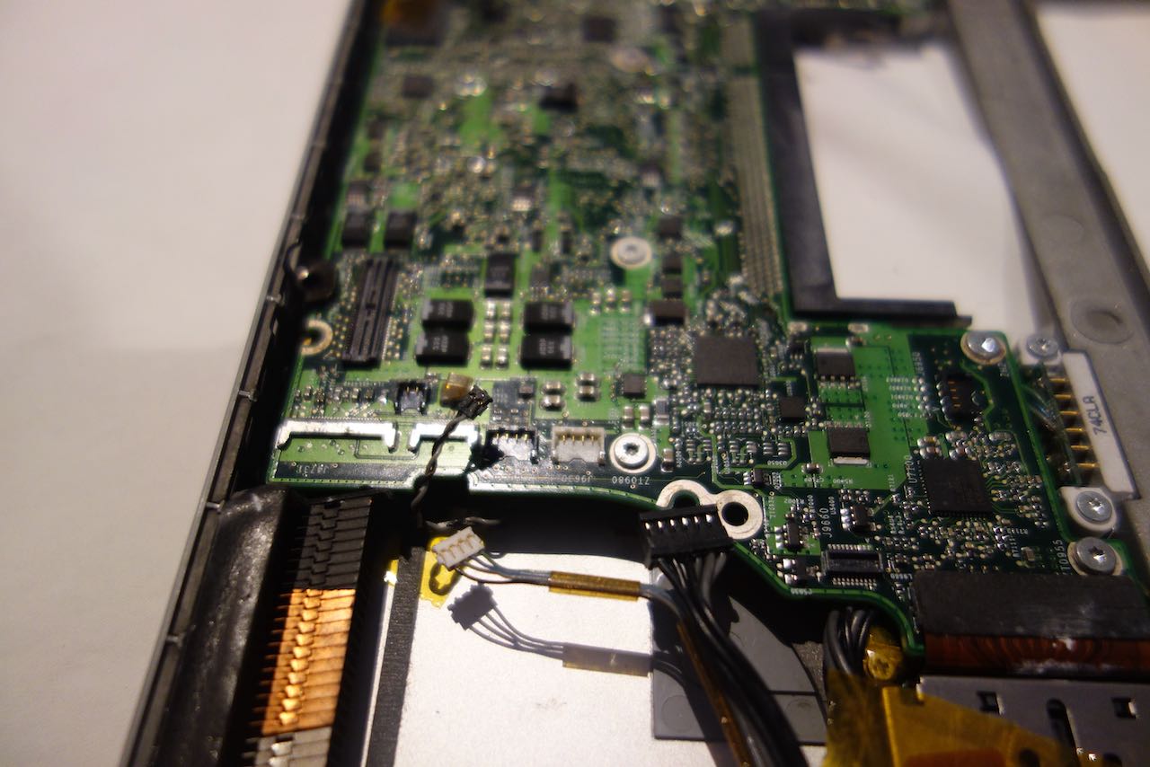

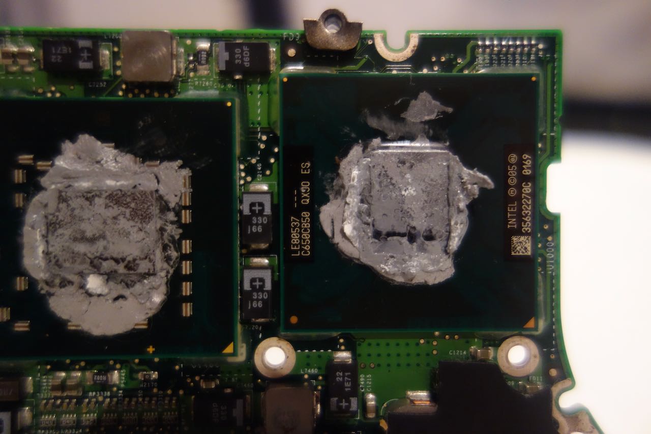

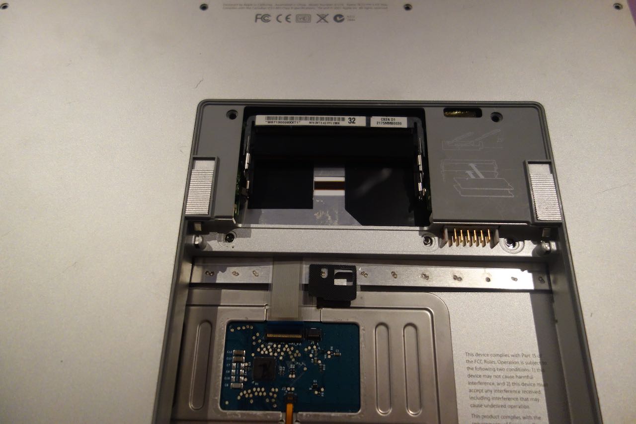

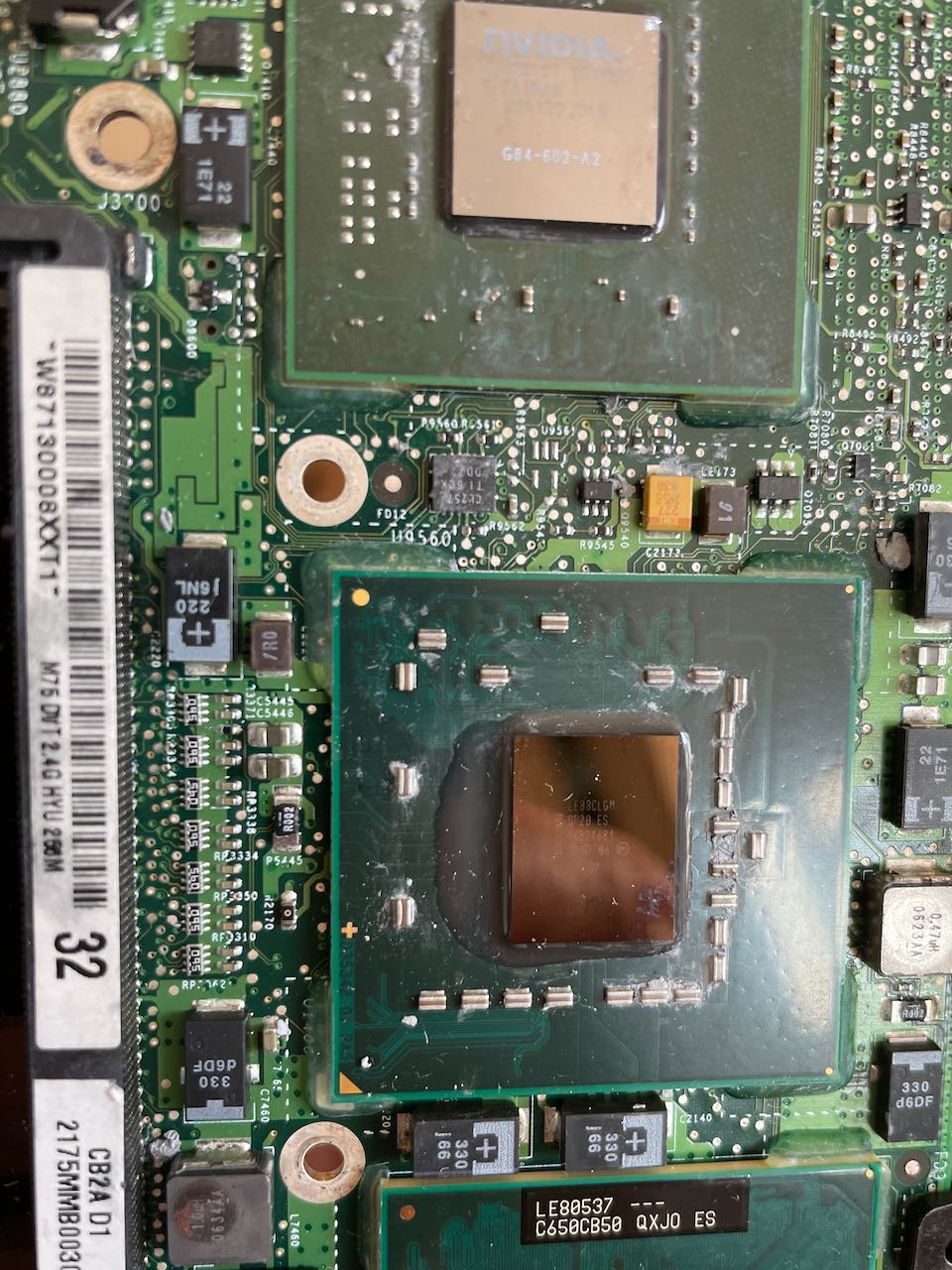

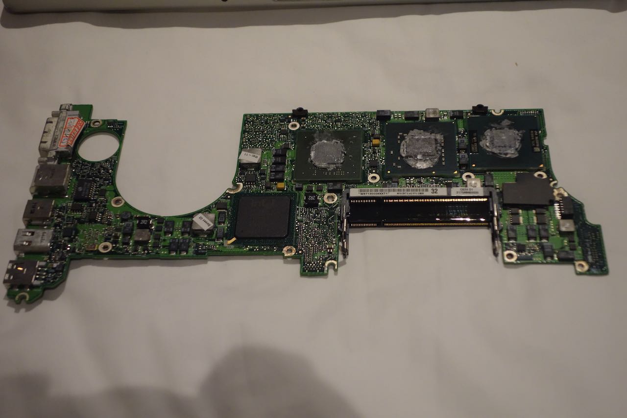

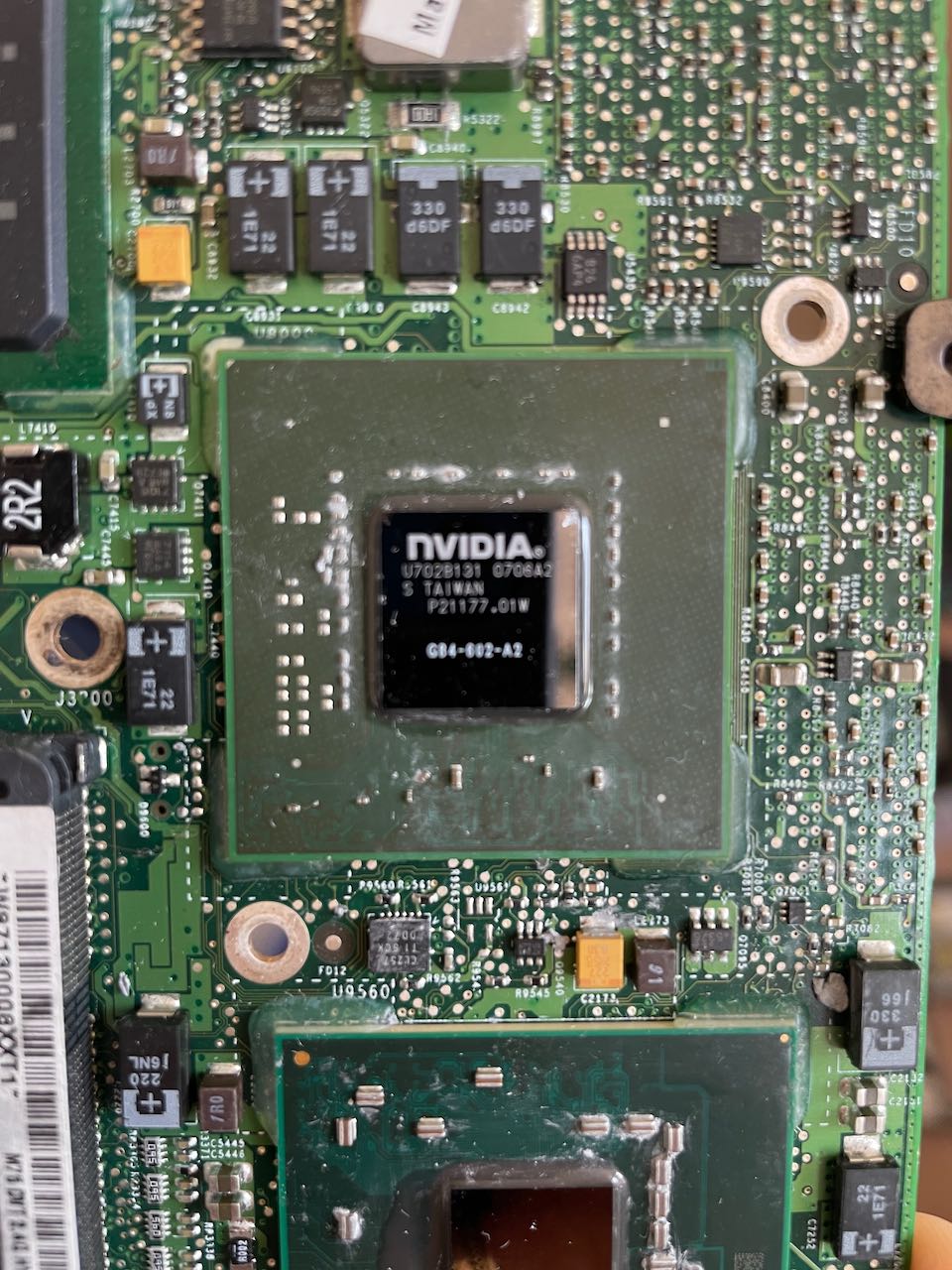

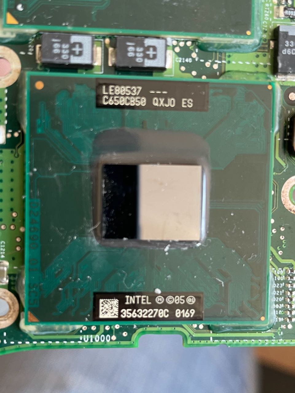

I've also tried fully disconnecting the clock battery; this appears to give the grey screen every time - so looking like it is the GPU. Will post up some pics of the guts, it's a standard early 2007 MBP with a green board, and the usual assortment of ES, SECRET and CONFIDENTIAL chips on it.

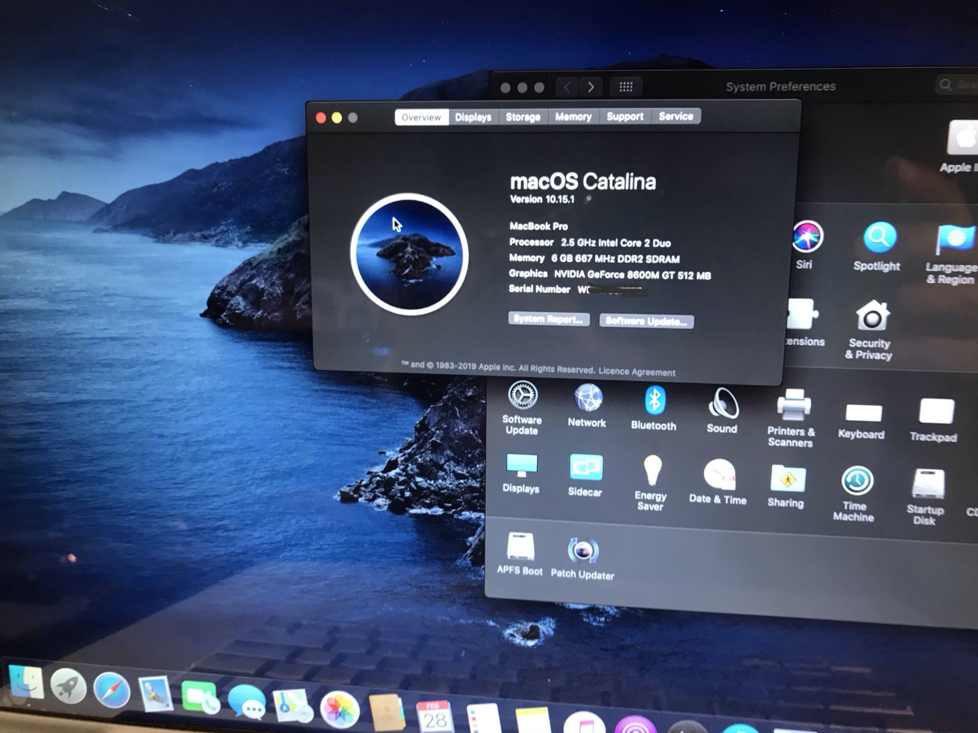

Yep, 90%+ sure it's the GPU, or just a wonky prototype board. I've run it half disassembled connected to a scrap 2008 MBP's left IO board and a 17" battery and it gets a little further, but does the dead GPU grey screen/incomplete boot half the time.

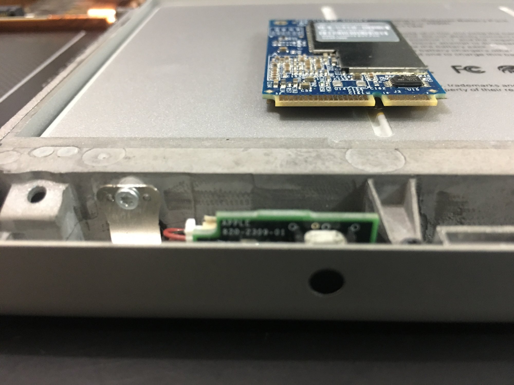

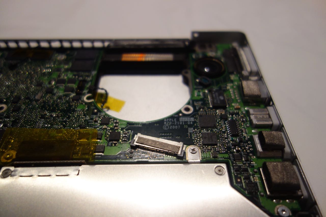

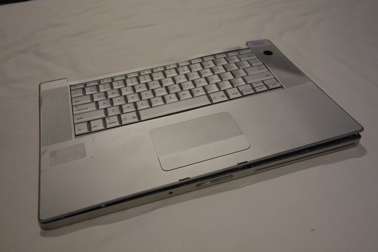

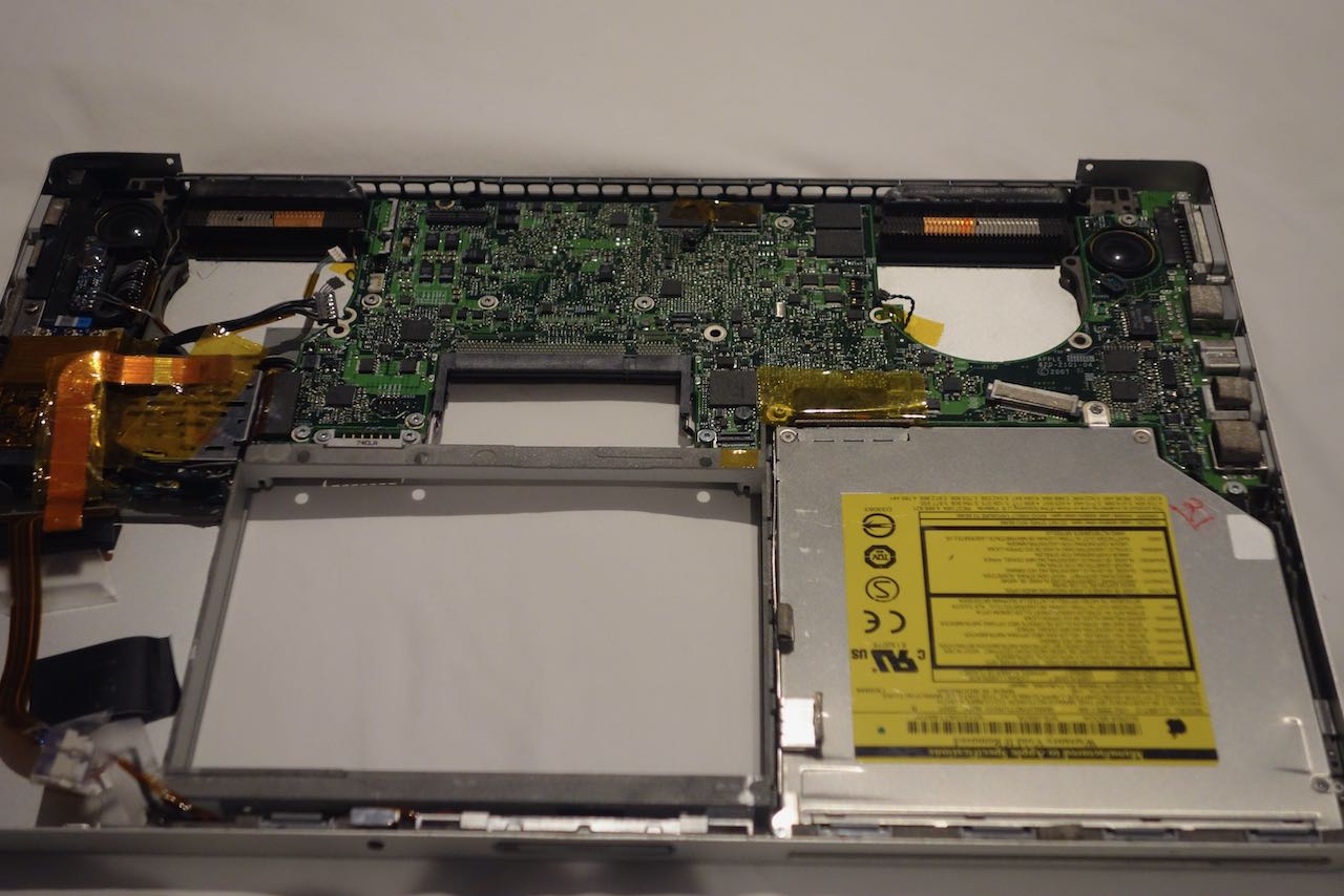

and here's the machine (original parts + mid clean to repaste it)

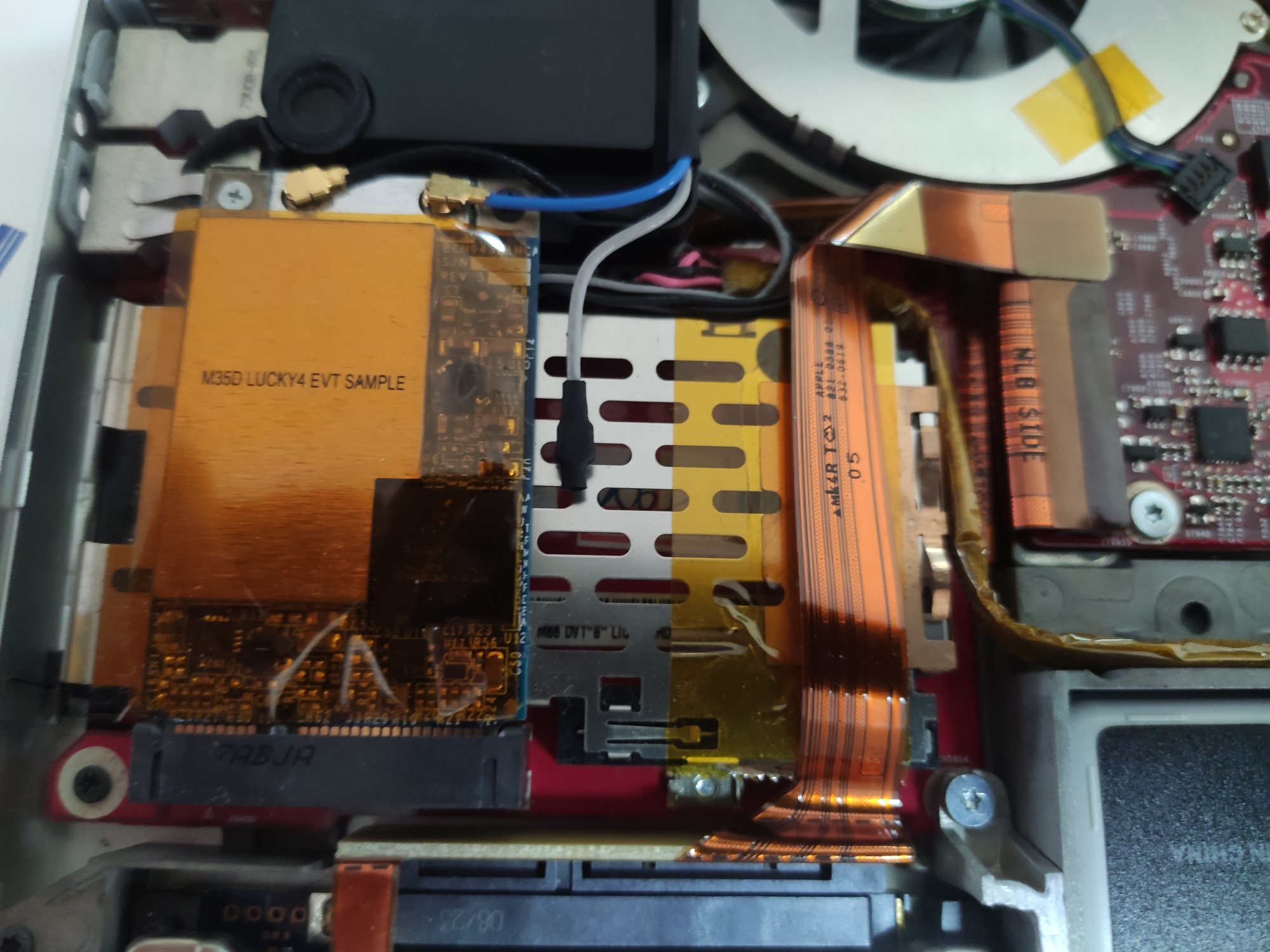

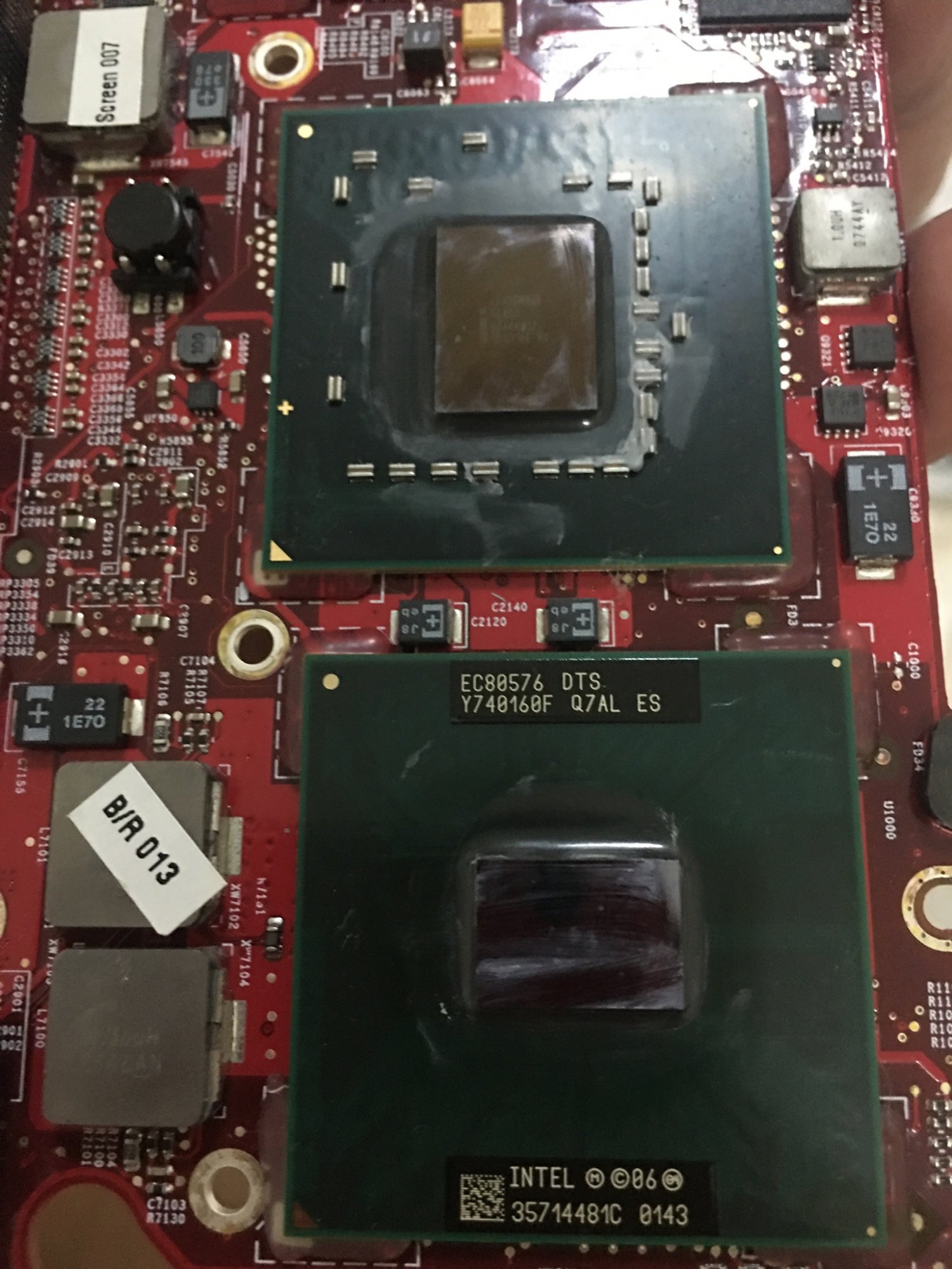

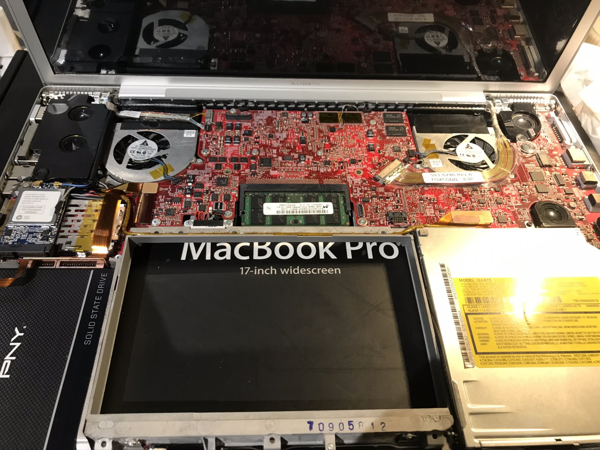

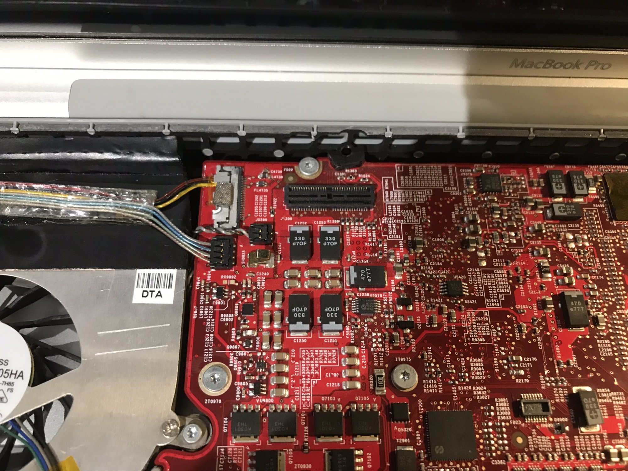

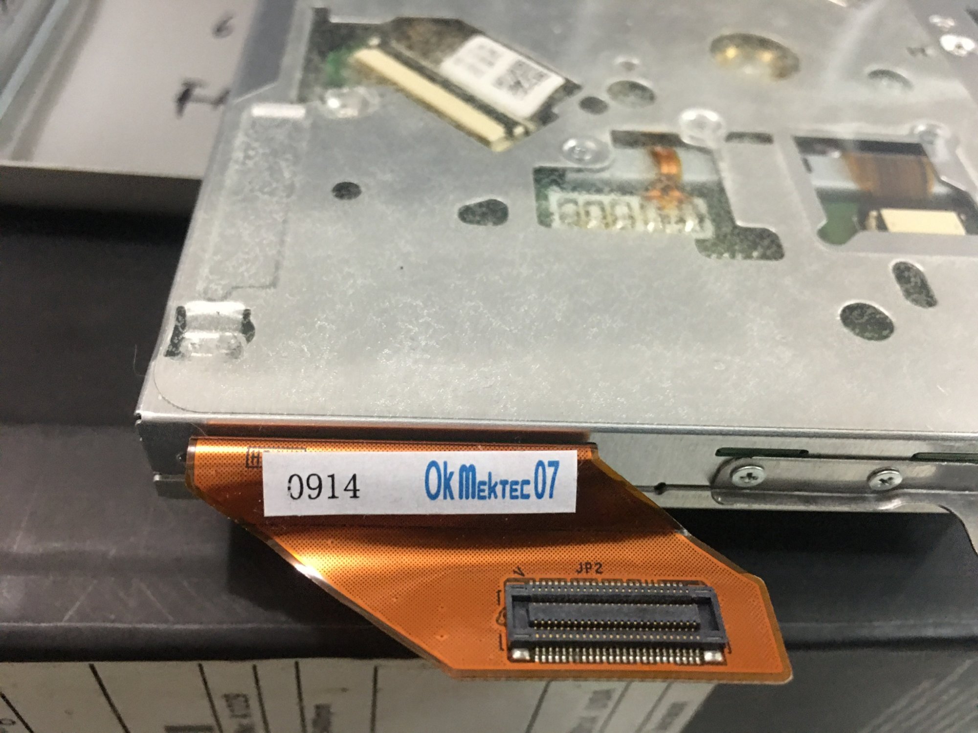

Wow cool! I have the MacBook Pro 17” 2007/2008 hybrid prototype with the red board. Still working perfectly but not for daily use. Keeping it secured in a safe lol
Yours sounds like a gpu failure. Has the old Nvidia chip and not the revised one. But still a cool proto!

Love the red boards and Optical drive! Guess they were replacing a lot of the internals for that revision, so nearly everything in that machine is new!
Nice!
Yeah! Yours cool too! My prototype has the a1229 body which is the 2007 17” model but it’s a 2008 17”. Kinda weird still not much information. Codename is #Lucky4.
if you need the gpu chip replaced with a revised version, look for dosdude1 or just don’t do anything. These machines common issues are the Nvidia chips.
