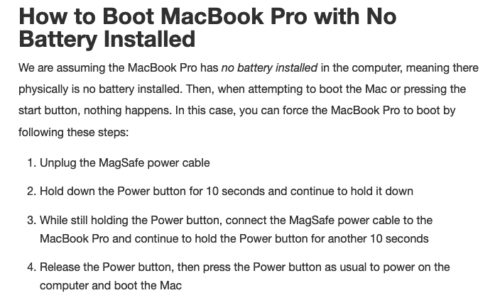

As you observed it doesn't turn on without a battery.
I had one & it started fine without a battery. Ran slowly, since Apple reduce performance so that power requirements exceeding the adapter rating don't cause unexpected shutdowns.
Is the adapter you have 85W ?
Reactions: Rico Muerte

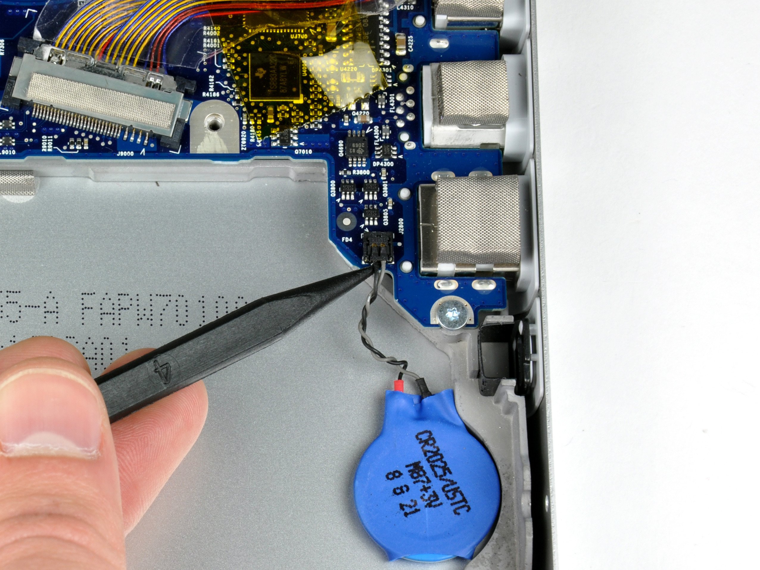

Maybe the PRAM battery is dead (quite likely after 16 years). It might boot if you disconnect it.
If it still doesn't boot, try resetting the SMC.
