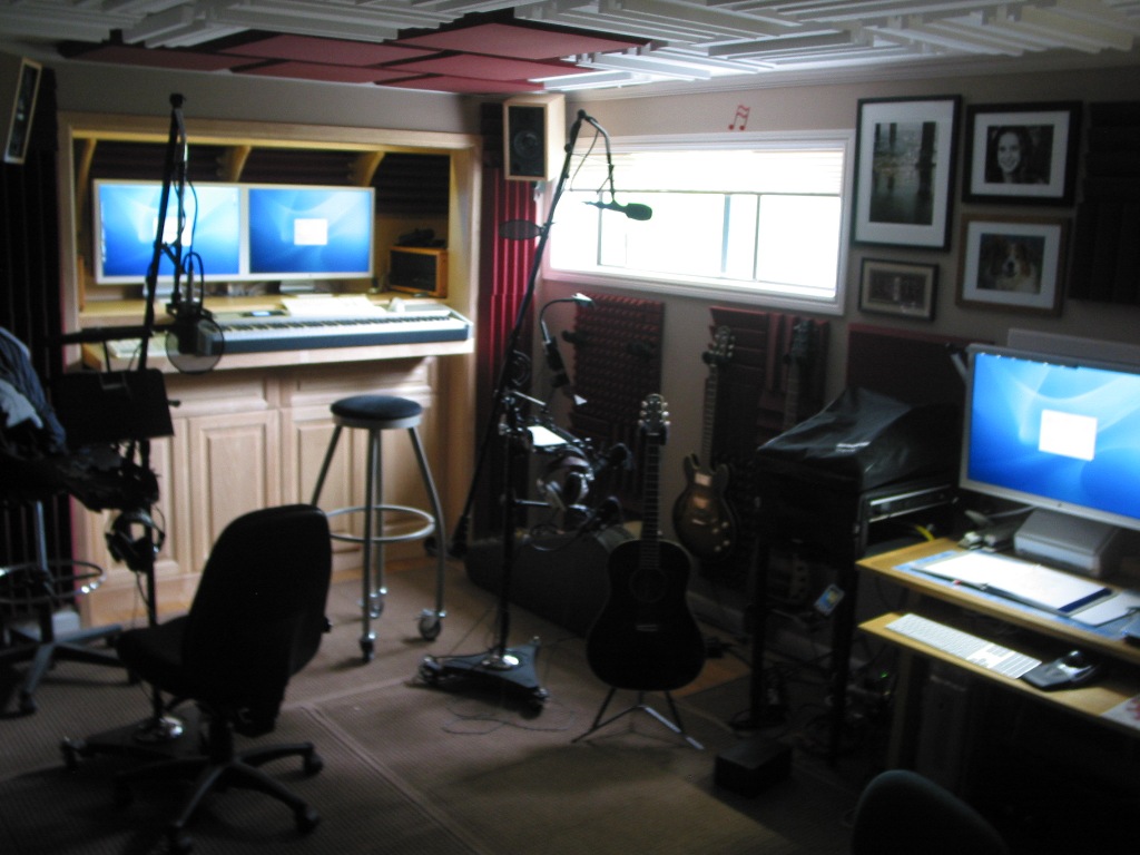

Hopefully, you can see in the attached photo that two displays sit together, and one is on its own on another desk.
Now, back to the question of arranging them so that two are extended (the two together), and one (as it sits by itself separate from them) as a mirror.
