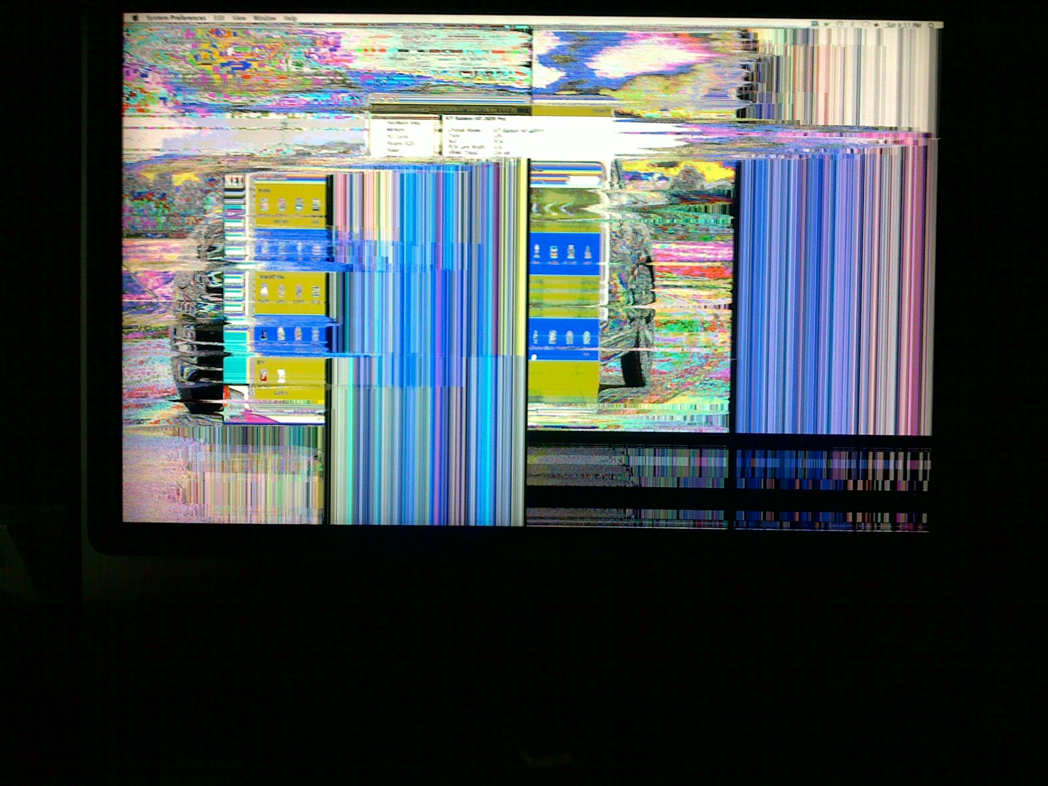

Hers is a pic of the screen

Nifty colours. Does it do that in Safe Boot as well?
Why thank you!
Yes, it does it in every mode there is 😡
As soon as the display lights there are bars through the boot process, the Apple logo is centered with white ghosts on either side of the screen. When I mentioned resoldered what I meant was sending the card out to be "reflowed". I found at least 2 companies that do this for around $90. They offer a 90 day warranty and a wonderful list of disclaimers lol.
I don't think a reflow will fix that card. That could also be a bad video cable or LCD, but very unlikely.
I guess I'll work up the nerve and start tearing her down tonight, looking for easy fixes along the way... It would be nice if I would find a loose cable or something.
