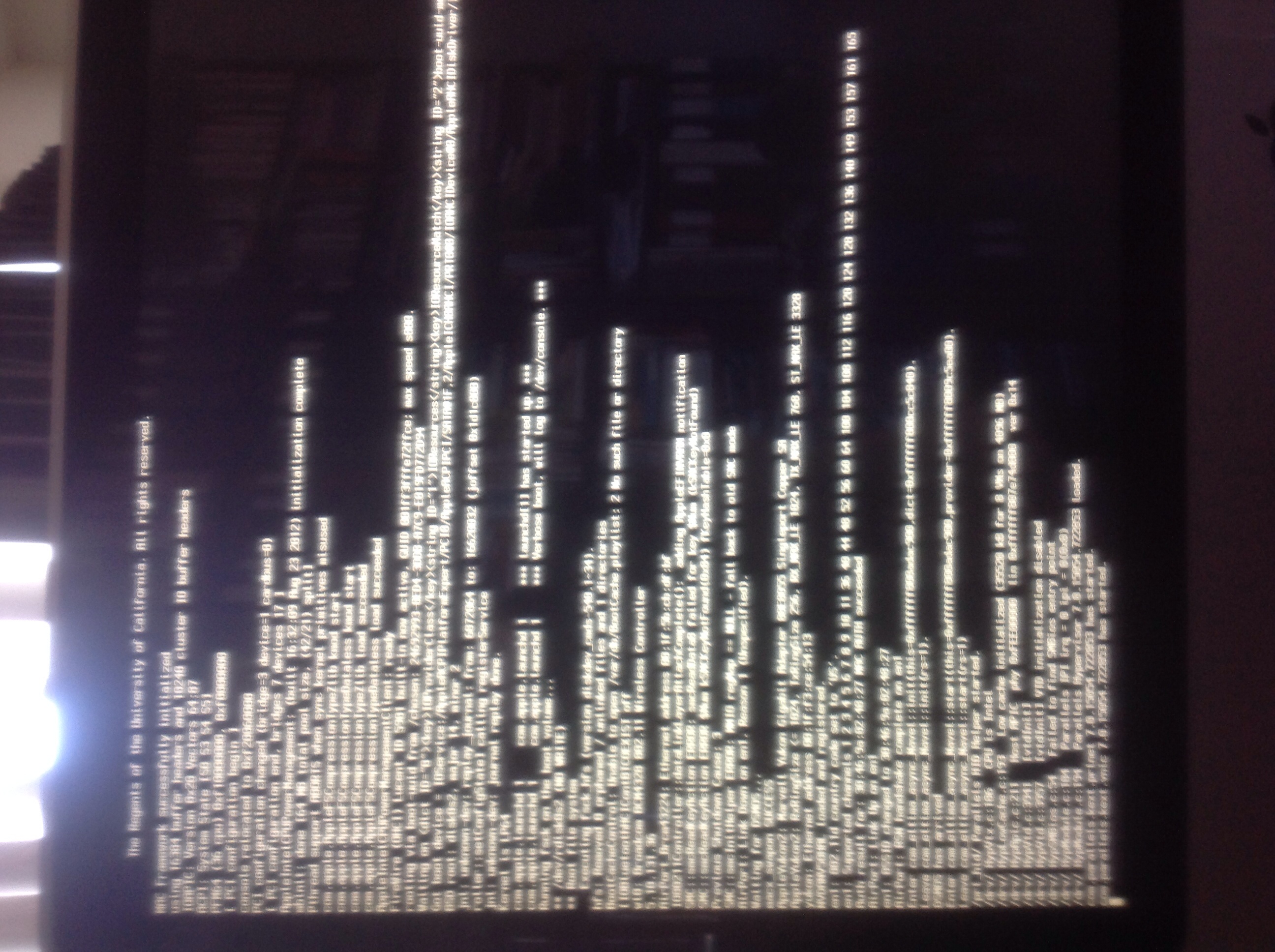

AHT - no trouble but. got this reading on verbose mode
I tried starting it from the install disks- no go. So tried safe Boot -command, shft V and got this message - in attachment.
What does this mean?

If you have nvidia graphics (8600GT) that might be your issue. But I would verify see if you get any errors with ram.
I have the 8800 GT nvidia. The Hardware test showed no problems. How do I check the RAM? It's the original installed from Apple.
