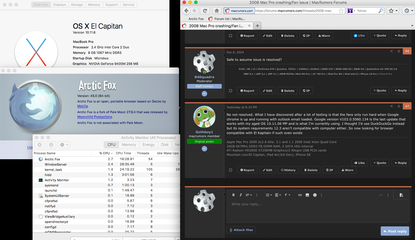

For my late 2008 MacBook Pro, I run Arctic Fox with no issues in El Cap. It is a currently supported open source project that has quite a few users here on MacRumors that also enjoy using it.
Arctic Fox
There are other options as discussed in the Early Intel Mac thread.
Early Intel Browser Thread
