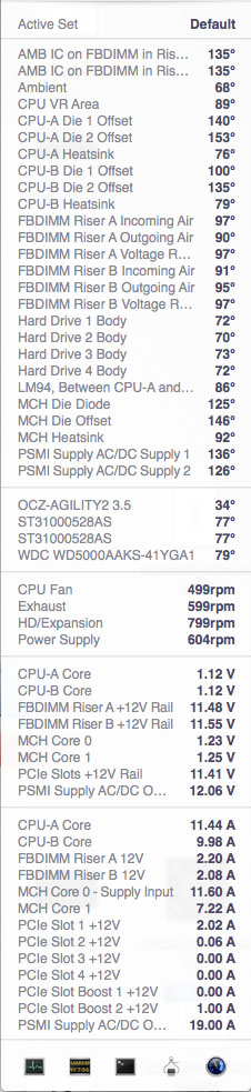

Also attached is a temperature log. The mac has been running for about 10 minutes. If someone could look at this and see if there is some temp that looks out of place.
Thanks.
I think they look ok, I'm used to degrees C so someone else might notice something. Have a look at http://support.apple.com/kb/ht1237 and check you've got the latest firmware. Back everything up while you can!
