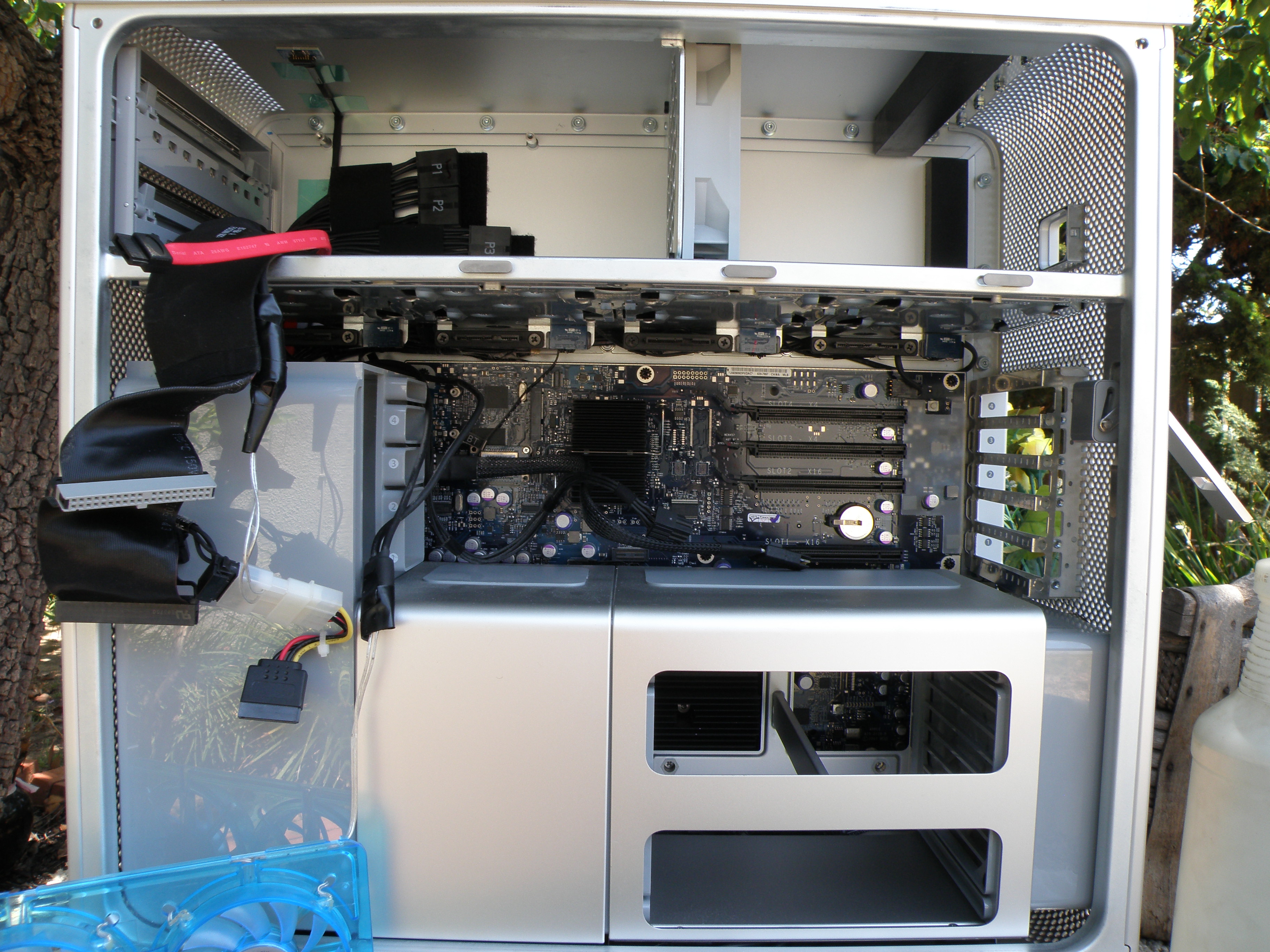

Please, someone tell me it isn't what I think it is.
Don't know what you think it is but if it includes the letters PSU, here is a route to take:
1. Take it out and give it a good shot of air.
2. Blow the rest of the MP out while it's open (including ram slots)
3. http://www.macpartsonline.com/661-4...-mac-pro-2-8-3-0-3-2ghz-early-2008-a1186.html
4. http://www.dvwarehouse.com/661-4677...ac-Pro-Early-2008-614-0409---NEW-p-35735.html
5. https://www.ifixit.com/Guide/Mac+Pro+First+Generation+Power+Supply+Unit+Replacement/32222
