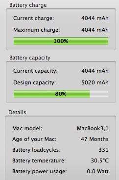

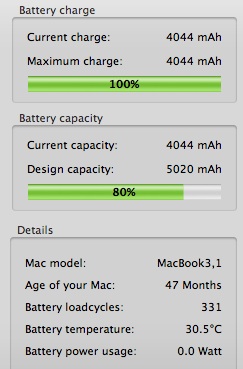

It looks like the bat to me but why?
The battery is in pretty poor condition - 80% capacity
What you really need to do is calibrate the battery - pull the charger out and let the MacBook battery run all the way down till you get the "running on reserve power" warning and then charge the battery back up to full charge again.
Repeat this and then have a look at the Coconut battery stats - they will probably be different.
A MacBook should sleep with battery power only for days and certainly not hours. From your earlier posts it sounds as if the battery will lose charge even with the MacBook switched off.
It may well be time for a new battery.....
