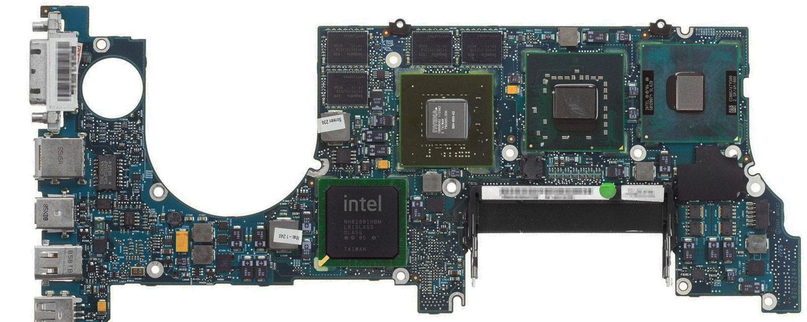

If, when you open the “trapdoor“ (round here, we just call these the “aluminium MacBook Pro”) and look at the RAM bridge (which typically has a factory label with the logic board serial number and a bar code), if you do not see a green-dot sticker which was added to the RAM bridge manually, then you have a unit with the non-revised version of the Nvidia 8600M GT GPU which had a design flaw, invoking failure. These units will have “G84-602-A2” inscribed on the GPU chip itself.
Nvidia corrected their mistake mid-stream during the production cycle of when the early 2008 MacBook Pros were still on sale (and late units have the updated GPU direct from original manufacture), whereas affected units were eligible by Apple to have the revised GPU swapped in. These factory/manufacturer/Apple-authorized units were affixed with the aforementioned “green dot”. On the revised version, the Nvidia GPU chip itself will have “G84-603-A2” on it. Here’s an example:

Is this an Early-2008 pre-Unibody model, or a Late-2008 Unibody version? If the latter, it is most likely not turning on due to failed C7771, a common issue on these. I have a video about that here (both 2009 17” and Late-2008 15” have the same issue). If it’s an Early-2008 pre-Unibody, it’s most likely a bad GPU, as @B S Magnet said.
It's a late 2008 unibody, based on the power pad location
