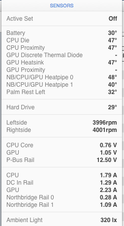

After replacing the dreaded 8600M GT GPU on the logic board for my 2008 MBP 4,1 it seems as though the fans on this machine are ungoverned. I say that as they don't seem to want to stay below maximum speed for some reason unless I run Macs Fan Control or smcFanControl or something along those lines.
I know these have a reputation for running hot, but with the replaced GPU and decent thermal paste (Corsair) I would believe it to not run the fans full bore all the time. dosdude1 also did the GPU replacement and I trust that all is well physically with the board, his work looked to be neat and tidy.
Does anyone have a screenshot of what their machines temp sensors look like (via iStat menus or something) to show that I have all the sensors connected?

Edit: For what it's worth, here is the sensor list for my MacBook Pro, taken from a screenshot of iStat Menus 5; however I've realized I have a 3,1, not a 4,1 as I originally thought.

The fan located on the side with the GeForce 8600M GT will need — regardless the version of the OS you choose — to run higher than the other side (where the CPU is situated). This is a consequence of the GPU running a lot hotter, even for more ordinary tasks, than the CPU. I’ve come to accept this as a limitation of the internal design and the efficiency issues with the 8600M GT (which, I suss, were rectified by the time of the 9600M GT GPUs used for the successor-unibody models).
On Macs Fan Control, since replacing the OEM logic board with a green-dot version for my MBP4,1, I’ve set the left fan — the one proximal to the GPU — to 50°C minimum and 68°C maximum; the right fan — proximal to the CPU — is set with 55°C and 65°C. If you wanted to keep the fans from maxing out as often, you could increase the max temp setting whilst leaving the min setting alone (I’d try to keep them beneath 70°C, regardless). But that’s about the best you’ll be able to do, given all other limitations of this series.
This ought to give you usability without both fans needing to be pegged at max constantly.
Thank you both of you. Programmed the sensor values in and its behaving a lot better now.
