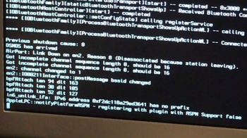

Boot in verbose mode. What is the last few lines of text before the computer spontaneously reboots? There is often a clue right there. Not always, but worth a try.

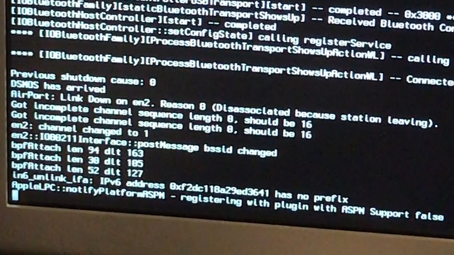

The last few lines of verbose before restarting
