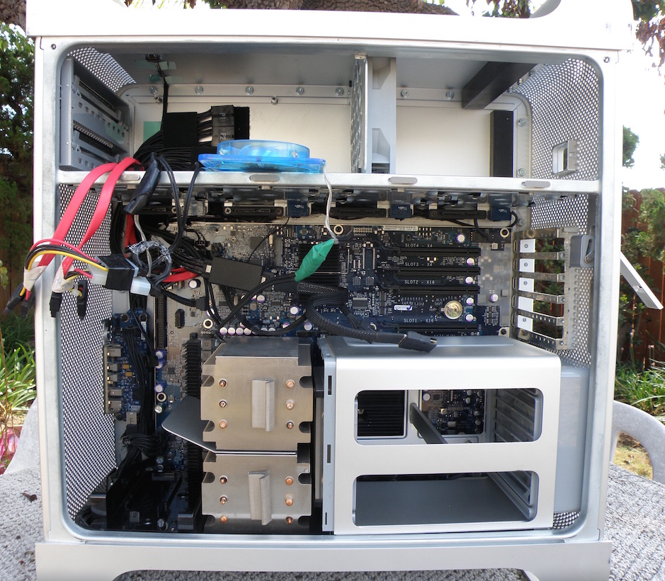

I will probably get suspended for posting this pic again. 😛 A free shot is to remove it and blow it out.
https://www.ifixit.com/Guide/Mac+Pro+First+Generation+Power+Supply+Unit+Replacement/32222

I still don't think it is humanly possible to get a 2008 that clean. Shenanigans!
When I got mine, I had to take it outside, get a leaf blower, and blow this giant cloud of dust out from both sides. It was so big you wouldn't believe it. Afterwards, I brought it back inside and wet paper-toweled everything, including sticking a rubbing alcohol'd Q-tip in between the GPU fan fins. Been mostly working like a charm ever since.

You know, after blowing the dust out of the case it looks almost as clean as the OS6-OSX machine.

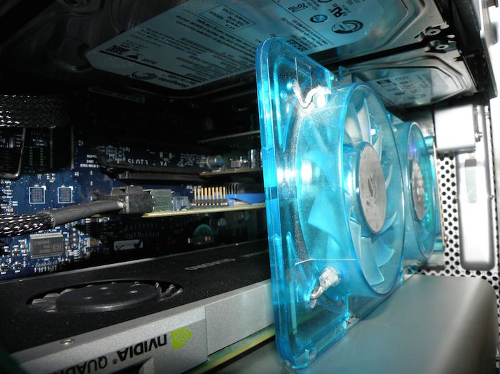

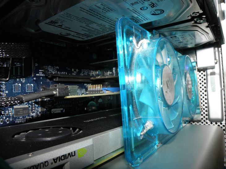

Is the blue thing in the disc drive bay a PCIe fan? Where did you get it?
Cool. Do you find it quite useful?
Did this years ago when I was running a 8800gt. If you know about the heat issues (soldering) you can see how it kept it cooler! It never failed during the years of use. Since two enemies of electronics are heat and dust I kept using the fan in addition to the MP's. The Quadro 4000 is known for running hot so the Vantec is Vantastic! How's that for a 50's commercial! 😛
