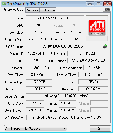

Here is the ROM file...
Hi Cindori,
Have attached the ROM file (R700.zip) for you.
I used GPU-Z 0.28.
It lists the 4870x2 twice so I'm assuming the rom file is identical for both GPU's...
Cheers,
