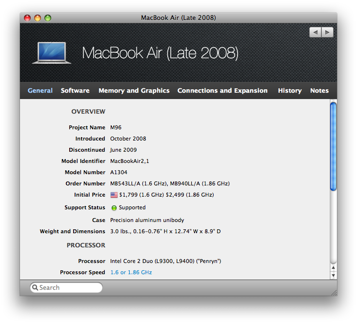

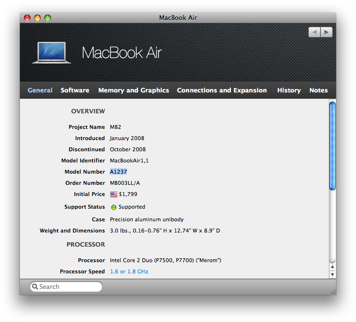

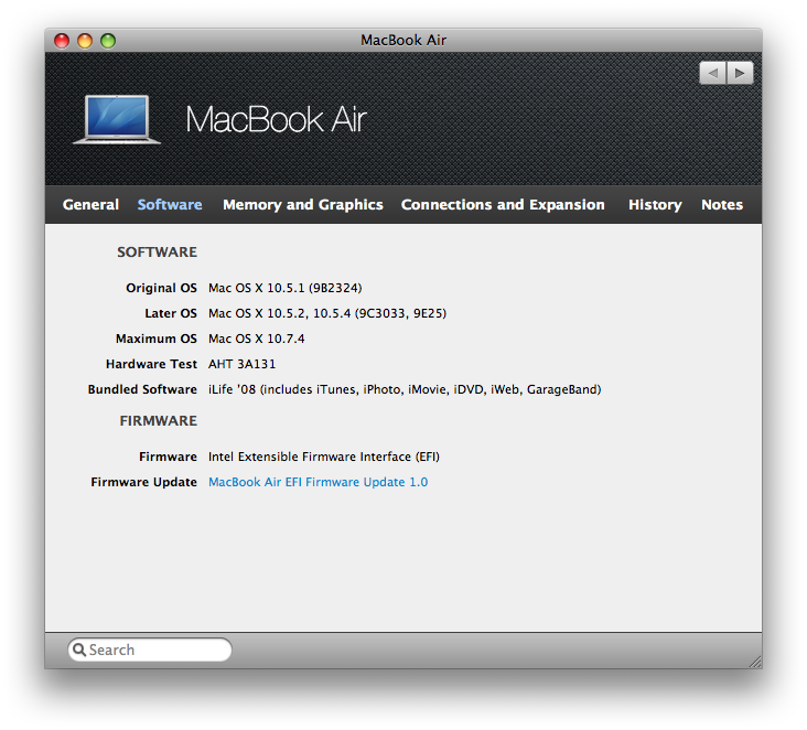

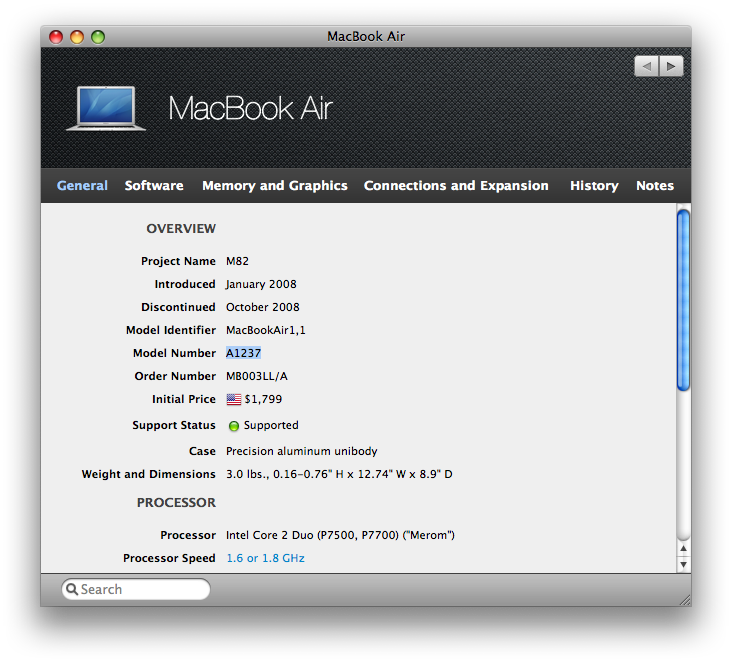

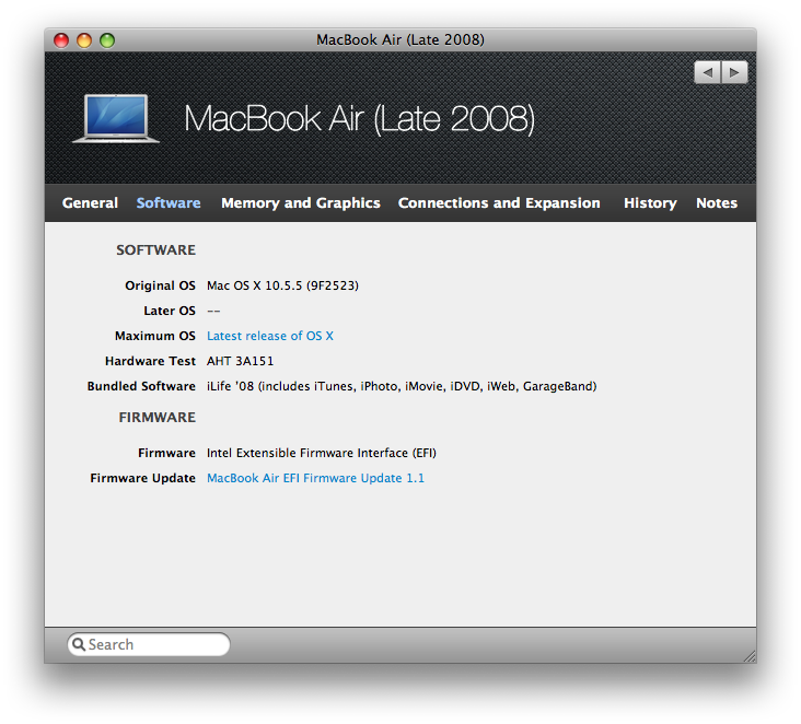

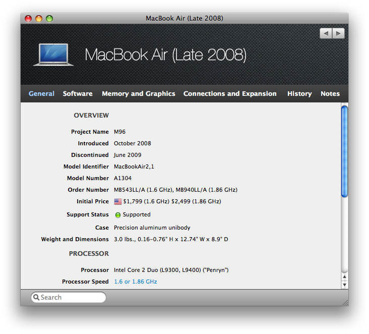

Hold the Option key when you start up, do you get a screen with choices like recovery, internet recovery, repair?
If so you select internet recovery, connect the external and install an OS on it.
Yours is an early MBA and can not run 10.8, the late 2008 CAN.

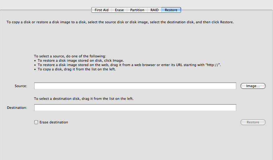

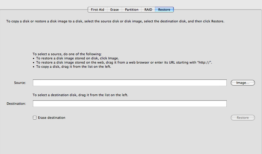

Choose restore in Disk Utility, then click on image, choose the image and in the second box add the USB as target.

Doing that now. but I get " Unable to scan MAC OS X Install ESD (Resource Busy).
[Edit] - Actually, it's a Lion 10.7.3 *.DMG file and this is our only option now, as we don't have an external USB DVD drive.
I've burnt that DMG file to a blank DVD using my MBP, is there way I can map to that to do the install?
Ok, I did a few unmounts & remounts and it seems to be creating the USB installer now....

iFixit, change HD on MBA 2008
They say this here:
The two different versions of MacBook Air have different hard drive connectors. Failure to perform the action appropriate to your machine will damage your hard drive! Be very careful when disconnecting the hard drive cable. The ZIF connectors are fragile.
