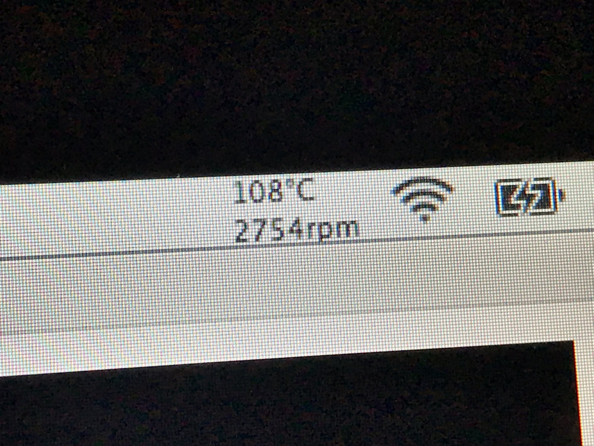

Ok, quick update. While tinkering with the machine I installed a game - I'm not a gamer, I was just curious. During the game the fans sped up to max power and temps were around 80 degrees.
So it seems that everything works as designed and that for Apple it's ok that the CPU die reaches 104 degrees if the GPU is not running as well?
Allow me to doubt Apple's expertise on this decision - the fan only slightly spins up around 108 degrees C. Madness.
BTW this is not a CPU test, this is an actual software rendering a video.

It should throttle before it gets that hot, regardless of fan speed. I don't know if it's possible to get around that, so I'd suspect a reporting error.
I didn’t check yesterday but I believe it does throttle - and that’s why it doesn’t rise any further than that.
how can you check if a CPU is throttling on a Mac? What software would you suggest?
Edit: I couldn't use Intel power gadget as it doesn't work on my CPU and I couldn't find an older version.
I then run pmset -g thermlog on terminal. The speed limit stayed at 100 despite CPU temperature reaching 108 degrees C...
Which is why I suspect a reporting error. But I don't know where the reports for the software you mention come from, or how to check them.
I'm just guessing: isn't the throttling 'decided' by the CPU itself? I mean, there's is no OS and no software involved I suppose.
As far as I know, the 100C limit isn't something that can be overridden by users, including with software written to help control throttling.
Speaking of which, I suppose it's possible something has changed or corrupted the fan speed control. I think that much can be controlled with software. But you should still get throttling soon enough to prevent 108.
Bear in mind that I have wiped the disk so if it’s software it’s either something that wrote into a firmware or it’s a firmware corruption? I don’t know, I feel it’s so unlikely!
