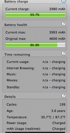

Is there someone who knows why Apple used only 50WH instead 60WH batteries?
Because with lion, I'm getting about 1-2h on battery (voltage = 11V currency = 4 Ah ----> capacity = 44Wh ) --> Average power usage is around 25-45W (!! What is taking SO much, running 9400M!), only Safari &*Lion running 🙁 (flash disabled). SMC reset done, PRAM done, battery format done.

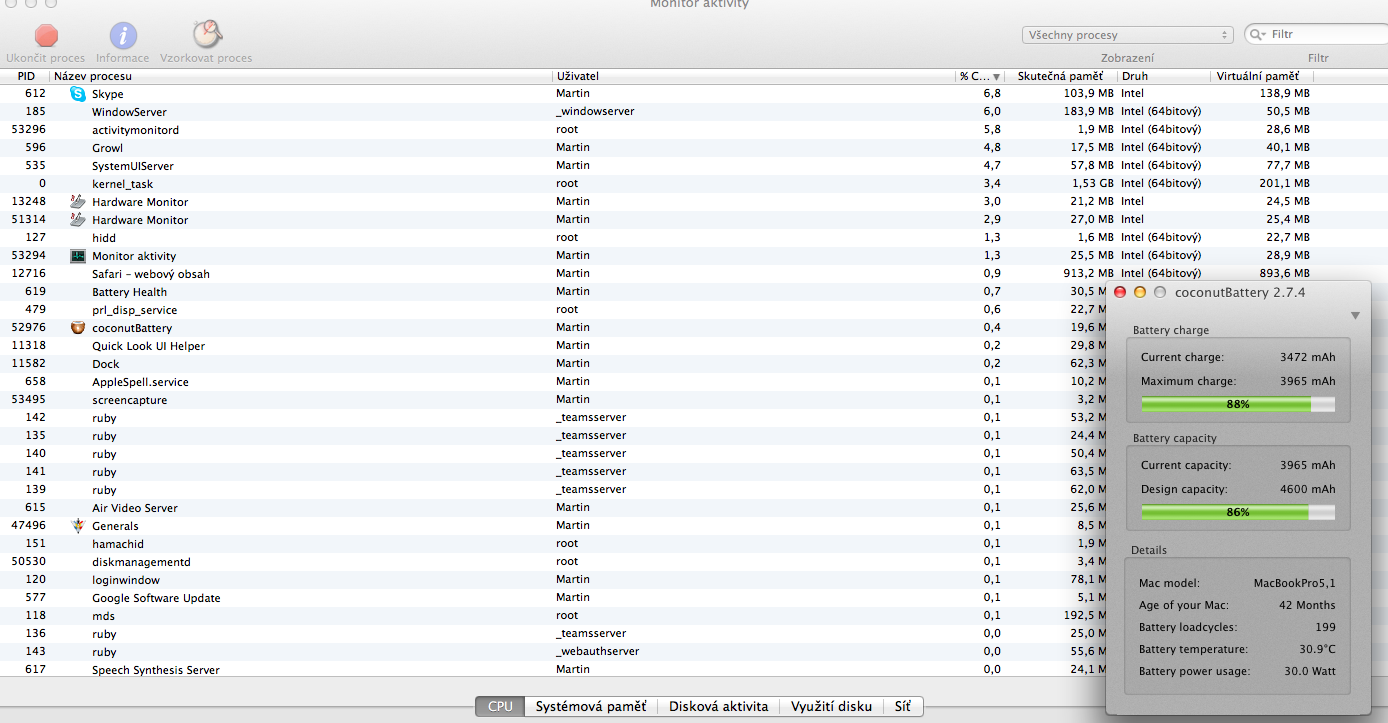

CPU usage ~5-15% usually, right now on AC with Handbrake converting, so I can't make screenshot of Act. Mon. 😉

199 cycles for 3.5 years is really low. Do you not use the laptop often or is it always plugged in? I ask because coconut battery is likely wrong and the battery may need to be calibrated (This will not improve battery life just improve accuracy of estimated time remaining).

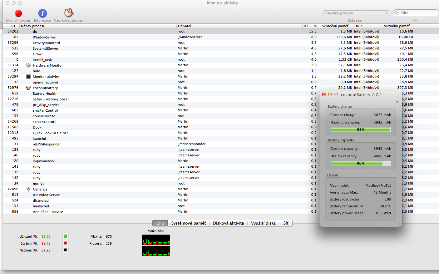

Watching TV, CPU usage 40% now, 1:30 h , power usage about 30W
Edit: Screen: It is in Czech but I hope that you understand values in it 😉

When i quit EVERYTHING, I am about 5% and two hours - that's also okay? I'll post screen later..
Fans running @ 4K RPM, 80 °C CPU
Tried battery recalibration before 4 hours.. and SMC reset too..
Screen without TV & Parallels: Battery reports estimated time: 1:23h 😡
Display at minimal (1 square) settings)

My tip is thermal compound on CPU (it's old) (recently I cleaned fans from dust and it didn't help much).. Is something else possible?

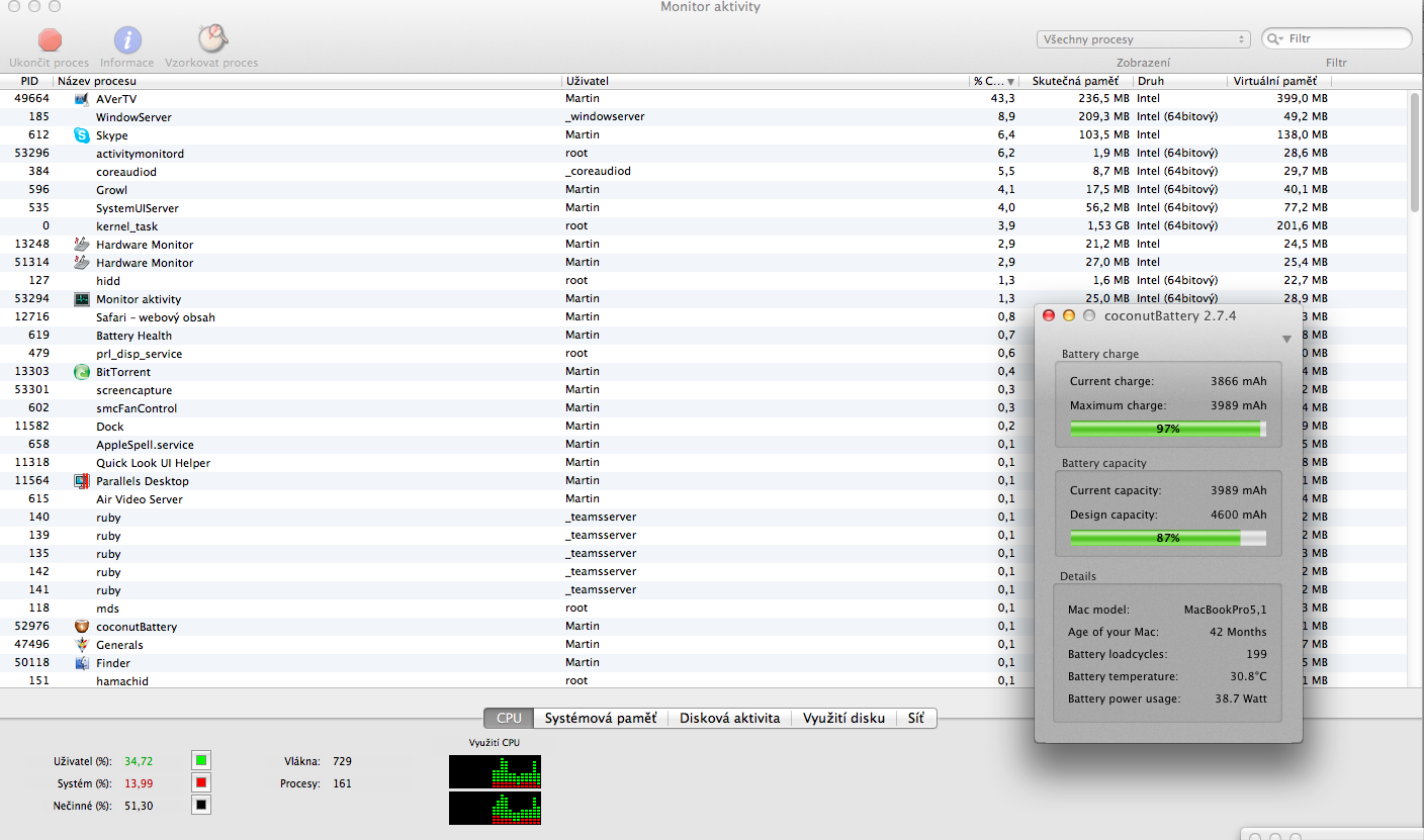

You're using Skype, which sucks a lot of battery power. Have you tried quitting Skype and seeing what the estimated battery time remaining is?
Also keep in mind, the estimated battery time remaining is just that..an estimate. It's a snapshot based on your current power usage. As you use or quit apps, it constantly changes. Have you tried actually letting the battery run out, to see how long it actually lasts?
You might want to try istat instead of Coconut Battery. I seem to remember some people here posting about some inaccuracies in Coconut Battery. http://www.islayer.com/apps/istatpro/
Thats why. Why are your fans running so high? I see you have SMCFan control installed..
If that measurement was taken with Skype running, I would think that's why the fans are so high. I believe Skype uses the discrete graphics card (assuming OP has a 15" MBP).

Battery re-calibration done, +10 minutes received 😉 power usage still 23W in idle 🙁 Could someone take a look on activity monitor? ( It's Lion Server )
Looks like WindowServer and SystemUIServer are having "memory usage spikes". (CPU from ~3% -> 17% and back)
