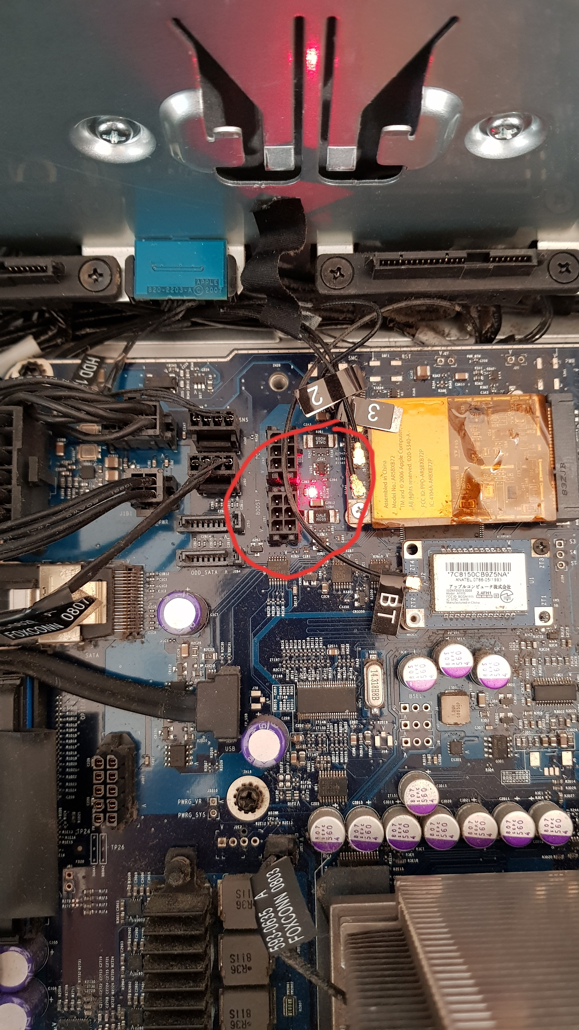

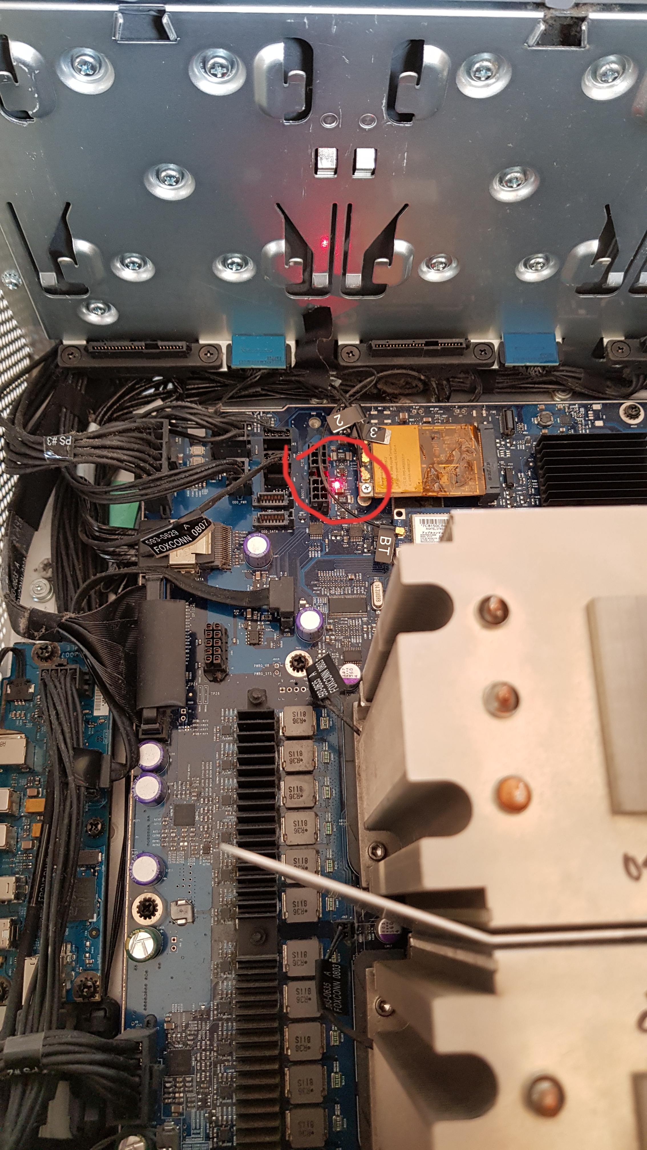

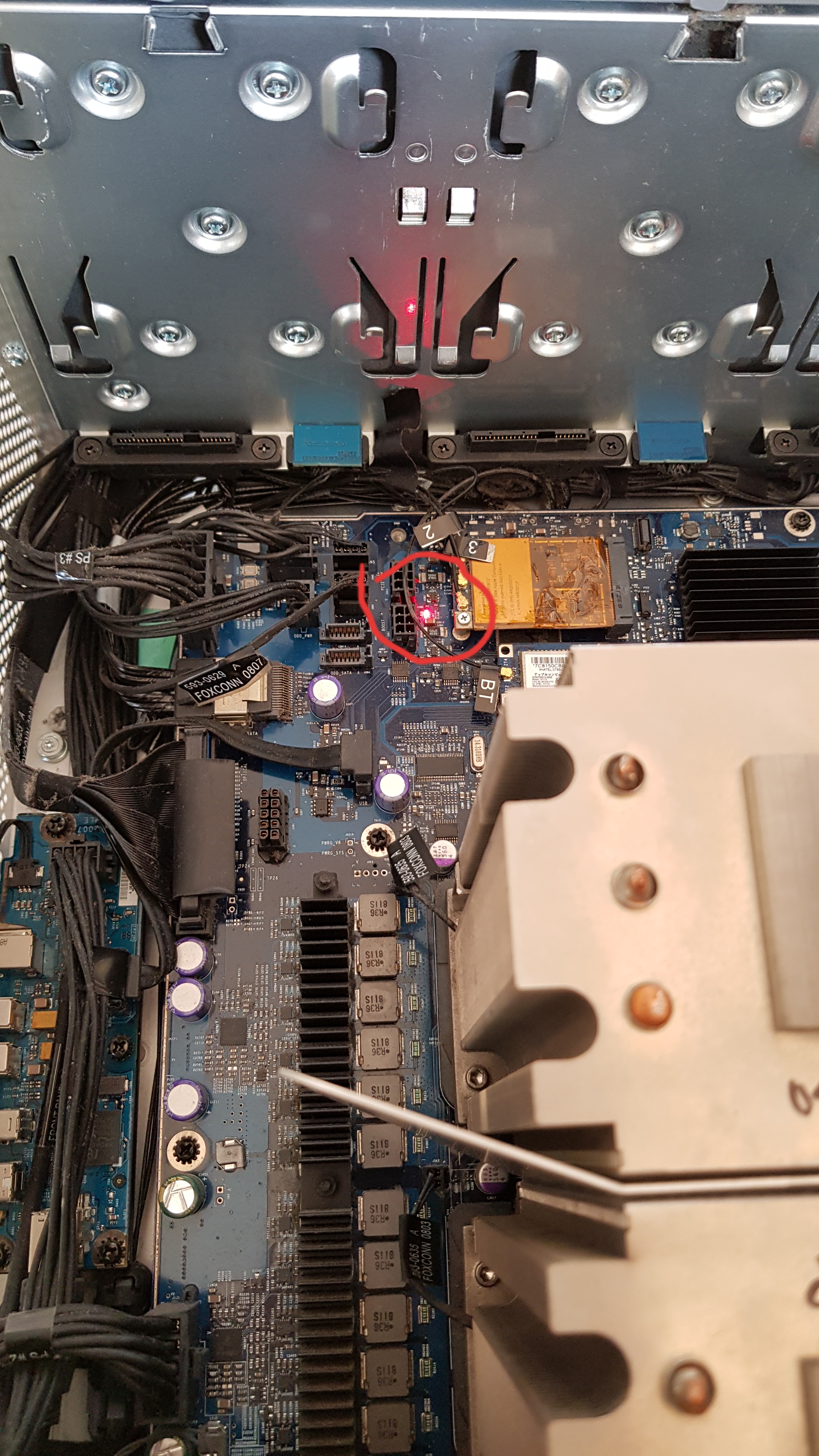

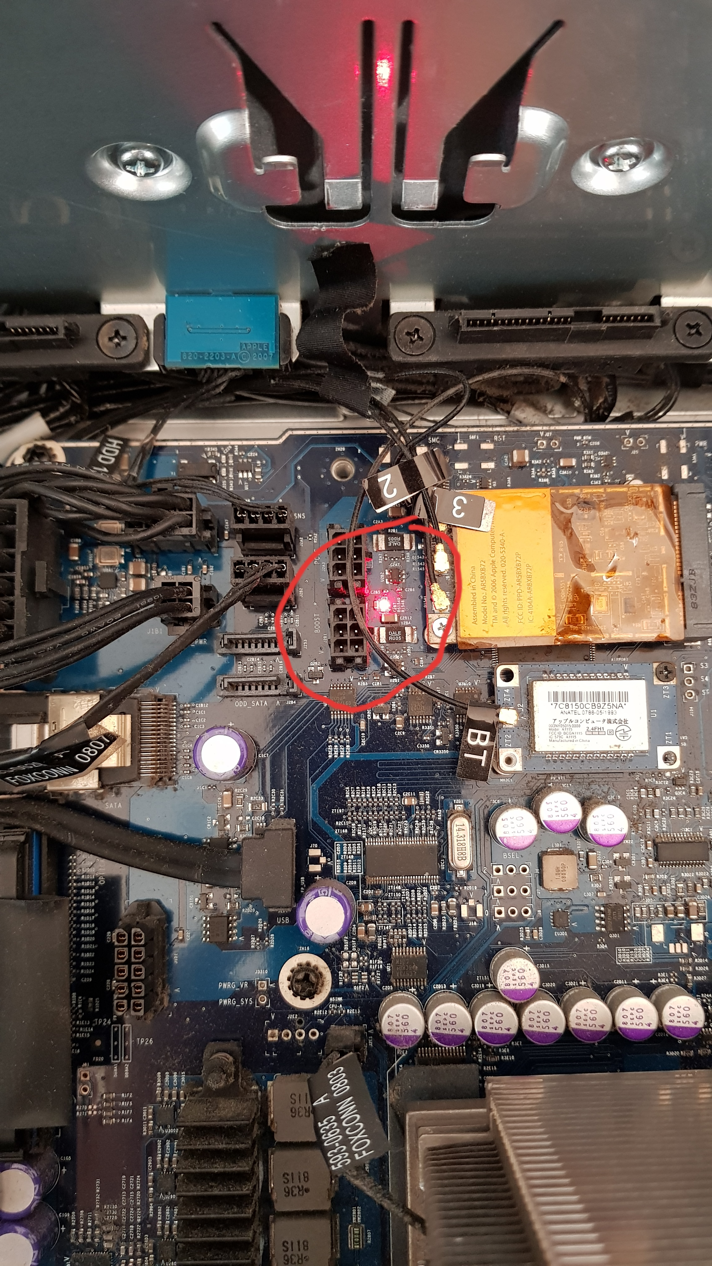

But i notice one problem from begining is a red led open on the motherboard and i know from other mac pro machines 1.1 or 2.1 or even 5.1 when machine run well all leds must be off. But in this machine when i plug power
cable that red led start to be on and never go off. Position for thet red led is between wifi and bluetooth ( see pictures i uploud with red led position). I am confused why that led start to be on when power go in motherboard
I never seen any red led on in other mac pro machines, when i plug power cord, even if computer is off, before i press start button that red run when i plug power cord in machine. From my experience that led can be a issue from
two reasons. First can be a issue from one or both processors or second can be from power supply issue because look to be in connection with power if start to be on when is power in motherboard.
