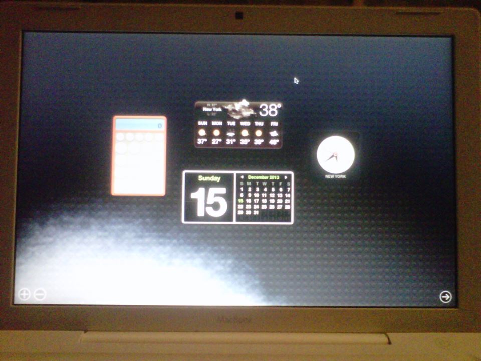

One question, which probably has no solution except a new LCD is... Theres a weird "bleached/ghosting/bright" spot on the bottom left corner which takes up a good 20% of the screen. You can see everything fine it's just VERY washed out/ghosted/bleached looking, hard to explain. Is this from it being dropped, someone pressing on the screen, magnetic field for a prolonged time before I bought it, or something else I can't imagine? Thanks for everyones help, you've all been incredibly nice!

As for your LCD issue, I've seen that before on older LCDs. You get a blob that looks washed out or sometimes dingy. It reminds me of the older monitors where you could mess up the screen with a magnet. Obviously LCDs don't have that issue with magnets... But I just write it off to old age. Maybe it is a hot component on the other side of the screen aging the area.
Old age LCD. You can prove that the case by plugging in an external monitor and verifying the image is perfect on the external.

Not sure if you can see the pictures all that well, Blackberry phones have a really bad camera.
