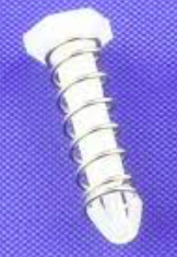

I hope those replacement Northbridge heatsink fasteners are real push pins with the appropriate pressure .
The replacements should look similar to this , they are spring loaded . Do not use bolts , nuts , rivets , etc .
Yup, pretty close down to the color!

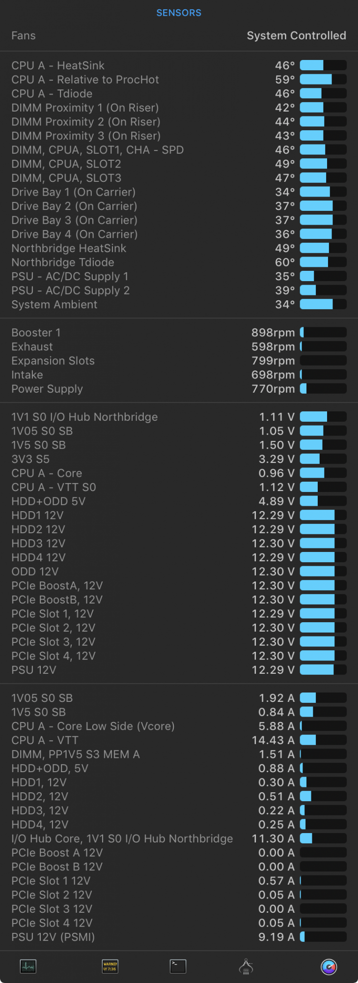

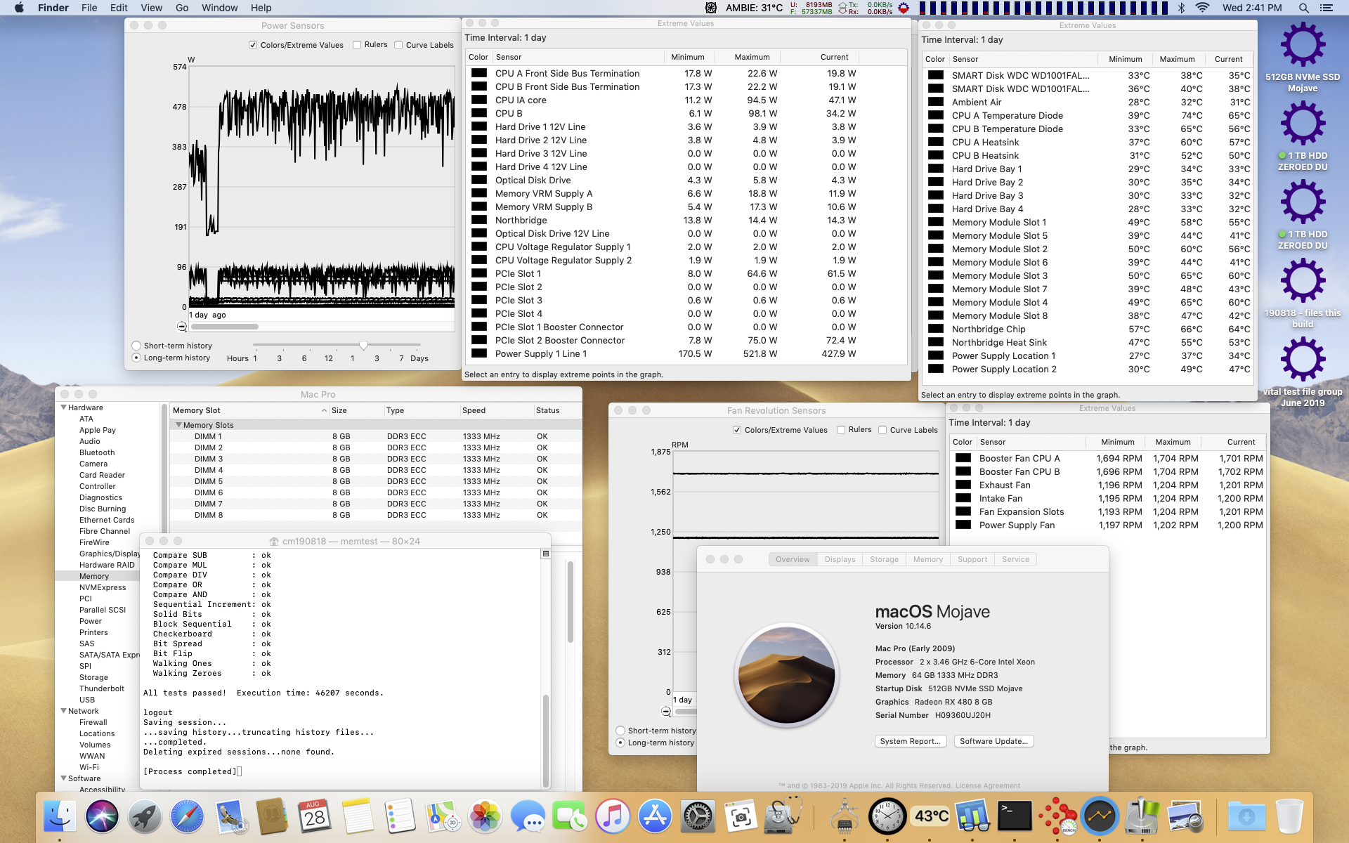

OP : Here are the thermals of a properly rebuilt Dual X5690 at continuous System load .
The difference between CPU A chip and CPU A heatsink = 8 degree C .
The difference between CPU B chip and CPU B heatsink = 6 degree C .
The use of MFC is highly recommended with this configuration .
The difference in temps between your CPU chip and CPU heatsink is too great .
Get it down as low as possible to improve the durability of your System .

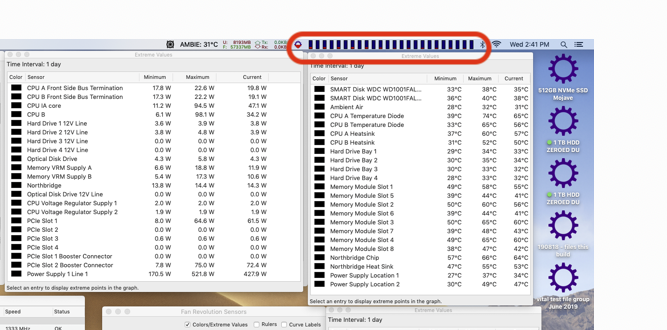

For my System , MFC settings are shown in the fan window info in the picture below . 1700 RPMs for both the CPU boosters and 1200 RPM for everything else . But fan settings are customized for every System and this might not work for you .

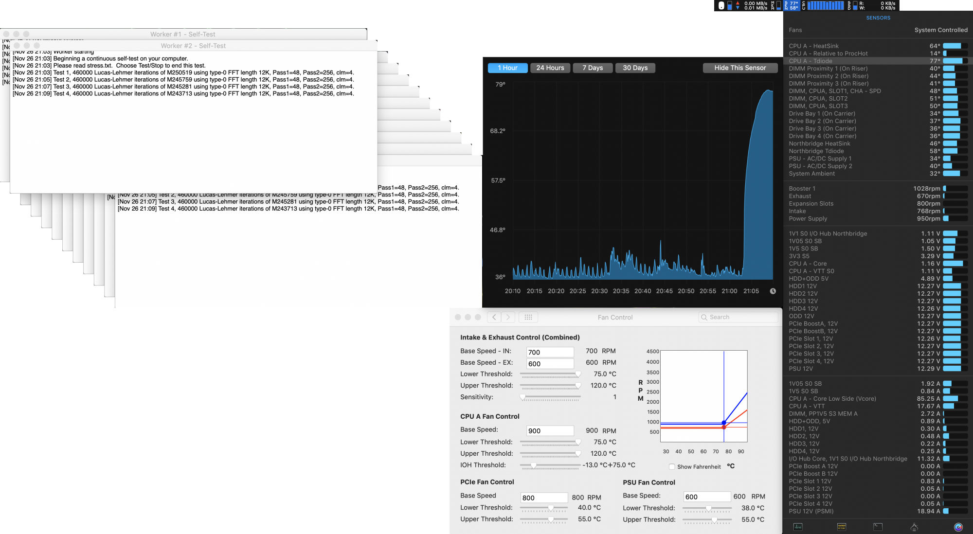

This was captured DURING stress test (prime95) on my own cMP, as you can see, the CPU A was drawing 85.25A, that's about 99W.
And the temperature difference between diode and heatsink was 13°C, pretty much the same as your max difference captures. Of course, I am with a single processor cMP, therefore, no need to spin up the fans that much.

Oh no no no !
Look only at the current temps ( and other sensors ) being reported by Hardware Monitor , please . Those are the only ones usable for such a determination .
The minimum and maximum sensor ( not just thermal ) readings are all individual readings taken at many , separate times . They are not connected to each other . They don't represent a single snapshot in time ( which is required for such a determination ) .
Those are the absolute , individual extremes of each sensor reading during the long stress test ( 24 hours , usually ) . The time interval for the reporting was set at 1 Day .
There never was a 13 or 14 degree C difference between a CPU chip and a CPU Heatsink . I check these figures occasionally throughout the entire burn in and would have gone nuts had this been true .

Oh no no no !
That's exactly what I want to point out, you use the "current temperature" at the WRONG time.
If you want to use current temperature, please capture that DURING stress test, but not AFTER the stress test.
It's just impossible, the max CPU A diode temperature was 74°C. That's a fact, recorded by your screen capture.
So, at the moment that CPU A diode was 74°C, what's the heatsink temperature? 60°C or lower (That 60°C not necessary happen right at the moment that the diode was at 74°C. However, the recorded max was just 60°C, not anything higher).
What's that means? the delta T was at least 14°C, cannot be anything less than that.

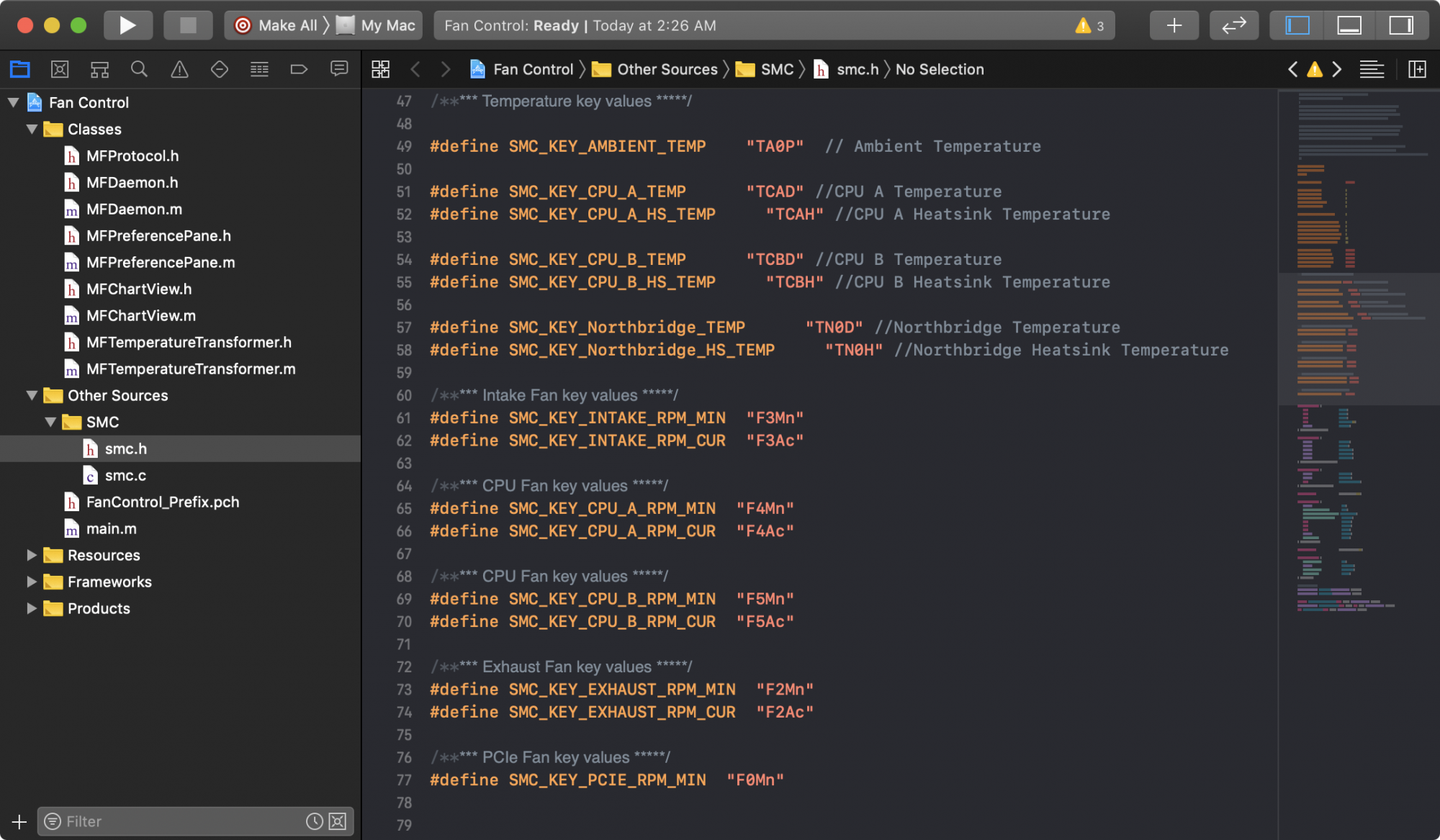

You can ask how they get that temperature. I bet that's from SMC key TCAD, guess what that mean? Temperature CPU A Diode.

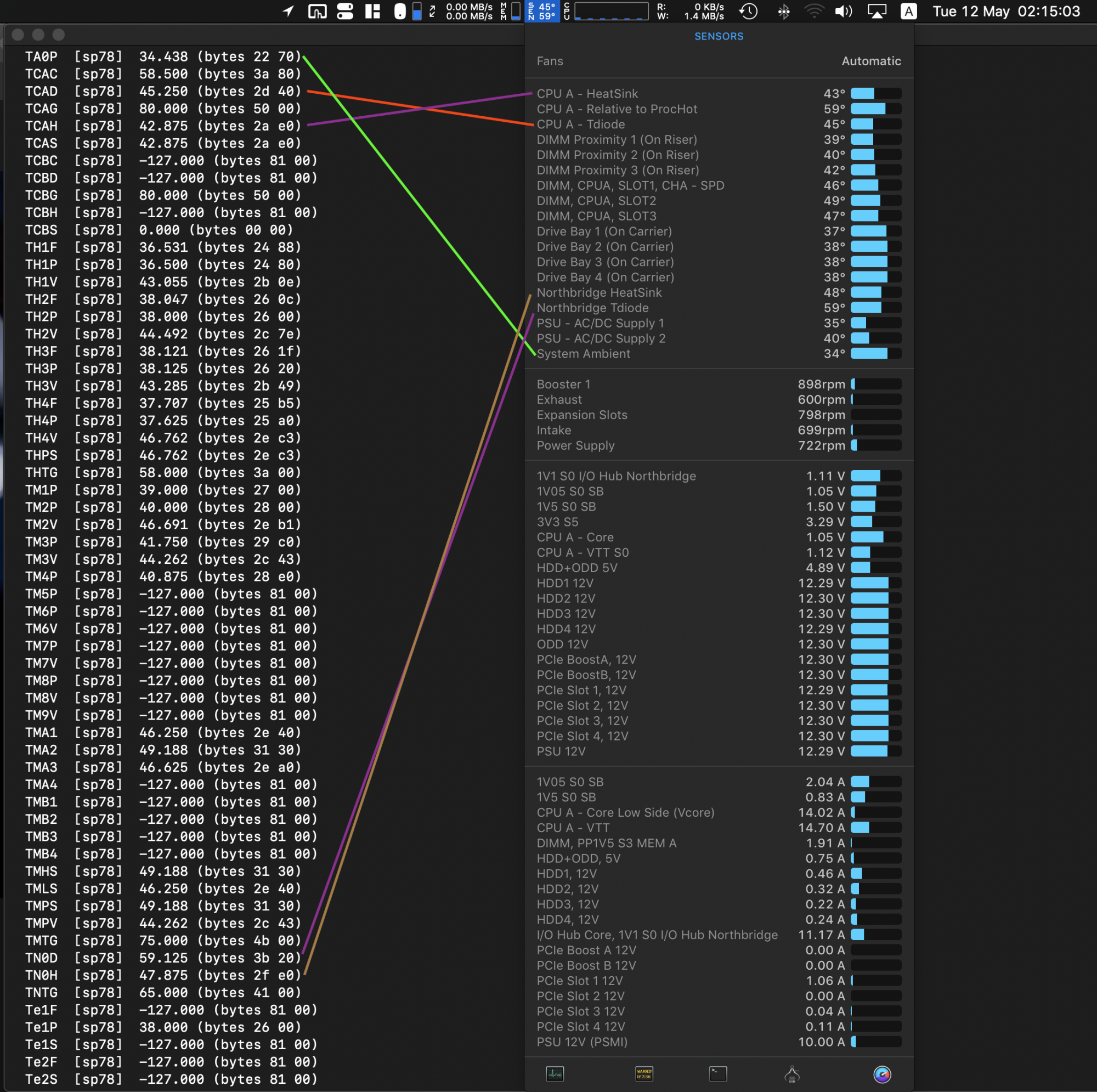

[N.B. there are few seconds difference between the SMC key values extraction and iStat menu capture. Therefore, the numbers are not identical, but close enough to see their relationship]
I know how to extract those SMC keys' value, and what they means (credit to Lobotomo Software)
By definition, T-case can't be measured on cMP. I pointed out this to you before. If you don't want to believe it, it's up to you.
And I already told you how that "above 100°C" from, it's form Intel. You don't need to believe me, please download that tool (directly from the Intel server) in windows, and run that by yourself. Then you will know that's the diode temperature. And no matter how you stress the CPU, the SMC will keep your CPU away from overheating. Remember, that tool is form Intel, the CPU manufacture.
Anyway, I have no interest to persuade you anything. you can keep believe that's the T-case temperature. Not my problem, and no danger anyway. I just want to make sure OP can receive the info from both sides, and I will let him to decide what he should do.

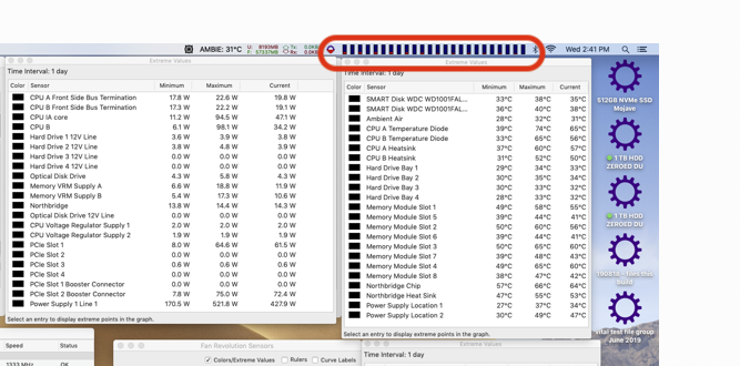

You are again incorrect .
The current temps in my screen grab were during the CPU stress test - look at the menu bar where Menumeter's 24 processor core thread thermometers clearly are all solid blue ( user ) / red ( system ) , indicating 100 percent usage of each thread . This is a 12 Core @ 3.46 GHz ( 24 threads ) System .
This machine is at 100 percent CPU load . Guaranteed . I'm surprised you didn't catch it . Don't you use Menumeters ?

Looking at the pic of Snow Tiger’s “Extreme Values” table, CPU A diode reached 74* and the heat sink never went above 60*. CPU B diode reaches 65* and the heat sink never went above 52*.
That is a difference of 14* between CPU A diode and CPU A Heat Sink. And a 13* difference between CPU B diode and CPU B heat sink. At a minimum.
That’s not a criticism, it’s just what the table shows.

No, I didn't see that, and I am not a Menumeters user, I don't even know this software exist.
Anyway, I already pointed out the reason to you. 47.1W CPU A power draw, that's under stress? Terminal said "Process Completed", that's under stress?
You can believe Menumeters, but you should NOT ignore "hints". To me, there looks like a time lag in Menumeters (1-2 second lag is very normal for this kind of software). And that capture was right after the stress test completed, not during the test. Your screen capture just not supporting what you said.
Also, why use a Memtest to stress CPU? That's simply the wrong tool. If you want to stress the CPU, use Prime95, or the Yes command, etc. Memtest is really for testing memory, not CPU, or cooling ability.
If you want to show that your CPU diode and heatsink temperature difference is only 8°C, please do EXACTLY the following.

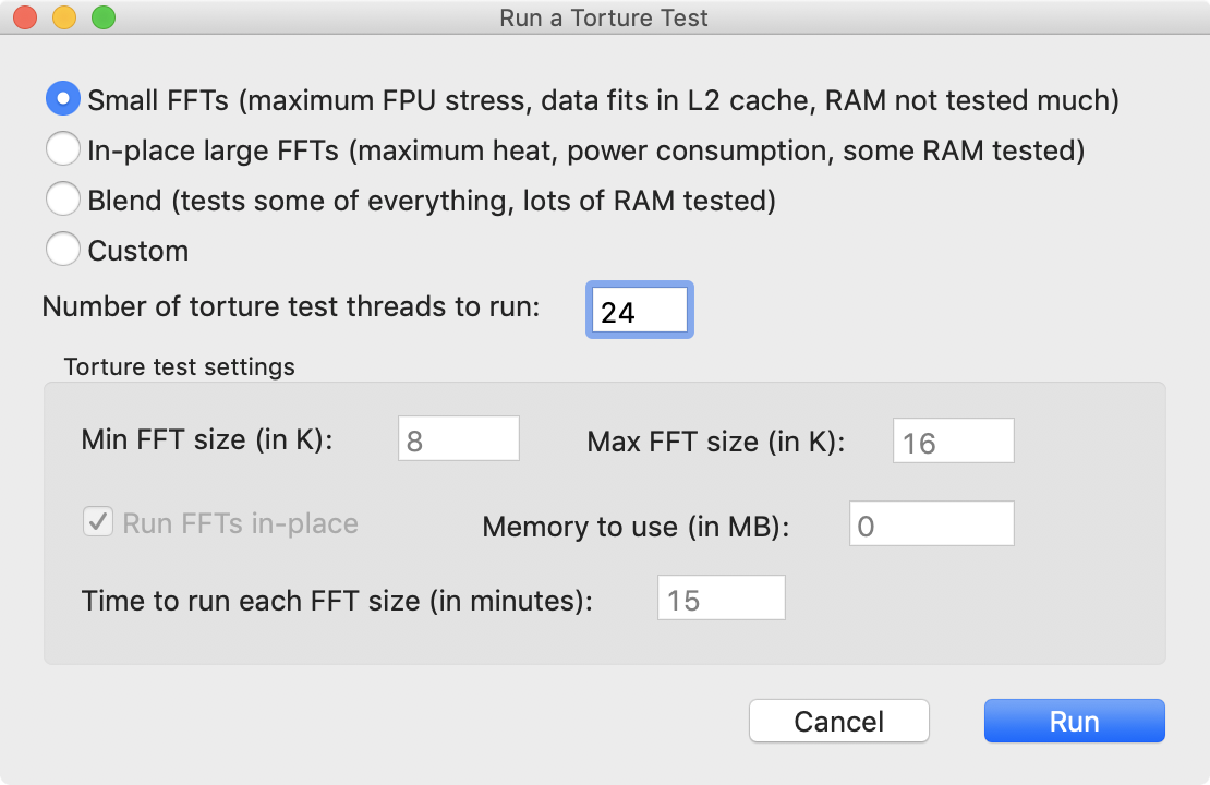

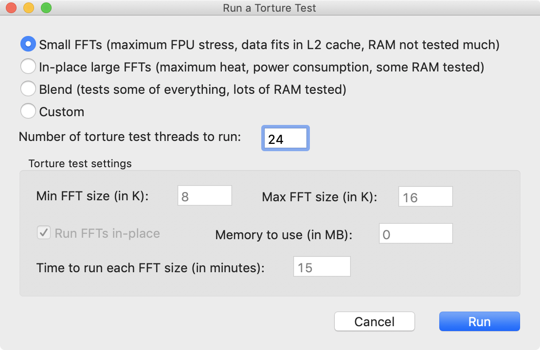

1) Boot to desktop
2) Open Hardware monitor
3) Run Prime95 Torture Test with EXACTLY this setting
4) wait for 15min
5) Capture the screen
6) Stop Prime95
Then compare the max CPU diode temperature to the max CPU heatsink temperature. And that the difference is 8°C or lower.
1) Boot to desktop
4) wait for 15min
6) Stop Prime95
You need to become familiar with Hardware Monitor to understand how it performs before you comment on it .
Sensor reports sometimes dip on occasion . I grabbed the screen as this event happened with CPU power . And I already told you that . Geesh .

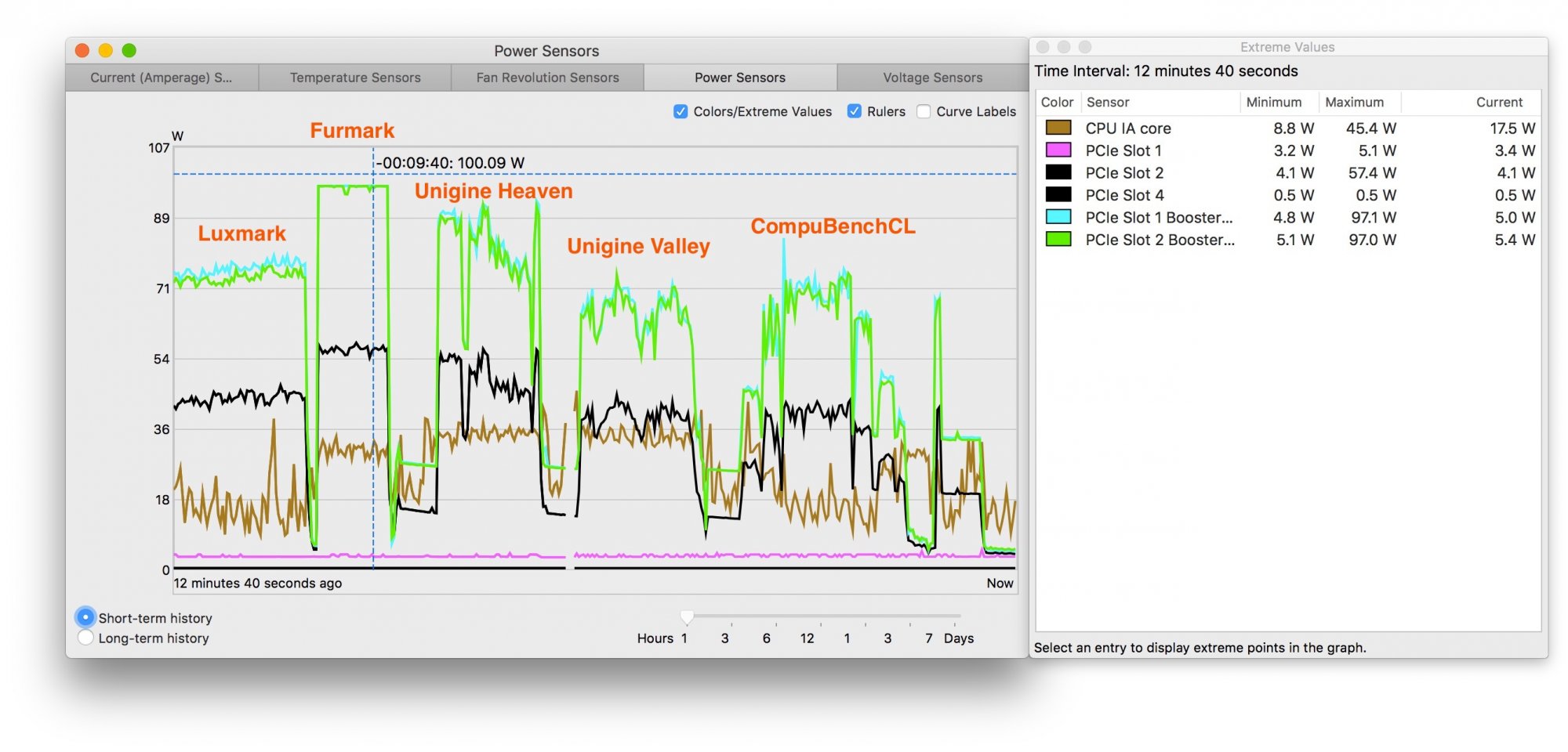

And I'm not using Memtest as a CPU stress test 😂 .
Here are the four stress tests I was using to place this macOS System continuously and concurrently under load :
Processors : Geekbench 3 .
Memory : Memtest for Mac .
Graphics Card : Luxmark 3.1 ( Open CL ) .
NVMe M.2 SSD : Aja System Test Lite .
These tests were run for a whole day . It's one hell of a suite and represents a greater degree of stress on a System than that of the workflow of professional editors .
If you want to stress the PSU, that make sense.
But if you want to run stress test for a particular component, you better do them one by one.
e.g. Run Furmark to stress the GPU, but leave the CPU idle. So that Furmark can do its work as hard as possible to stress the GPU. (I prefer Furmark for stress test, no AA, full screen, that's way more stressful than Luxmark)
If you run CPU stress test at the same time, there will be less CPU resources for the GPU driver and GPU stress test software. Which may make the software less demanding to the GPU. In other words, you are just running "high stress test" to the GPU, but not "max stress test".
This may also explain why your CPU can't stay at the max stress temperature. Because it has to give out some resource to work for the GPU / NVMe / memory test, and those are less demanding job for the CPU.
Why not use bolts and nuts? I am using bolts and nuts with the stock springs and the space between the bolt's head and the (self saving) nut exactly equal to the stock pin's length. All works perfectly fine. Only difference to the pin solution is, that it is very unlikely to break.
As far as i see, the pic shows a common pin like it has been used on many older GPUs. I wouldn't recommend these as their springs are much weaker than what is used on the cMP’s genuine northbridge heatsink pins.
