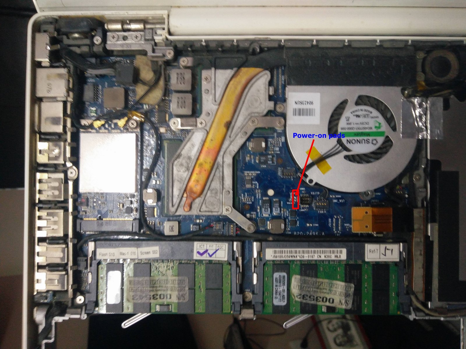

The power contacts are approximately here:
page295image12049104
I use a small screwdriver to touch (short) the two solder pads together. (Just don't go randonly poking around with a metal object. You might be "shocked" at the result
Given that you had the standard top case replacement (very common in this model), there's a possibility that the keyboard isn't properly connected to the logic board, or the top case keyboard is bad. The "shorting" solution previously posted is a great way to bypass the power button and turn on the machine.If the machine turns on but you can't type anything then the keyboard is bad.
I suspect this will actually work. Just a word of caution, I don't think that screenshot is the actual logic board (it's not red) in this model, but you want to look for two thicker solder pads like the picture posted.
Also, this will give you a chance to reseat the keyboard cable to the logic board. It might just work by doing that. Good luck!
Edit: Found a picture here

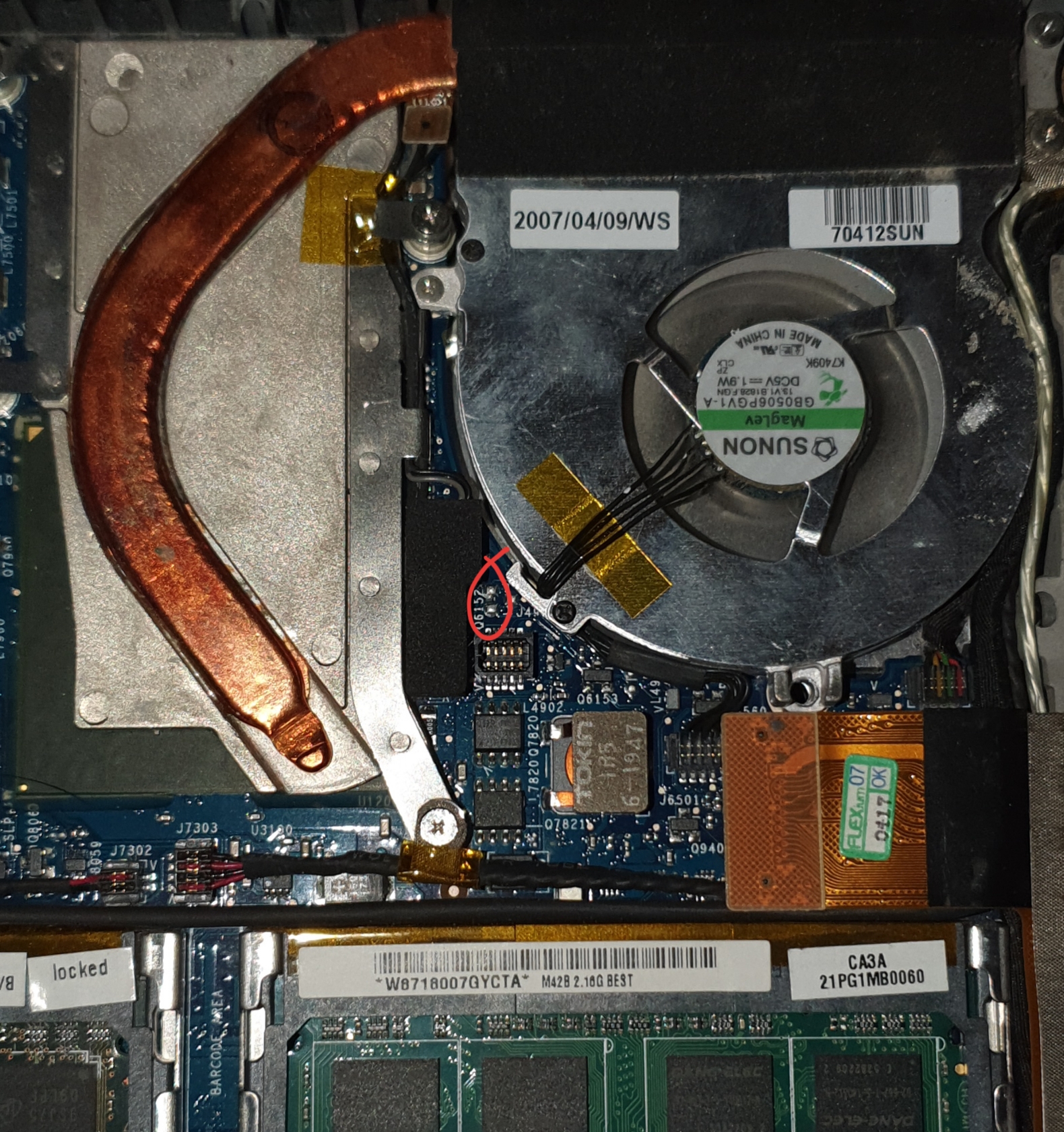

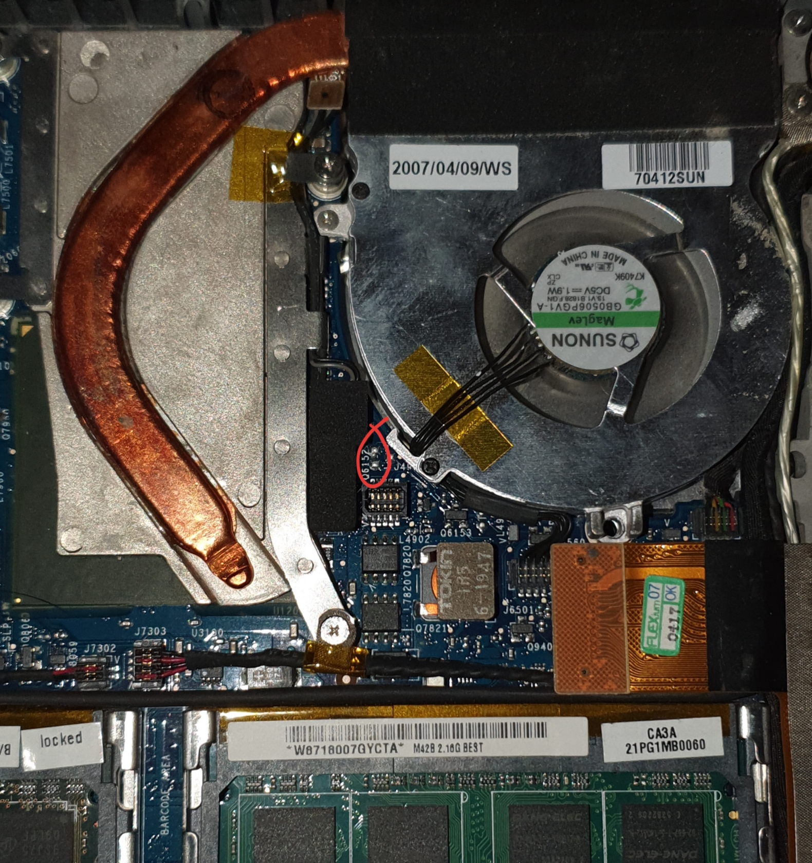

Just for reference this is where it is for me on my 2008 Black Penryl 2.4ghz Macbook

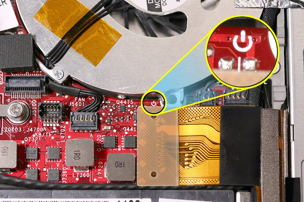

Your picture is NOT that of a 2008 2.4 GHz...
Heat sink is from a Mid-2007, and the sticker on the fan shows 2007, along with the sticker on the RAM slot shows a 2.16Ghz, making this picture of a logic board from a mid-2007 best model. Black, of course, but a 2.16 GHz, MacBook2,1. A 2.4 GHz would be a MacBook4,1.
I just looked inside my Early 2008 MacBook 2.4 GHz, . The power pads are the same location as the picture that I posted. If your logic board is the same as the picture that you posted, then it's not a 2.4, but is an older 2.16 GHz.

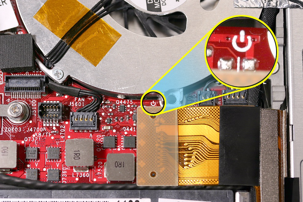

My picture is from Apple's service manual. It shows a pre-production, red logic board. Mine is not red, has slightly different components, but the power pads location is exactly the same on my 2.4 GHz
DeltaMac is also right. I own multiple MacBooks and there is a difference between the A1181 2007 vs the 2008.
The LB also looks different. Heat sink looks different.
