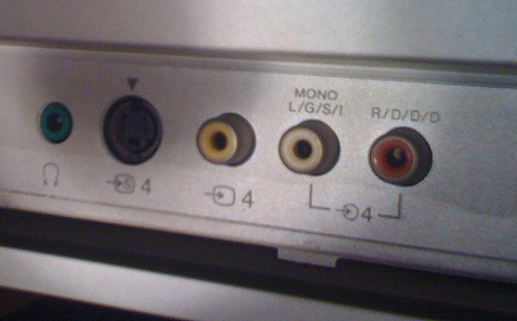

Hi,
I've just bought a Mac Mini (late 2009) to use as a media centre (Boxee) and need to connect it to my girlfriends Sony CRT TV.
Having read this thread and other sites, I *think* this is the same RCA to VGA converter box but on eBay (UK):
http://cgi.ebay.co.uk/S-Video-BNC-R...elessVideoTransmitters_CA?hash=item3ef7cfc5b9
I think I need to buy these two cables as well?
http://cgi.ebay.co.uk/VGA-TO-TV-RCA...uting_CablesConnectors_RL?hash=item5637ed1e27 (VGA to s-video cable)
http://store.apple.com/uk/product/M9320G/A (Apple Mini DVI to VGA cable)
Not sure how I'm connecting audio yet. The TV has a headphone jack but that's audio out, not in? It has what look like phono connectors near the s-video input (picture attached).
Thanks,
Greg

Hi,
That looks like the opposite of what you want. From the description it looks like it takes VGA or S-Video input and has a VGA output. You want VGA in and S-Video/Composite out.
No. If it worked - great, but this for some some video card with built in S-Video. Not for a regular computer - forget about it.
Yes.
A regular audio to RCA cable "3.5mm Stereo Male to 2RCA Male".
Something like this:http://www.monoprice.com/products/p...=10218&cs_id=1021804&p_id=5596&seq=1&format=2
I've not bought any of the above equipment, I was waiting for a reply and it was a good thing I did!
So I need the Apple cable and a M-to-M s-video lead? (assuming the converter has a female s-video out). Not forgetting the audio RCA to cable.
I'll hunt around eBay for a suitable converter now.
